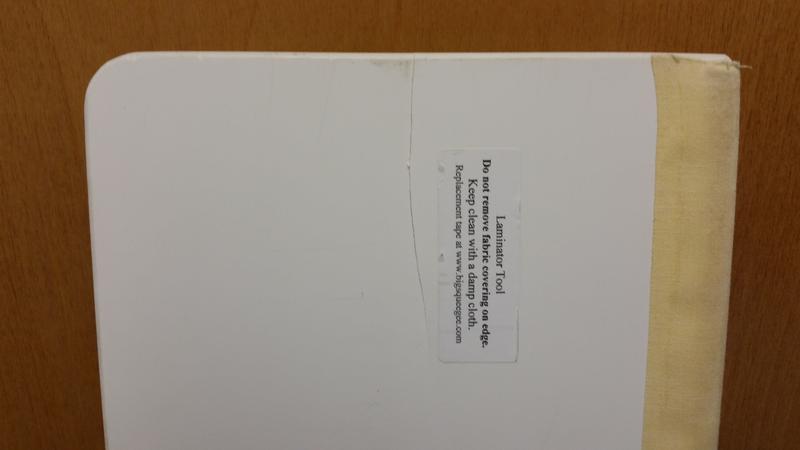

Dale (and anyone else who has relevant input), our 56" BS has developed a crack on one end.
Recommenced repair technique advice?

Look up a product called Q Bond....its like a super glue with super powers. Sprinkle some of the plastic repair powder across the crack, drip a few drops of the glue on it and in seconds its a rock solid repair. Used it a lot in the body shop business to repair bumper tabs and mounting tabs on headlights.
