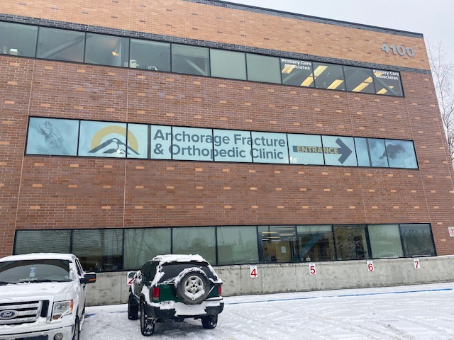

We've taken to second surface mesh for larger perf applications. We get them from Signs365 and install with Hem tape.
