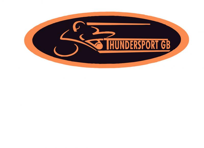

i have designed a decal and having trouble with it in flexi
when i seperate the colours its not seperating the colours i want it to do .
its 2 colours black and orage i want the orange as a background with black over the top with orage writting and logo in it but for some reason its seperating them all wrong way around its seperating them and sending me mental anyone willing to take a look please

trying to up pic
has it appeared ?

You refer to this as a bitmap. Is it a bitmap or is it a vector?
If it's a vector, set it up so that everything other than the outside path is black. Next select all and then click Arrange Menu > Path Direction > Automatic.
This will cause the black inner shapes to become holes allowing the orange to show through. If the layer order is off, select just the orange layer and send it to the back by entering Shift + Page Down.
If it's a bitmap then you will need to combine it into one in an image editor such as Photoshop, flatten any layers and save in your preferred format such as TIF or JPG. You can then open this in Flexi for printing. Because it is not vectors it cannot be used as is for cutting vinyl.
