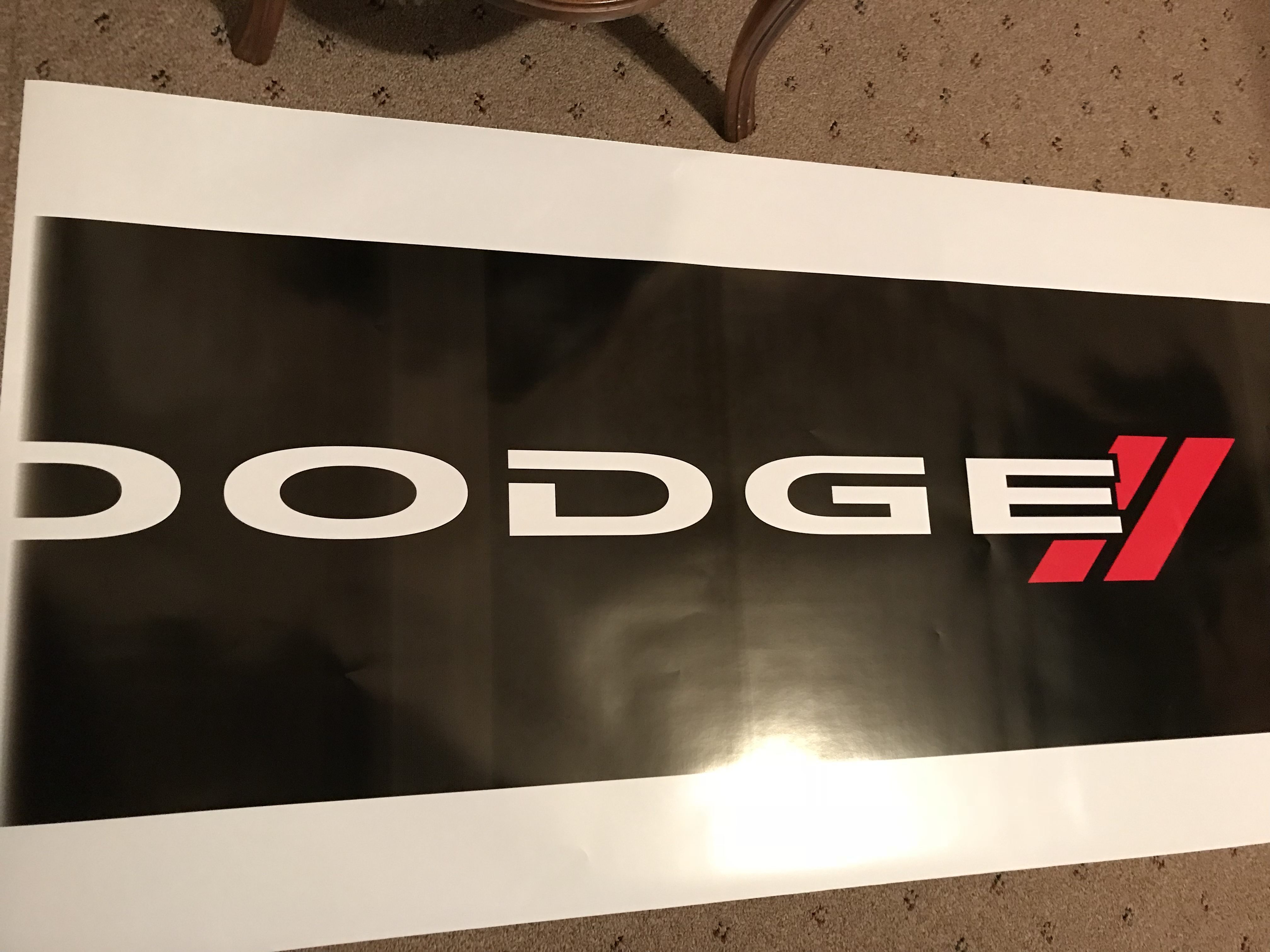

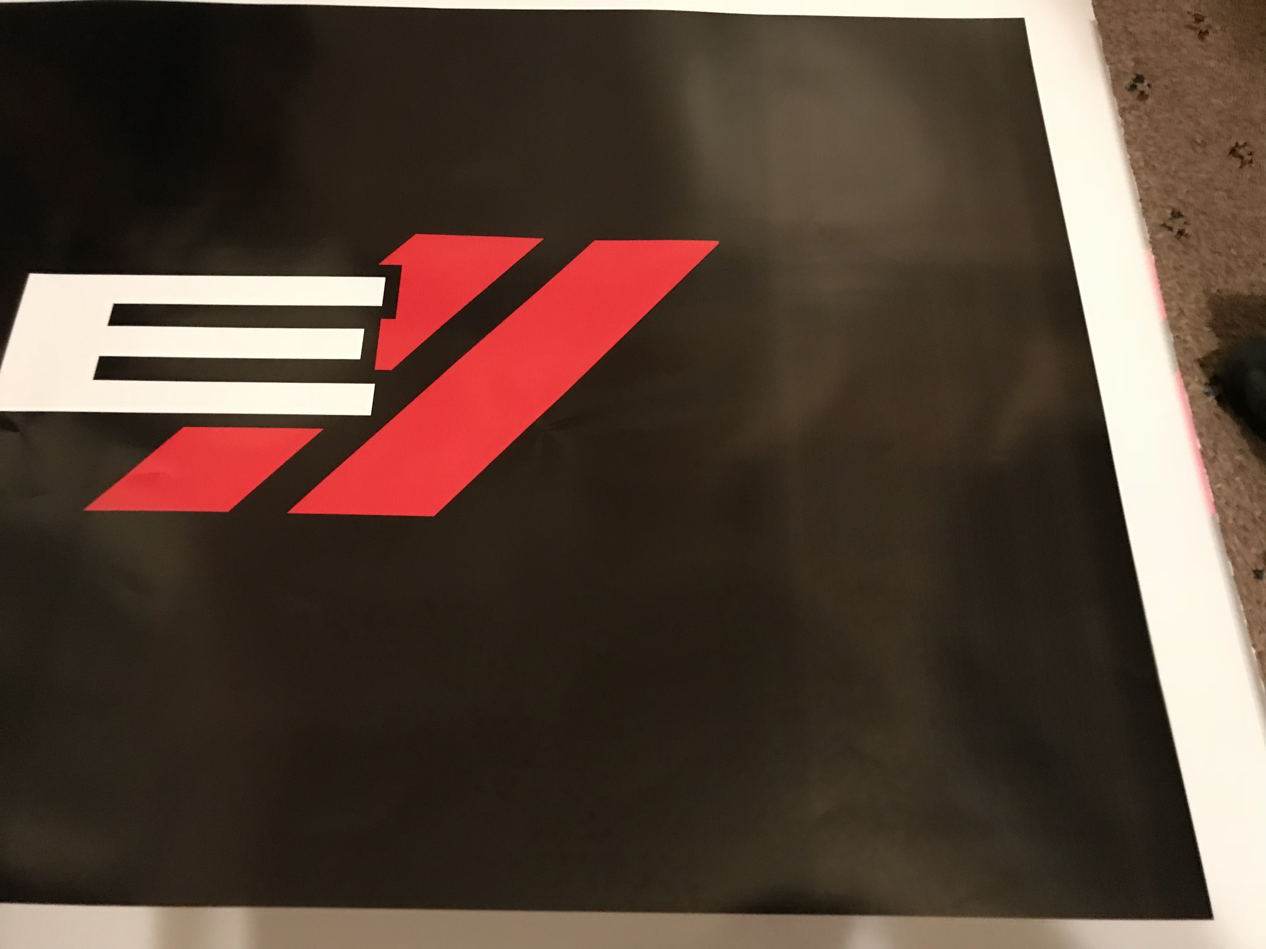

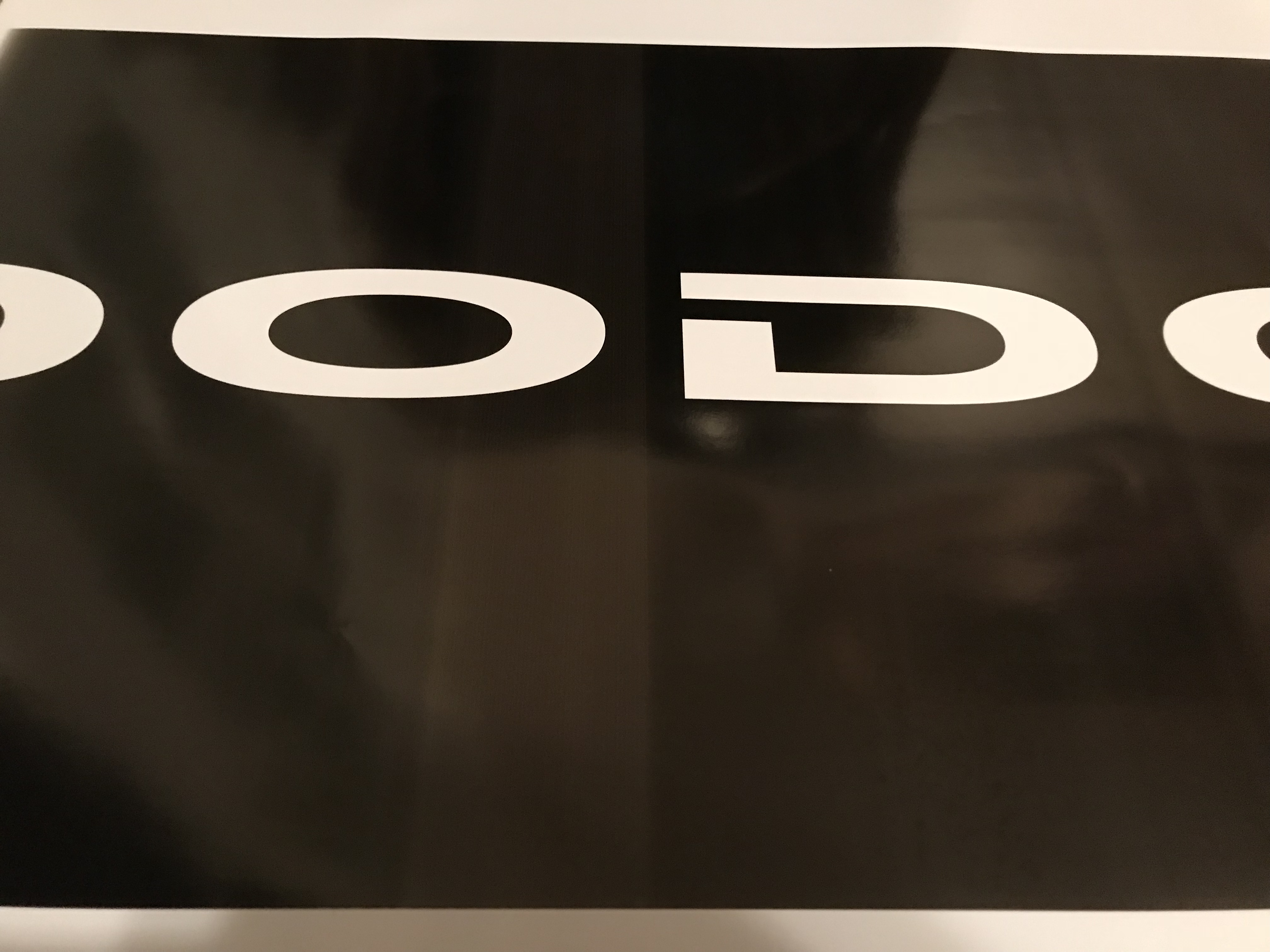

If black ink is slightly dropping out while printing but the test patterns are perfect would you say it is because of the dampers? How often should I change Roland VP-540 dampers? I just replaced the Wipers and Caps are all new.
Here is the pictures of an image I printed in versaworks with Roland Color Library converted to Spot Colors.
The black ink is slightly dropping out while printing.
graphicsphere
Custom Signs & Graphics
See pictures attached.

I dont print as much as a fulltime shop would but I change the dampners on my xc540 about every 6 months to be safe.
I would think if your test print is fine its either a dampner or a pump on its way out. But I am FAR from a expert.
