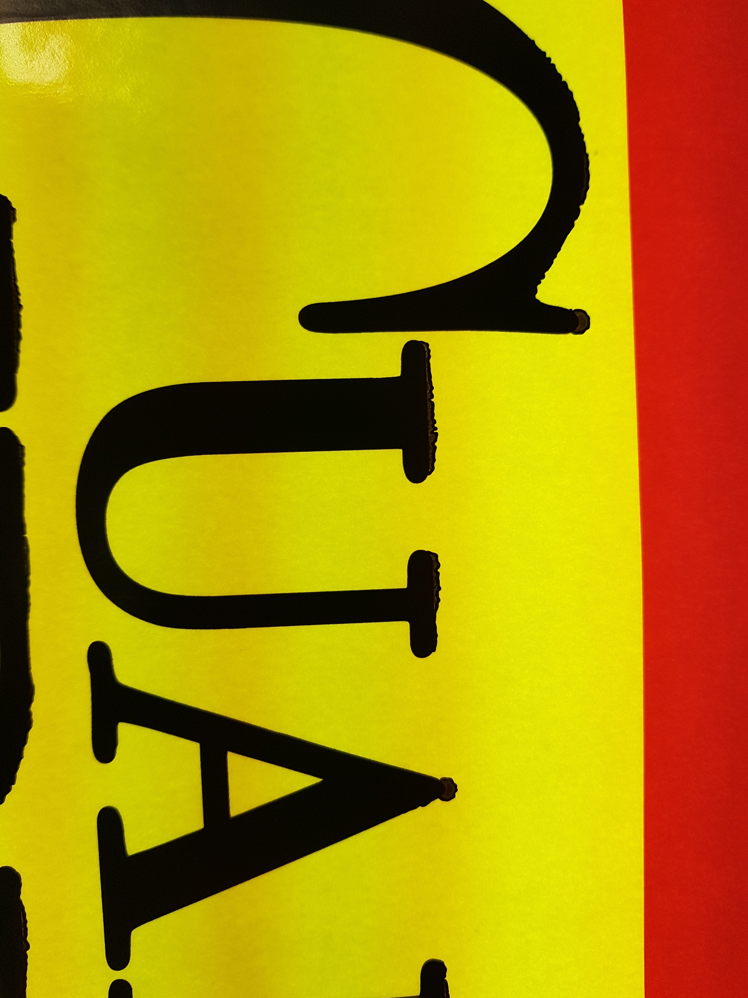

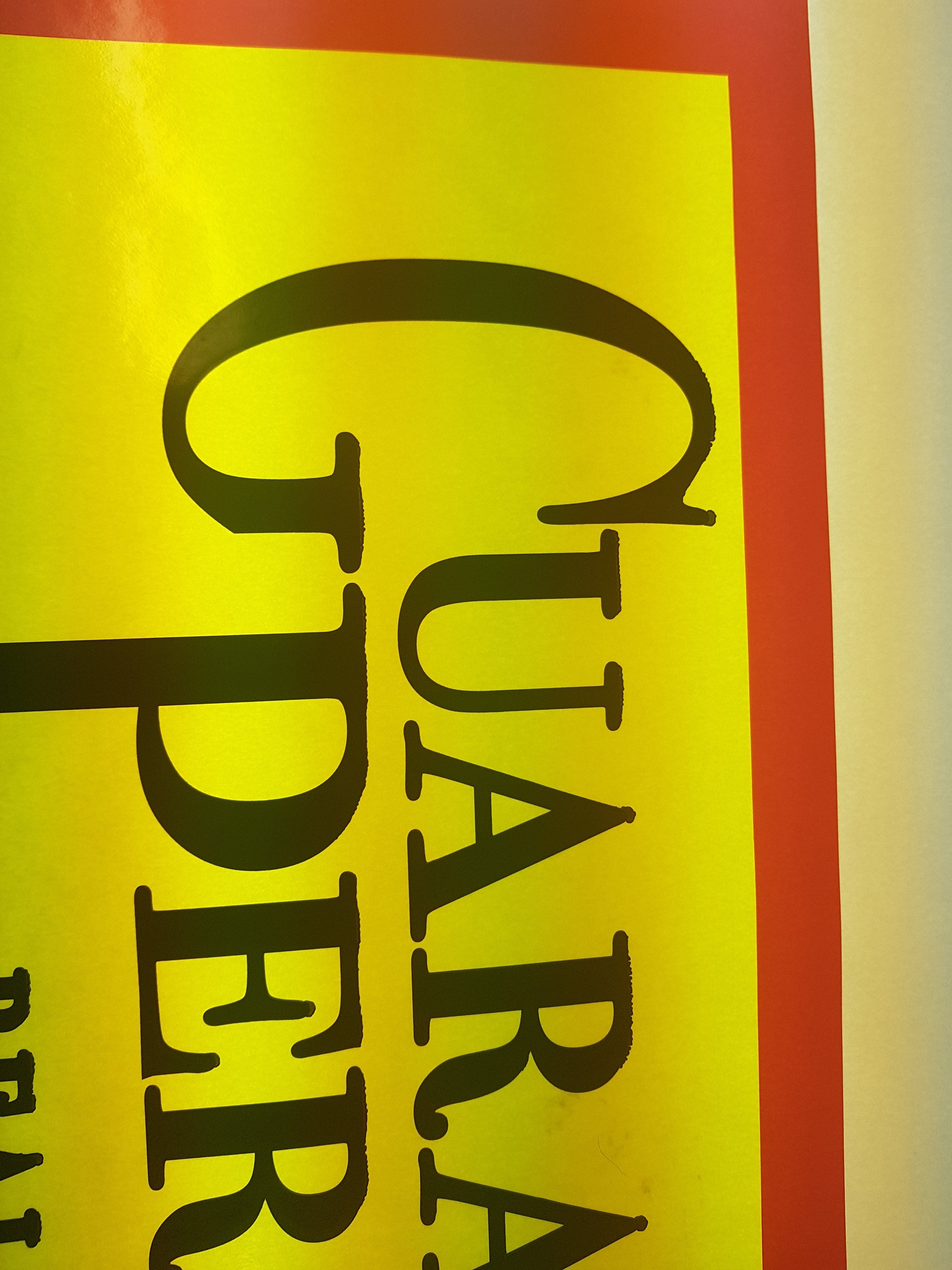

i am printing a backlit vinyl print with my HP latex 110 printer.
Printing onto GF231 overlaminate.
I have attached photos of the print. the starting edge of the BLACK only is fuzzy / bleeding out.
I have my onyx rip settings set at Saturation Boost.
I increased my saturation to 100% so as to get a richer colours (not faded and washed look when backlit).
the 2 photos have a light behind.
I have done multiple test prints and every time I increase the BLACK in saturation by 20% it bleeds like this.
I want my black to be as opaque as possible.
why does (the black only) keep bleeding like this?
If I do not increase the saturation on the black, it always looks washed and faded.
I don't understand. I am only increasing the black saturation by 20% (which incidentally, gives me a good opaque look) but the only problem is the darn leading edges are fuzzed up!!

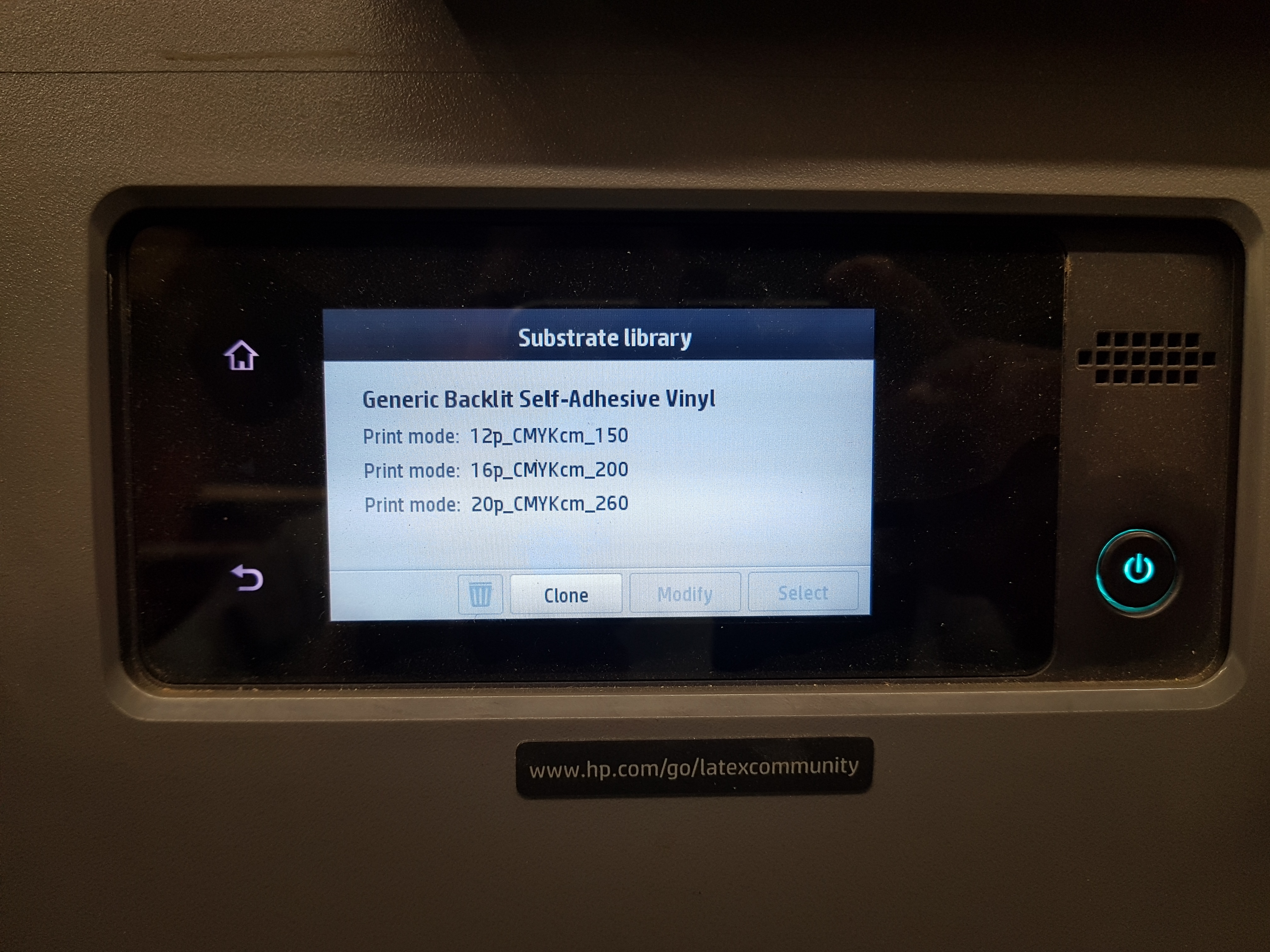

You have to go to the printer and go to substrate Library, Select the material and the print mode, hit the little Pen to edit and go to advanced settings (or something like that). There you have optimizer.
I would go up in steps of 2-4. Maybe 4 units first and 2 after that if you see no help.

I go into the Substrate Library, select the vinyl material and that is as far as I can go. There is no more options!!!!
Am I missing something?
dasigndr
this is all I get. can't go further. see photo
balstestrat
Problem Solver
Ah it's generic, you have to clone it first. Then you can hit Modify.
From the previous window you can check from the Online search if there is a ready made profile for your media already.

ok. I cloned it.
called it GF 231 and I was able to make adjustments as you stated above.
