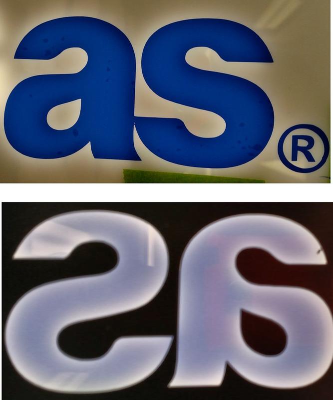

Our local communities have a dark skies ordinance and we are not allowed to have white glowing backgrounds on our illuminated signs. Normally we can reverse the colors and come up with a nice looking project but I have a corporation that needs (wants) the white background. I bought some blockout material that I thought would be the ticket, but I'm not happy with it. I was trying to use the blockout 1st surface and the translucent lettering 2nd, but it is extremely hard to line up and looks fuzzy. Should I be applying everything 2nd surface? Help please.

I think I'd put the blockout second surface and the lettering on top. Is this cut vinyl or a printed piece? We regularly do lit signs with the main print on the front and a clear layer of the same print on second surface. I'm not sure why you are getting fuzziness - a picture would help a lot.

Picture attached. The black backwards picture on the bottom is the first surface with blockout. The top picture there is a white halo around the lettering even though we put a 1/4" inside contour stroke for overlap. Fortunately I've only done a small test on this, the finished faces are 36x144". Should I use white blockout on the same surface as the blue translucent?

We've normally put the white blockout on the face of the sign. If the customer wants the letters to be a little more visible at night, we will sometimes leave a white translucent stroke around the letters. During the day the stroke isn't even visible, but at night it helps make some colors more legible.
