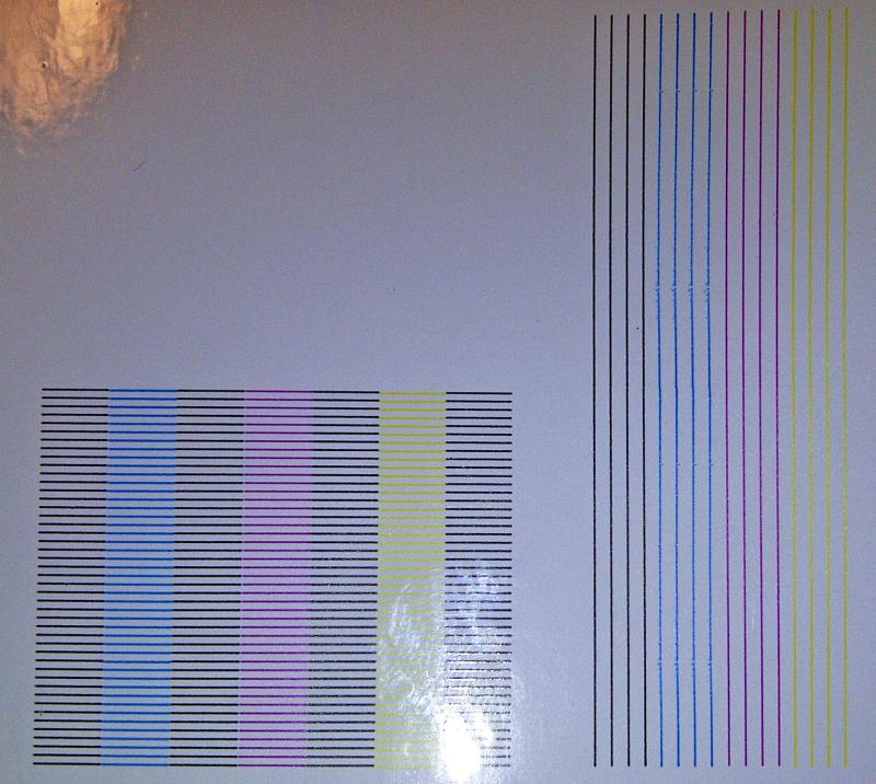

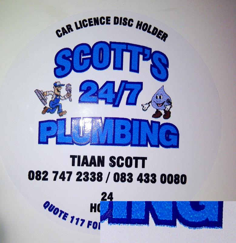

Back with this issue, it looks like the blue is being placed incorrectly, almost like when a litho press's registration is off. I have done cleans, destatictized, reset, anything I can think of however cant get it right.
Its not the artwork either, as we have used the exact same file before with comlete crispness and high quality. And have tested other files.
When you do a test print from the machines cleaning menu, all of the lines are printed and crisp and neat which leaves me very confused.
Any advice on how to correct these issues?
Attached are images to get an idea of what the issue looks like.
Thanks in advanced.

I think that you may need a head adjustment. The Vertical adjustment on your Cyan head looks like it may be off quite a bit. You can't know for sure without running a Bias/Vertical head alignment print test, but I'm thinking that's what it is.
That's a minor service adjustment. Your local dealer can help with an onsite maintenance service.

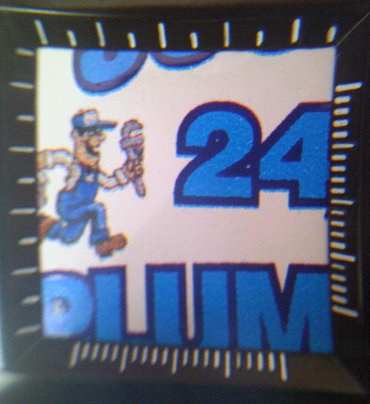

Just as I suspected, your cyan vertical adjustment is off one half row. It's pretty clear.
Stop messing with the linear encoder strip. You simply need a small vertical adjustment to your cyan head. Otherwise it looks good.

how about a test print? for me, it feels like an overspray/deflection/electrical problem on the cyan..
