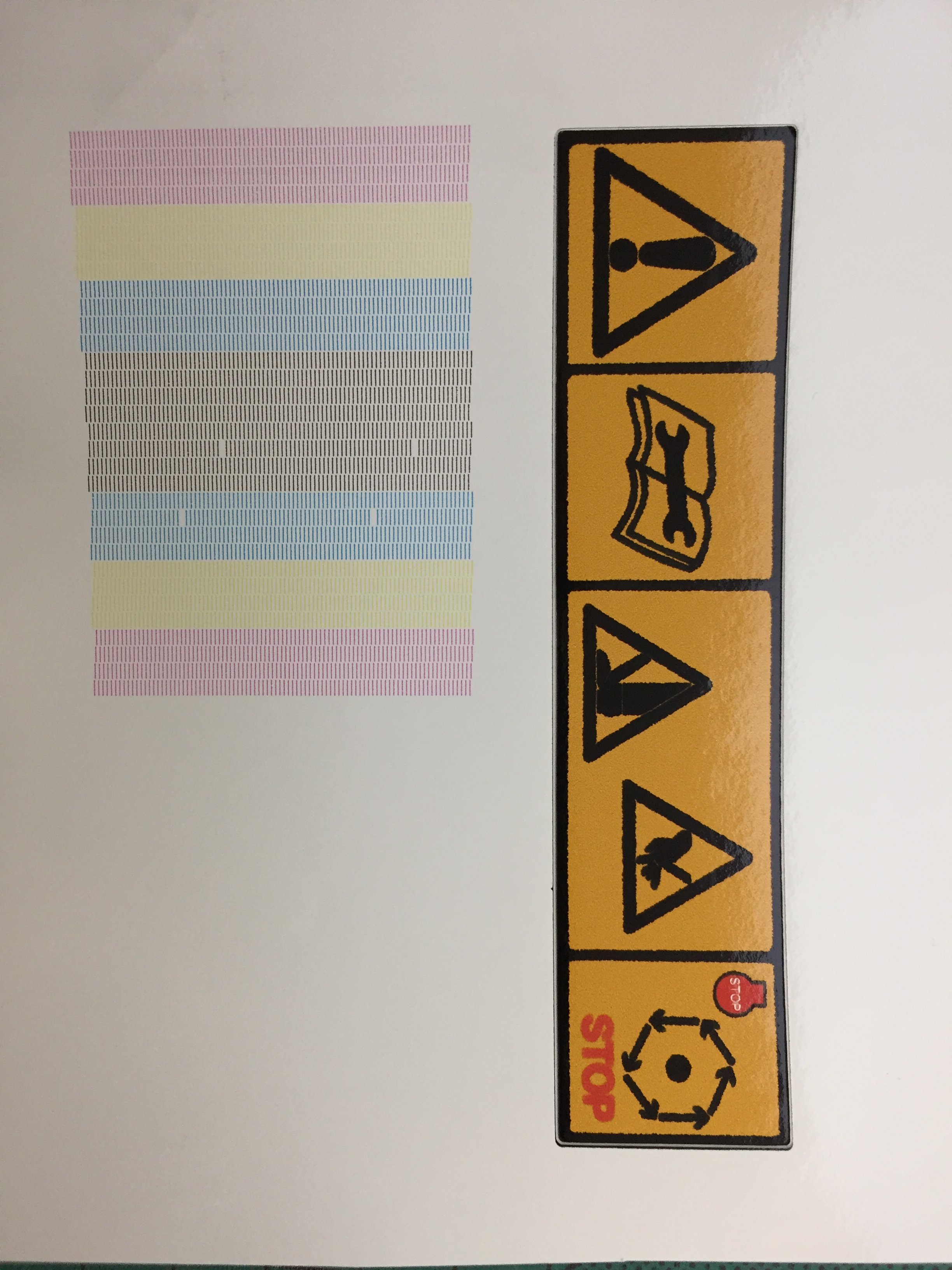

Thank you for looking and replying to my problem. I have up'd the heat and our printing looks better as the colours look more fluid. But it doesn't seem to have made much difference when printing yellow and black together. I did also notice when there was yellow with blue the yellow edge was abit fuzzy. I will try knocking the yellow back and see if that makes any difference. Meanwhile this is a picture with more heat. IMG_2281[1].JPG

Judging by the nozzle test, it looks like you're running a Roland.
In the Color Management section of VersaWorks, what preset do you have selected?
Try to select either Pre-press General or Pre-press US, which won't artificially boost colours and should reduce the ink levels and try a test print and see how it looks.
