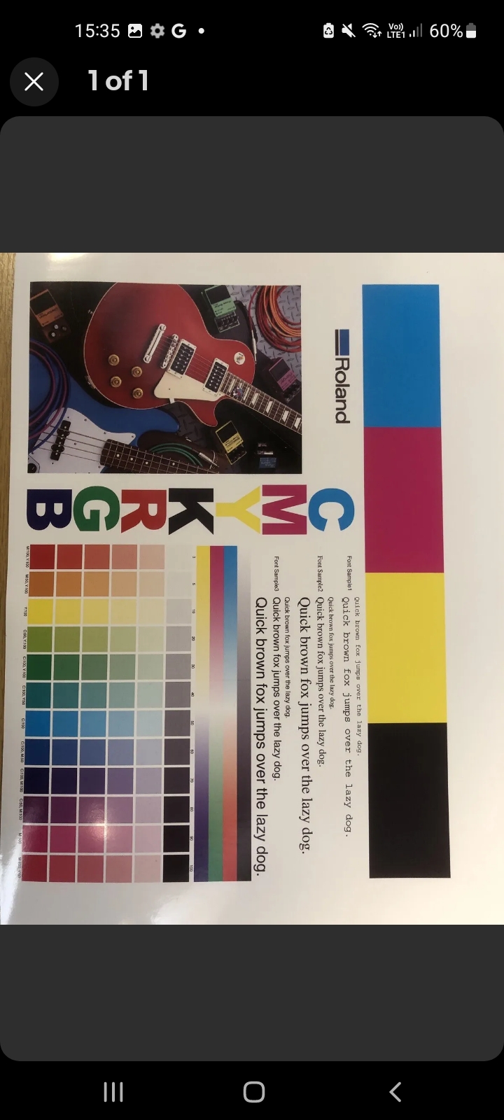

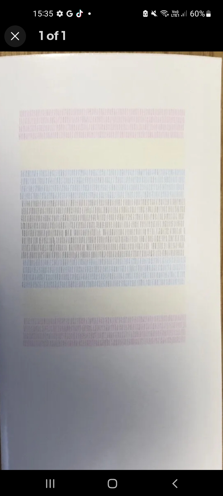

Hi
Would this require a new printhead?
The test is showing blockage? As there should not be gaps in the test print?
Please advise if this is fixable as unsure if I should go ahead with purchase for 2900.
Thanks

Check your ink first. Do you have fresh ink. For troubleshooting, use a fresh cartridge from Roland. The ink expires 2 years from the date on the cartridge. If that's good, make sure your cap top is fresh - if it's more than a year old replace it with a new OEM cap top. After that, it's probably the head.

Not a lot of success stories on here regarding used inkjets that start out with bad/dirty nozzles.

I have 3 wide format Rolands. That test print looks pretty good to me.
Print your own file and see how the print looks.

A new print head for that printer is going to run at least $2500 USD installed (not sure about over there) but by the time you get fresh ink, if needed and the cap top and wiper you could have paid for 1/2 of a New BN20a. You'll still have an old printer with other old parts that will need to be replaced at some point - all on your dime. If you buy a new one you at least get a printer that you know works and won't have to pay for any repairs for at least a year. Generally the value of a used printer is about half the price of the comparable model new - just rough numbers I use to evaluate in situations like this. Check ebay for more accurate values, but it generally holds up.
