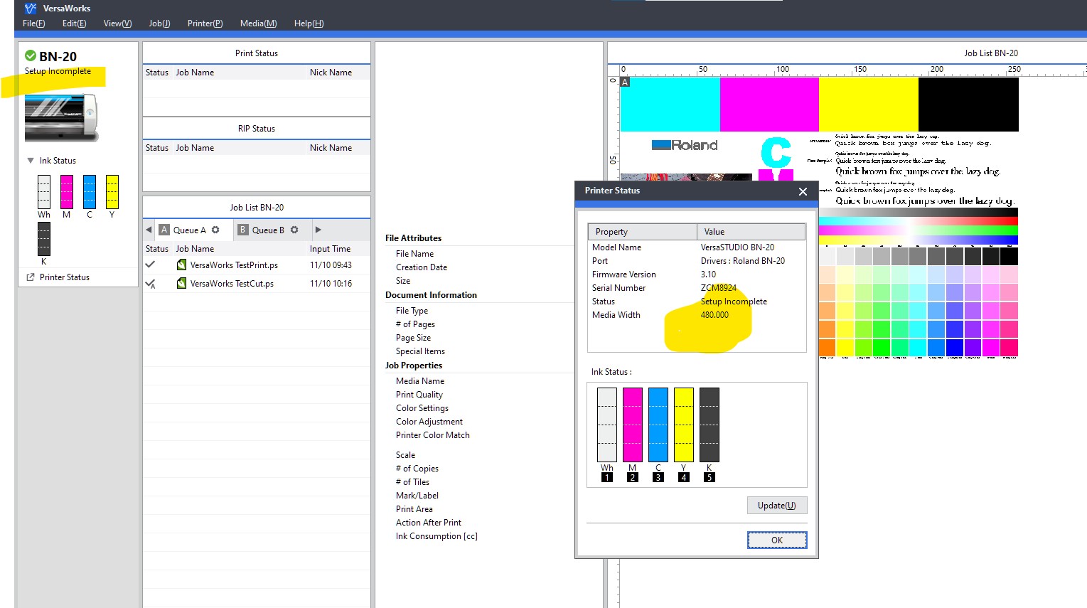

Basically i know the mdeia is loaded correctly and ive move the pich rollers around always on the gritty bit

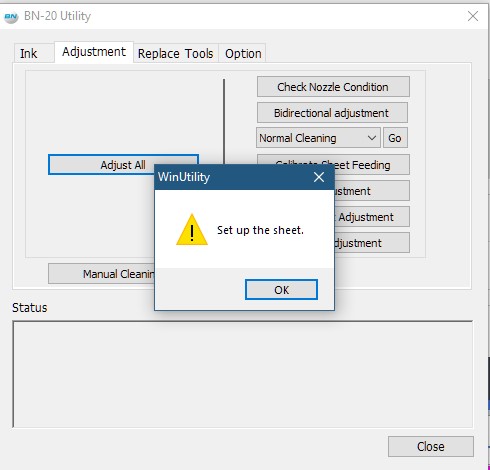

But on Versaworks always saying: setup incomplete
and Utility says: set up the sheet
Ive done that over and over and the lever forward etc with the roll covering both rear and front sensors!

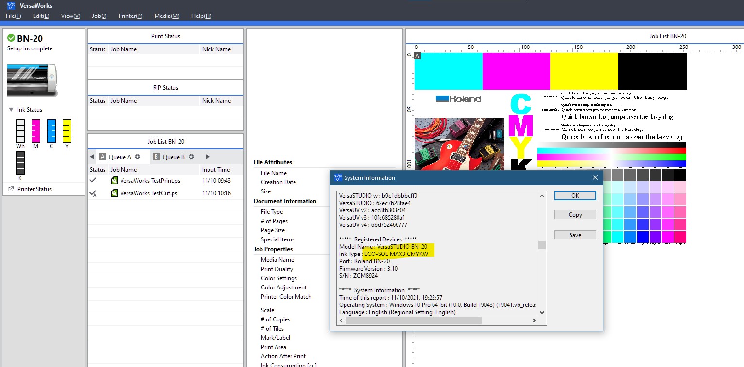

Im thinking it wont let me do this until i install the same inks that were in the machine previously?
I bough this used and didnt come with any inks in it
I seen on Versworks it said that it was using eco-sol max 3 inks with white!
Was this the last set up used? or is that a default setting saying eco-sol max 3 ?

IM thinking that before this system used ECO-SOL MAX 3 INKS With a white cart
And ive installed ECO-SOL MAX Inks with a Metalic cart! coisting me £500 or $700 or thereabouts!
And because the inks are different? its causing me these issues?
I have not even seen the head move from right to left yet, let alone print or cut!
The price of inks im going to have to buy eco-sol max 3 inks with white one just to rule all these issues out?

Hopefully not a bad print head, but you should be able to change the inks for the menu, if it wasn't allowing the inks, you would get a different message, saying put in proper inks. When you pull down the lever, does it do anything? As the head or cut carriage should go across to check to make sure the pinch rollers are in the correct locations. If it doesn't do anything, it would mean it's no sensing that you lock in the media. I know this is probably something you've already done, but did you click okay on that pop-up message in the utility?
adamfromayr
Thanks for replying, Yes i did click okay etc
The carriage doesnt move at all!
I wonder whats up with it!
Blue LED Steady
Lever forward, media under all the pinch rollers and over the front and rear sensors!
The carriage i think moved a few days ago but not 100% sure but its just sitting doing nothing!

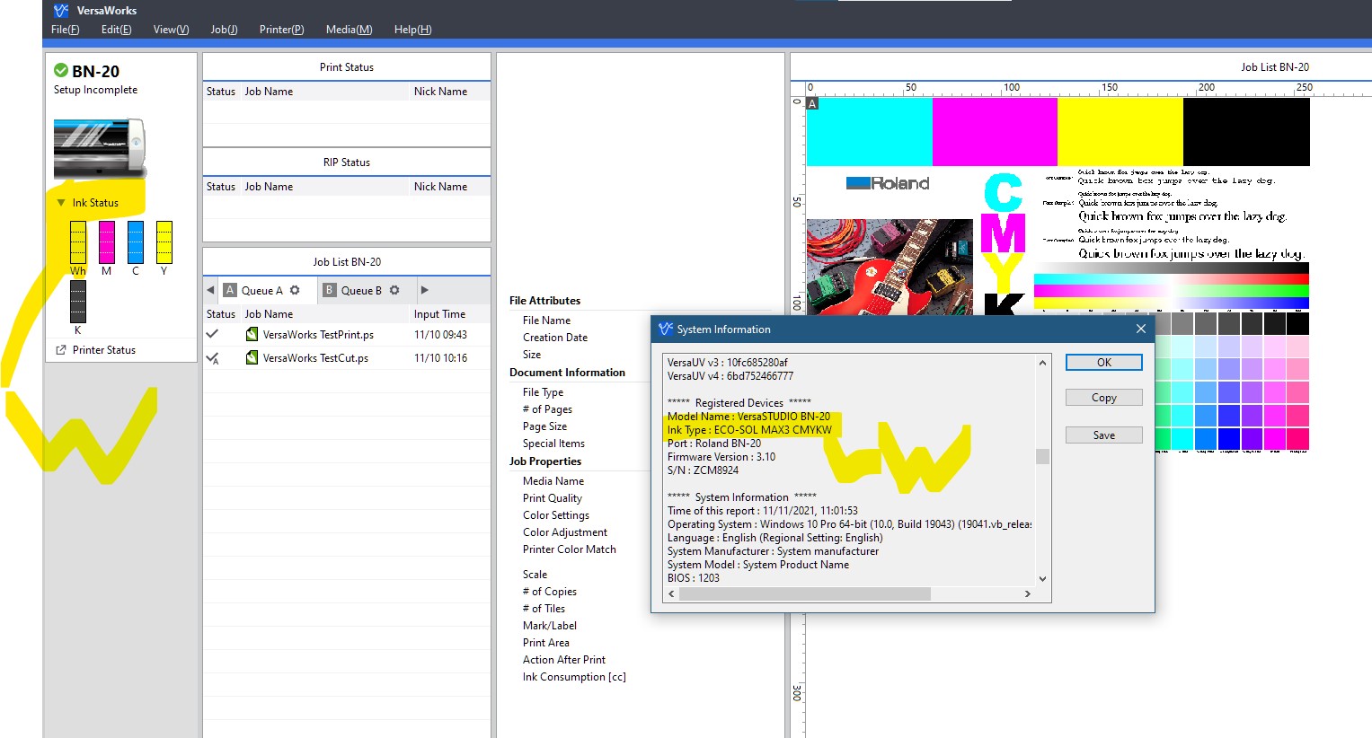

Ive been told by Digisupplies that for starters basically my machine is set up to use ECO-SOL MAX 3 Inks and a WHITE! I have had installed 4 x ECO-SOL MAX Inks with a METALLIC, So i think a good place to start? Will be to order the ECO-SOL MAX 3 Inks with a WHITE? AS Verscam software says thats whats to be installed
Im thinking because im using the wrong inks? that this is whats causing the issues? And if isnt the reason im sure getting the MAX 3 inks will do more good than harm, also they will be 220cc ones not the 440cc ones i just installed!
See i bough this from a big business auctioneer and had no inks in it so just thought the eco sol max inks were right!
The pinch rollers are 100% correct, did like 20+ times! so i know its not me!
My guess its the Inks? or a dodgy sensor?
