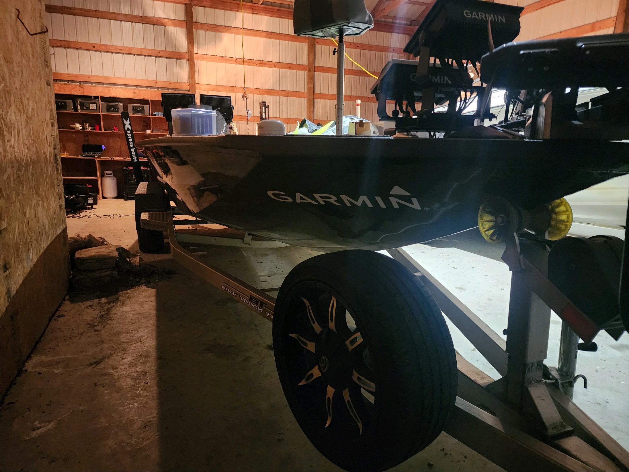

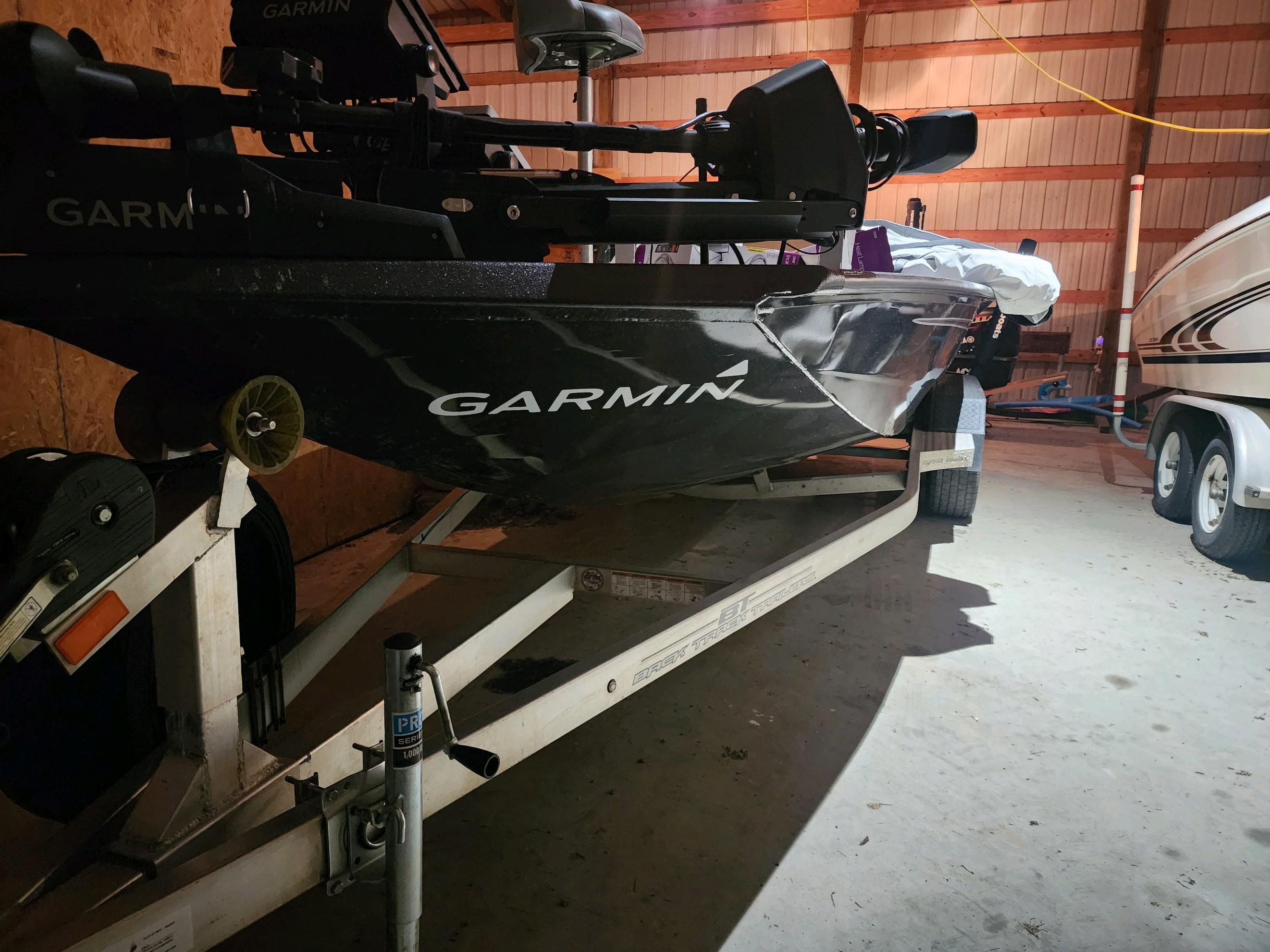

We are in design to wrap a Bass boat. The sides of the boat will be an easy enough wrap but while in design the customer asked for graphics to be put on the front of the boat. Other than smaller cut decals, I am a little concerned with wrapping the front because there is no defined edge to stop. What do you guys recommend? Images are attached for reference.

Keep in mind when you design ,as per 3M vinyl is to stop 2 inches above the static waterline. At least for warranty.
