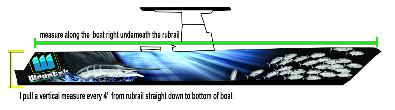

Check this out. I usually pull vertical measurements every 4 feet depending on the bow flare. If there is a big bow flare i will pull vertical measurements every 2 feet. Hope this helps.
