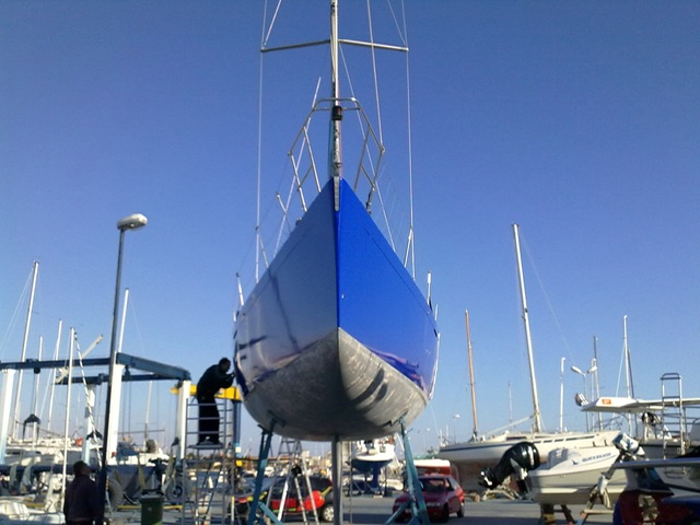

I wrapped sailboat in Croatia (read: extreme UV, no moisture in air half of the year). Lasted five years looking good, six more changed color to black (physically burned)… We used MacTac at the time. If you apply it well (correctly) and finishing is done meticulously you should not have the problem. Note, do not use latex printer for this, as lamination will “float” on the surface (at leas on 3xx series and earlier).
