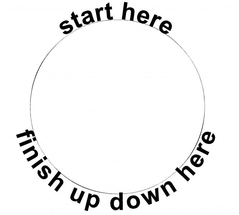

i am having a major brain **** on how to make circular text in my VE LXi expert program.
needing it to go on top of the circle and then face up on the bottom of the circle.

you have to use the "arc" text tool....not the "path" one.
With the arc tool, you then hit the "enter" (like starting another sentence), to move to the bottom.
Like this?
shonda
woohoo! thank ya Jesus! when i hovered nothing showed up....right clicked and a column came up and the "text create" was not checked. THANK YOU!
