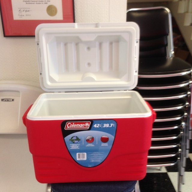

Hi all,
looking for some tips on branding a cooler.
Customer will be giving them away so they want it to look good but not cost an arm & leg. I don't know the count yet but at least a few dozen.
Seems like a stencil and paint might be the best bet but I'm worried it will have the pro level look equal to using a Sharpie to mark your kids underwear before sending them off to camp.
I was thinking to replace or decal over the existing decal on the front but it is designed to be easily peeled off and underneath is a recessed area with the embossed Colman logo.
They already have the coolers so getting them marked before shipping them here is out.
Any ideas out there from someone who has done this before?
thanks
