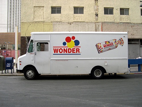

Getting ready to wrap one off these. What's the best way to print? I'm assuming horizontally? Should I try to go above and below the big piece going down the middle and then print a piece separate for that piece?
Any suggestions so are greatly appreciated, thanks!

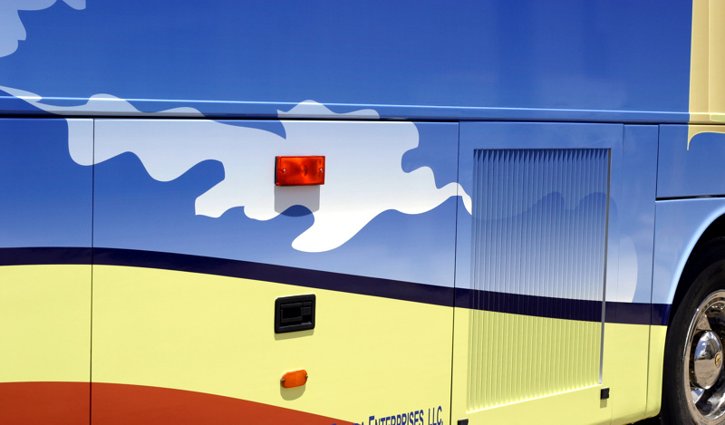

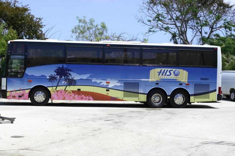

Colorado,
if you were doing just the top above the bar would you break it down into multiple 52/54" panels or do the whole thing in one shot?
We normally do vertical panels on all the busses but we did a 42ft Vanhool with 2 long panels on each side.
The break ran all the way down the side of bus at the top of the cargo doors. Seemed much easier than multiple seams every 52 inches.
Seems like a similar setup with the bread truck
I'm not trying to be a smartass, asking because you guys do way more wraps than most on here.

Wayne, can you provide a close-up photo of the seam between the top and bottom panels?
