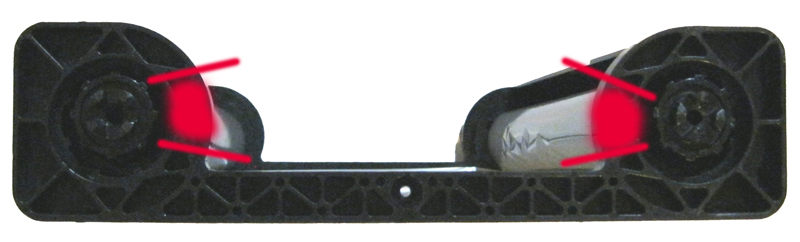

The main thing is not to cut the cartridge with a saw or any device that would create dust or you might contaminate the foil.
My recommendation would be to use a pair of pruning shears to cut a slot in the retainer at the end that the end caps come through (see attached photo). It should be large enough to pop the foil and the cores through and only needs to be done on one end of the cartridge.
artofacks1
Thanks Fred! I was going to use a saw glad I posted and asked. Took me like 5 minutes to break it out and change out the wheels on the side.
