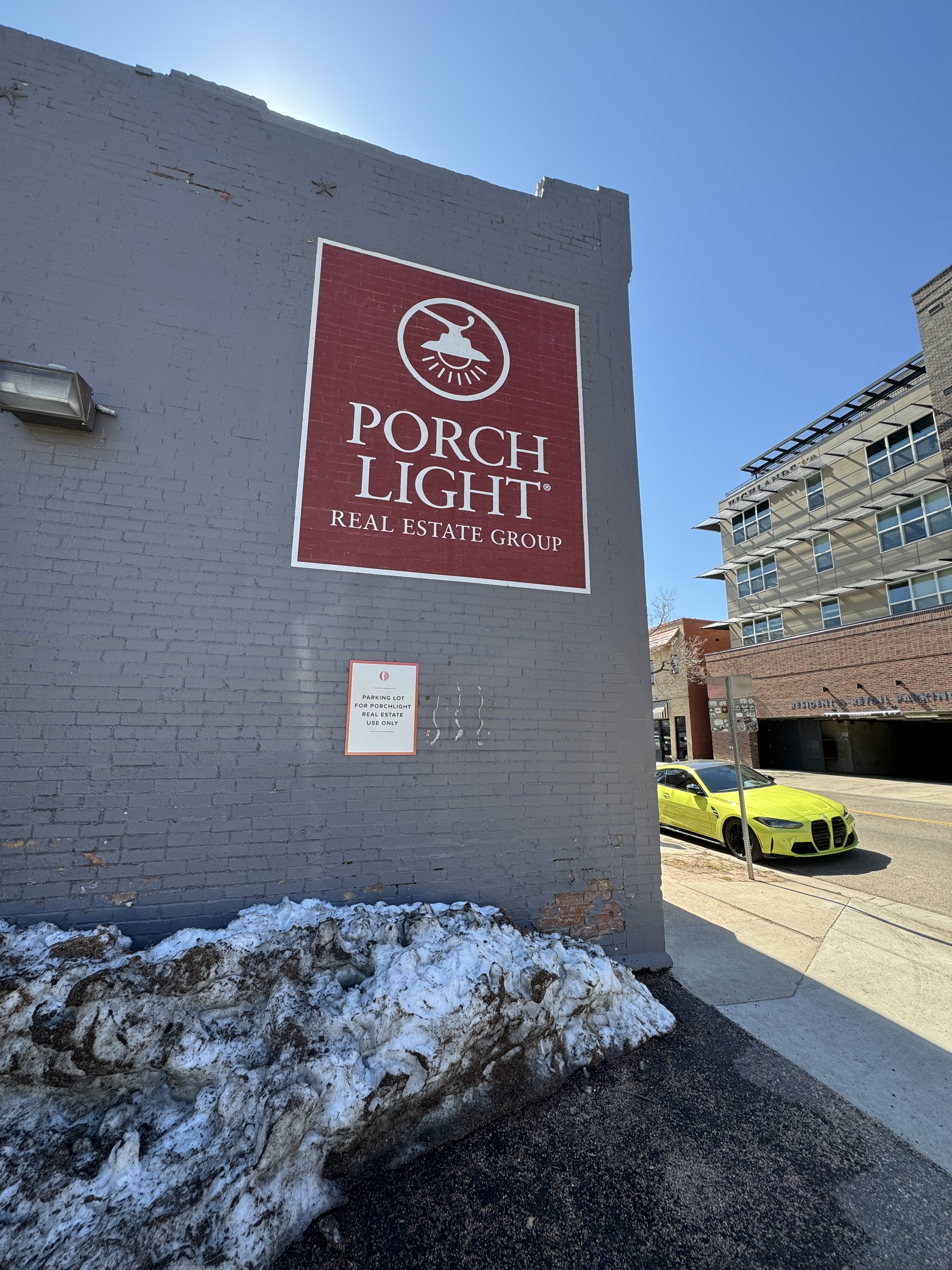

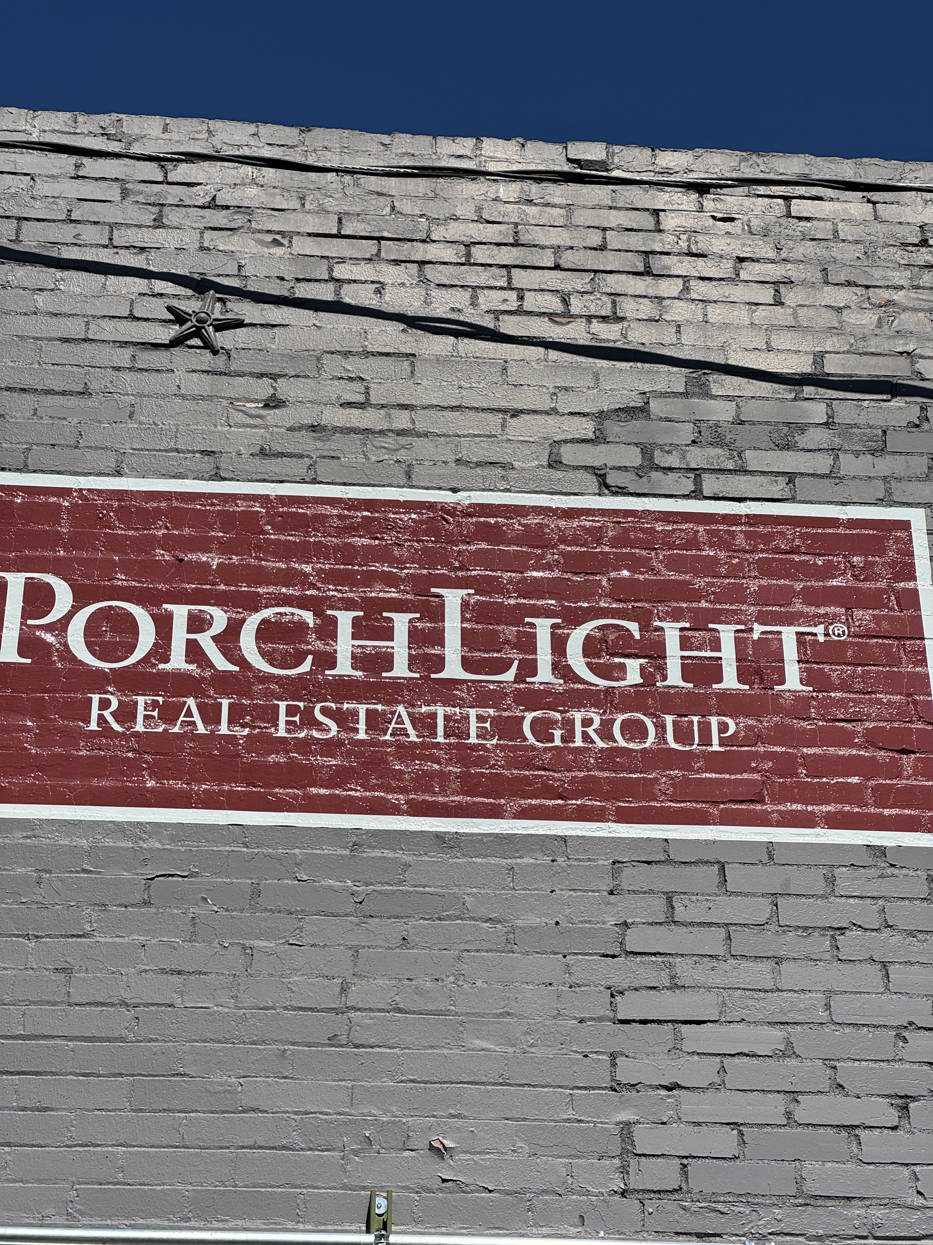

Has anyone installed or removed brick vinyl? We've done interior brick vinyl installs with ease but this will be outdoor and will require a lift and the removal of the previous vinyl.
They don't want to keep the sign down for too long, but I am trying to encourage them to paint the wall after the removal so we can have better adhesion.
We were thinking of charging about $25/sqft for end to end service including the removal and install.
Are we in the ballpark or way off?

removing regular vinyl is horrible i can only imagine how much elbow grease it will take to remove brick vinyl.

I picked at this stuff and it seemed to come off relatively easily. But I didn't try a large amount. have you removed brick vinyl or just thinking how it would go?
petepaz
no i have never removed brick vinyl, maybe you will get lucky.
if it is coming off easy when you pick at it try a pressure washer. if you can get one that heats the water that would be best

I have installed and removed brick vinyl. Usually all you need is a torch to warm up the vinyl and it lifts off pretty easy.
