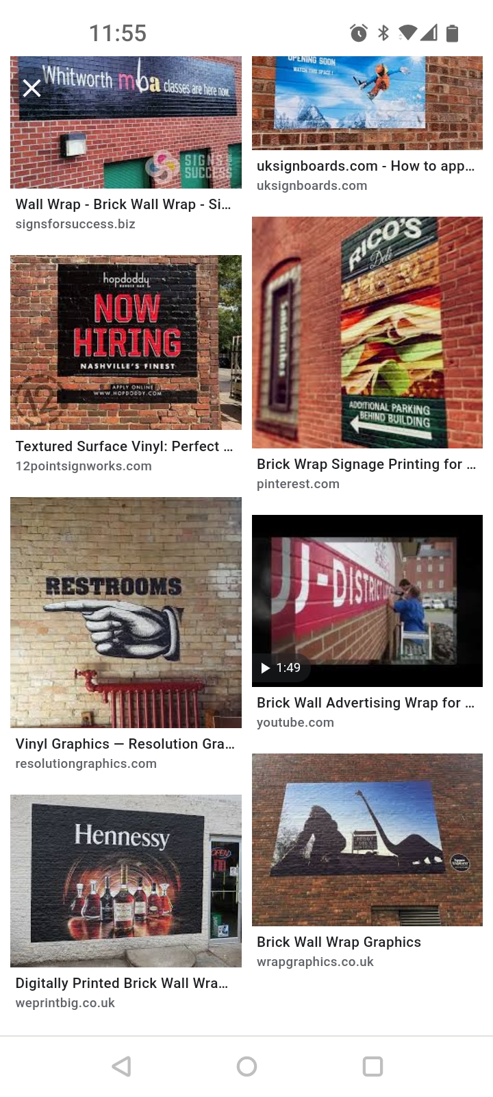

I'd like to see an example of vinyl applied to a brick wall. Are the spaces between the bricks just left as open cavities?

Very easy to find with Google.
The vinyl is applied with heat and forms to fit the textured surface, including the mortar lines.

Well I'll be! I do pay attention to signage, but I honestly do not believe I have ever seen that before. I would have thought that the vinyl would become horribly distorted trying to fill in the regions between the bricks, but apparently this stuff is heated? And Pushed into place? or ??? I always assumed those signs were hand painted onto the bricks! You learn something new every day.

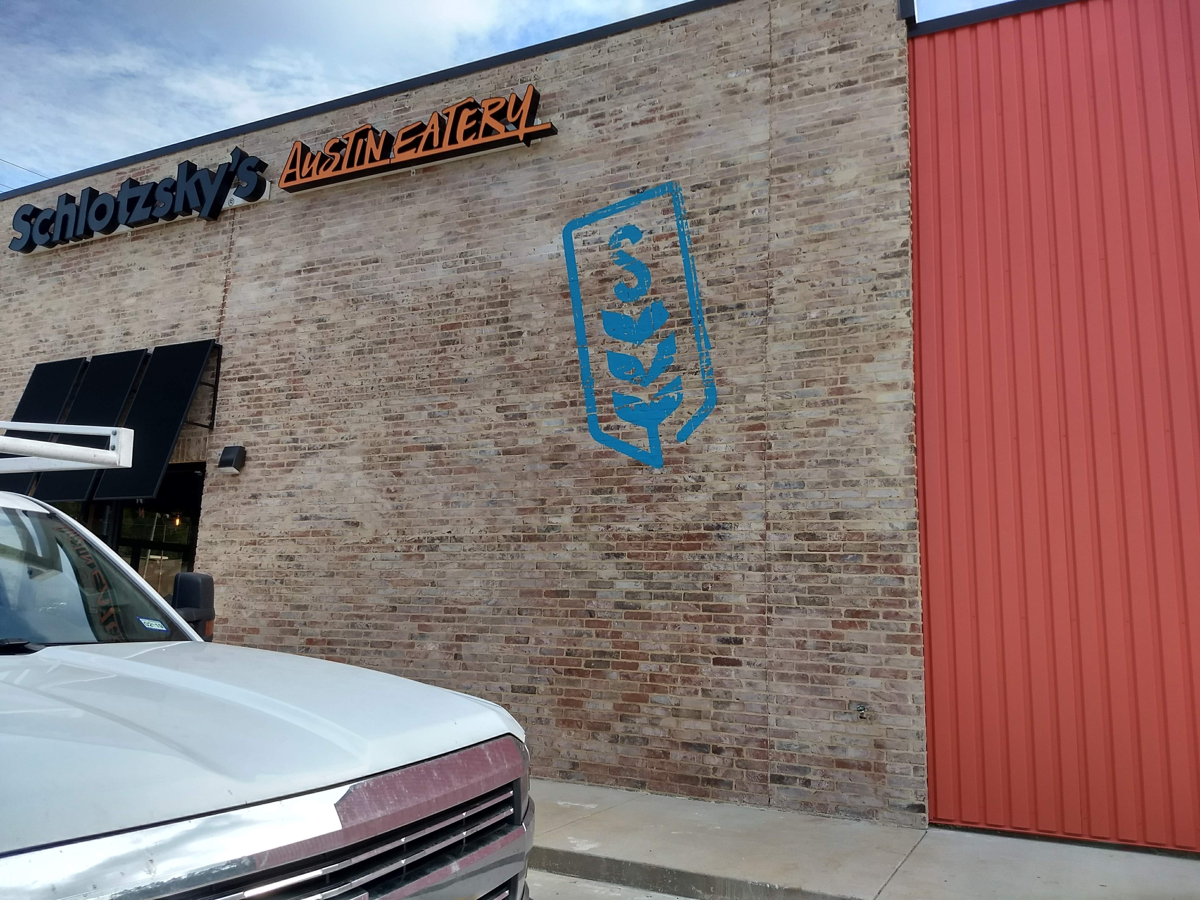

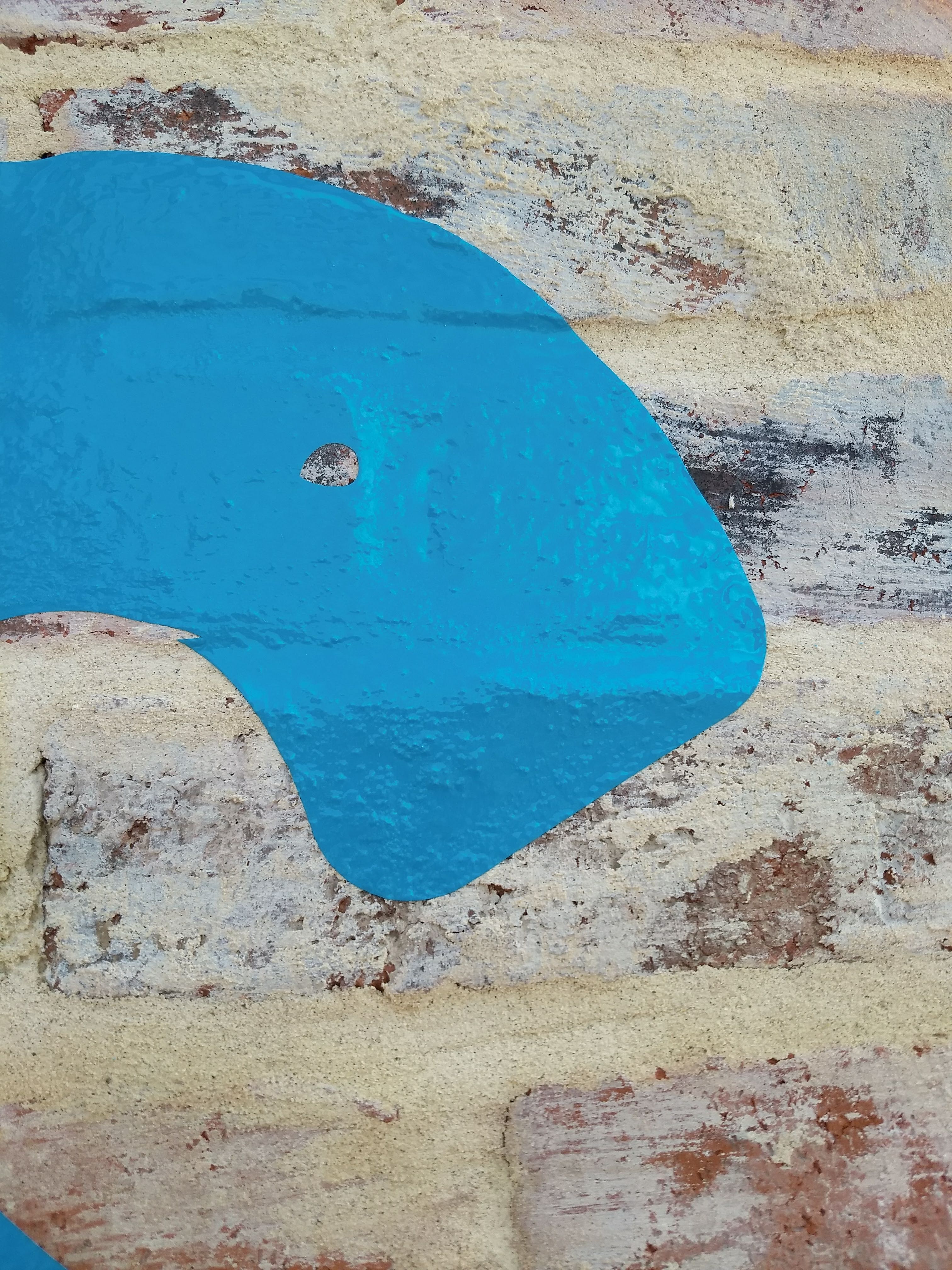

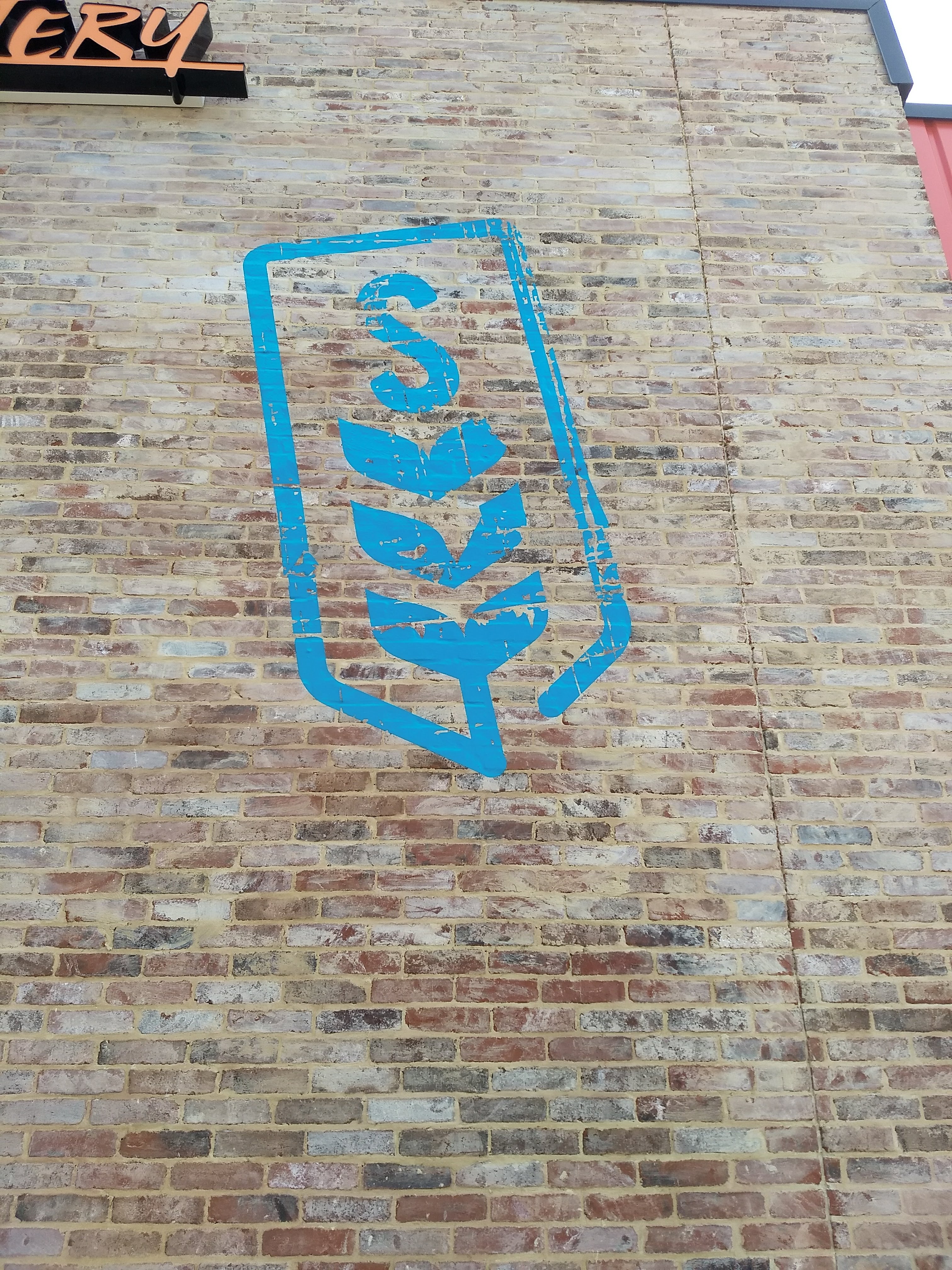

I did vinyl on some brick that had splatters on it. It was real rough. On advise of some people here, I pressure washed the brick and got the large splatters off, let it dry for a day and came back and applied. I heated the hell out of it. This was premasked cut printed vinyl... boy was that fun. I didn't think it was going to stick worth a shit but 4 years later it's still there.
