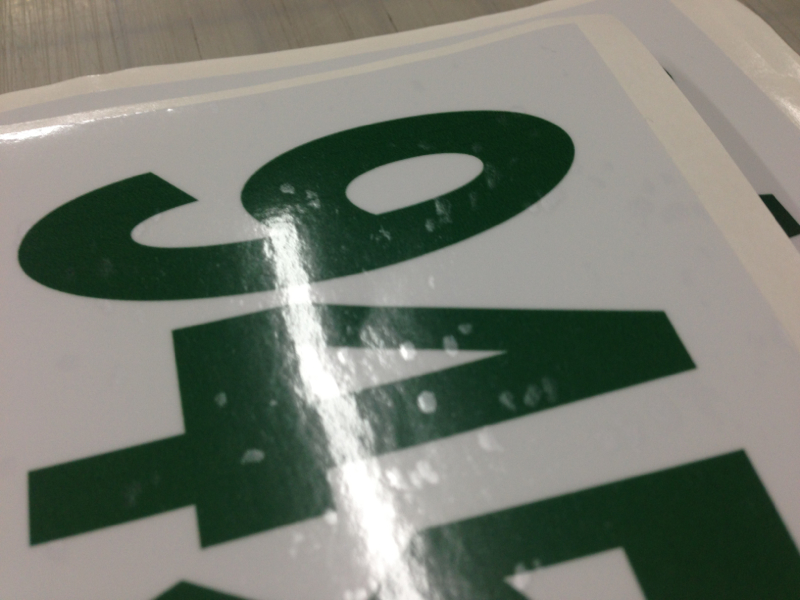

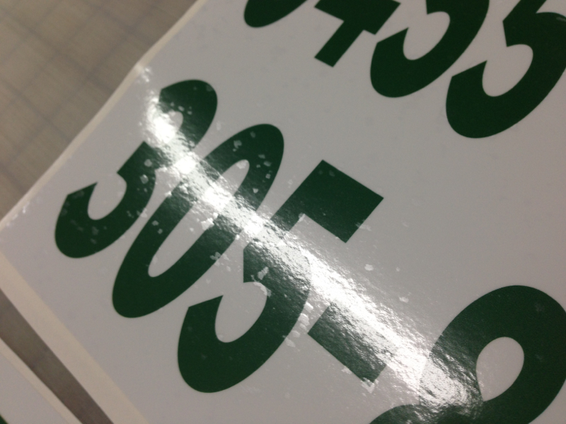

Got a roll of briteline lamination, gloss calander with uv protection... Used almost the whole roll, made 300 laminated signs. Waited a full day before laminating. And on some areas i got bubbles, wasnt the beginning of the roll, happened in different areas thru out. So have you guys seen this? Is it the briteline lam thats bad? I got 30 out if 300 that came out bad, about 50 sqft.

Have you contacted the distributor for assistance?
So the beginning of the roll showed no issues? Was the entire roll sent through the laminator at the same speed? Was heat assist involved?
Curious about the laminator, brand, make, model?
What printer/ink was used here?
Did the air bubbles show up immediately or after a few hours?

Havent contacted them yet, ss21 inks, the bubbles happened in batches yes, so i must have missed it while lamming, did a roll to roll set up, the rest are fine except two areas where they git bubbles, i still finished by trimming and cutting, and took out the bad ones, i just finished laminating and cutting the ones i printed yesterday to replace them. Came out perfect, i dont think it was me because it happened in random areas during lamination. Oh i got a 65in us tech la650 pro

Did the roll of lam lay on a flat surface? Or do you stand them on end? Is there a frequency to the bubbles?
ironchef
Stand up, us tech gets rebranded into many other brands. I noticed them when i layed it out on the table for trimming. It happened in like 3 areas, 2 of them being the larger areas, and it was random, as in there was good product in between.

Same thing used to happen to me when I used FDC films. Speaking of which, isn't Briteline a rebranded FDC film?

Been using this laminate for a few years, No issues and i lam right after printing with a big squeegee. Looks like a laminating error IMO

Never used the lam...but I would only use brightline vinyl on short term banners....That might be a clue to how I feel.

Never had a problem with the BriteLine stuff. It's General Formulations but recently switched to Avery rebranded.
Use it for short short term stuff, It shrinks a lot.
