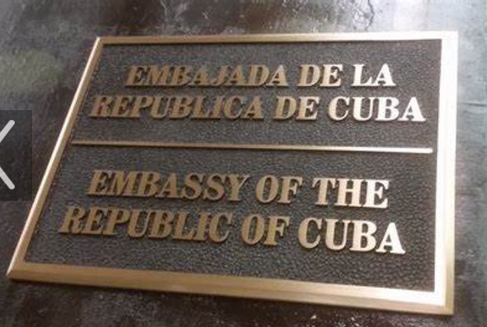

Any suggestions for try to print sublimation to match bronze sign colors? Example just off internet.
JBurton
Signtologist
PMS black 7C is a great shade of bronze, for reference, it's the same as 3m duranodic bronze, and Johnson/Rowmark charcoal grey material. We use it in matthews paint to match almost anything called 'bronze'. On my hp 560, a simple 90% black will produce a nearly perfect match at 20 passes.
bteifeld
Substratia Consulting,Printing,Ergosoft Reseller
Try L*a*b* 71 6 23.
This is based on using the photoshop eyedropper tool on your
image, taking from the middle of the C in the second Cuba.
