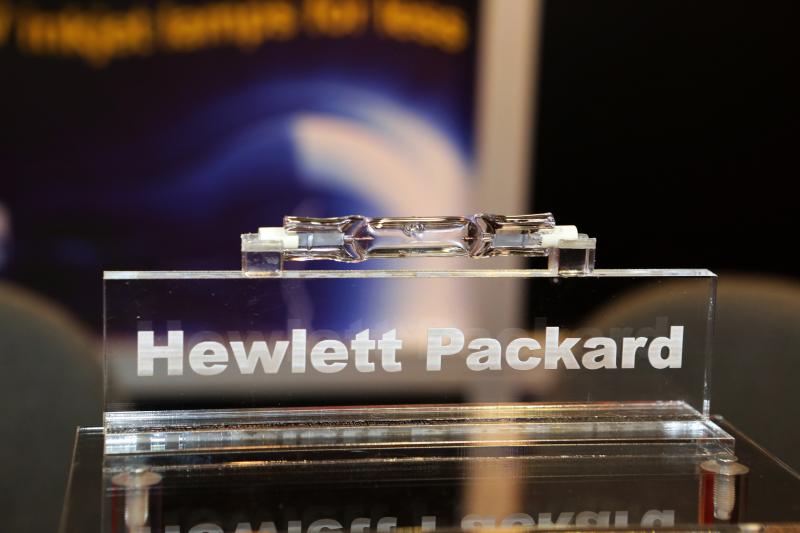

Your FB500 uses a small lamp that HP calls CH231A. What you are describing is not mercury rather it is an iron salt specifically iron iodide. You may have heard the term “metal halide” to identify a specific class of UV inkjet lamps. Your CH231A lamp is a metal halide lamp. During lamp warm up this halide enters the arc stream producing abundant amount of 380 nanometer UV. It will reappear upon cool down. TCS Technologies manufactures a version of the CH231A lamp for $155.00 each.
