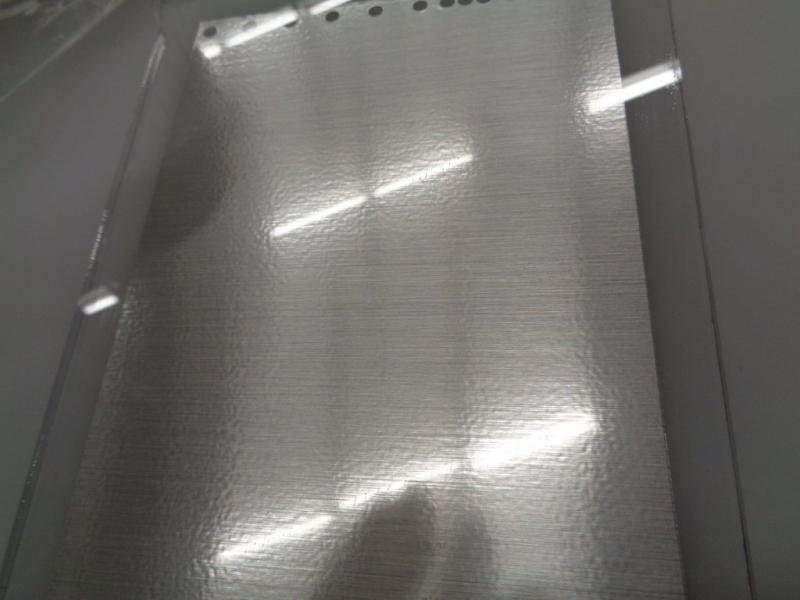

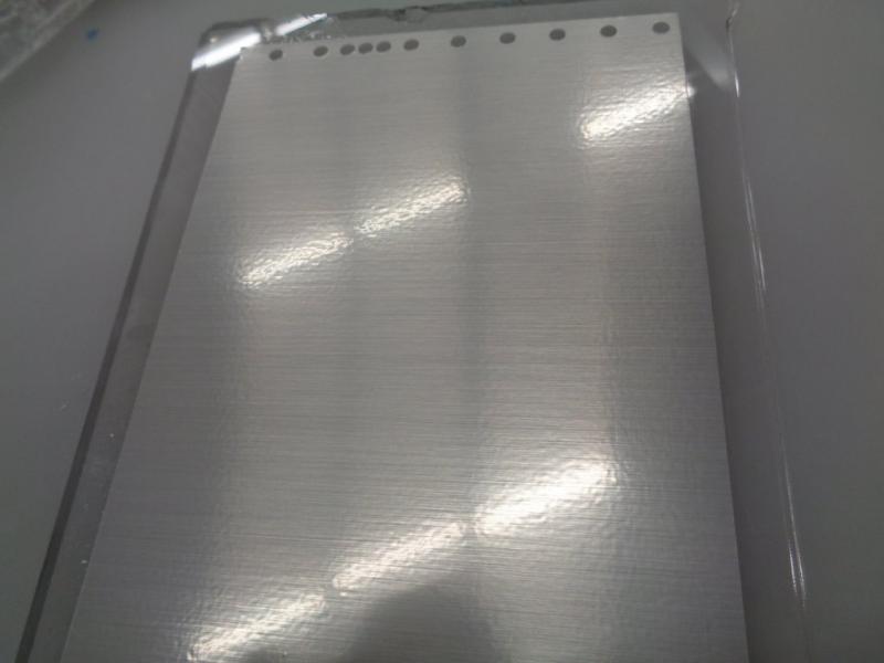

Here is a photo of what I mean. It was applied with a cold laminator. Same results with squeegee, water, etc..
1st photo from top, 2nd is from underneath clear acrylic.
I was told it is the glue used for the polyester. It does the same with the chrome effect film.

If it's the glue, then it might settle and disappear in a day or two. Similar to the glue texture you see after you apply laminate to a print, which also goes away on its own.
Or, maybe there's some sort of plastic film on the top layer of the metallic vinyl? I had a customer bring in a metal film today that was aluminum with a layer of PET film on top of it, and the PET side was chrome but had a similar texture to what's in the picture you posted. The other side was perfectly mirrored.

Are you printing with the Edge? Do you have heat assist with that cold laminator? Laminating slow and Laminating with 100F temp on the roller that is applying it will both help eliminate orange peel. But I'm guessing at what you have. We have a brushed silver 2 mil High-Bond poly made for thermal printing.

I don't have a Gerber printer. I have my material printed outside on a Vutek. Haven't tryed laminating with low heat yet. Sounds like a good idea..
