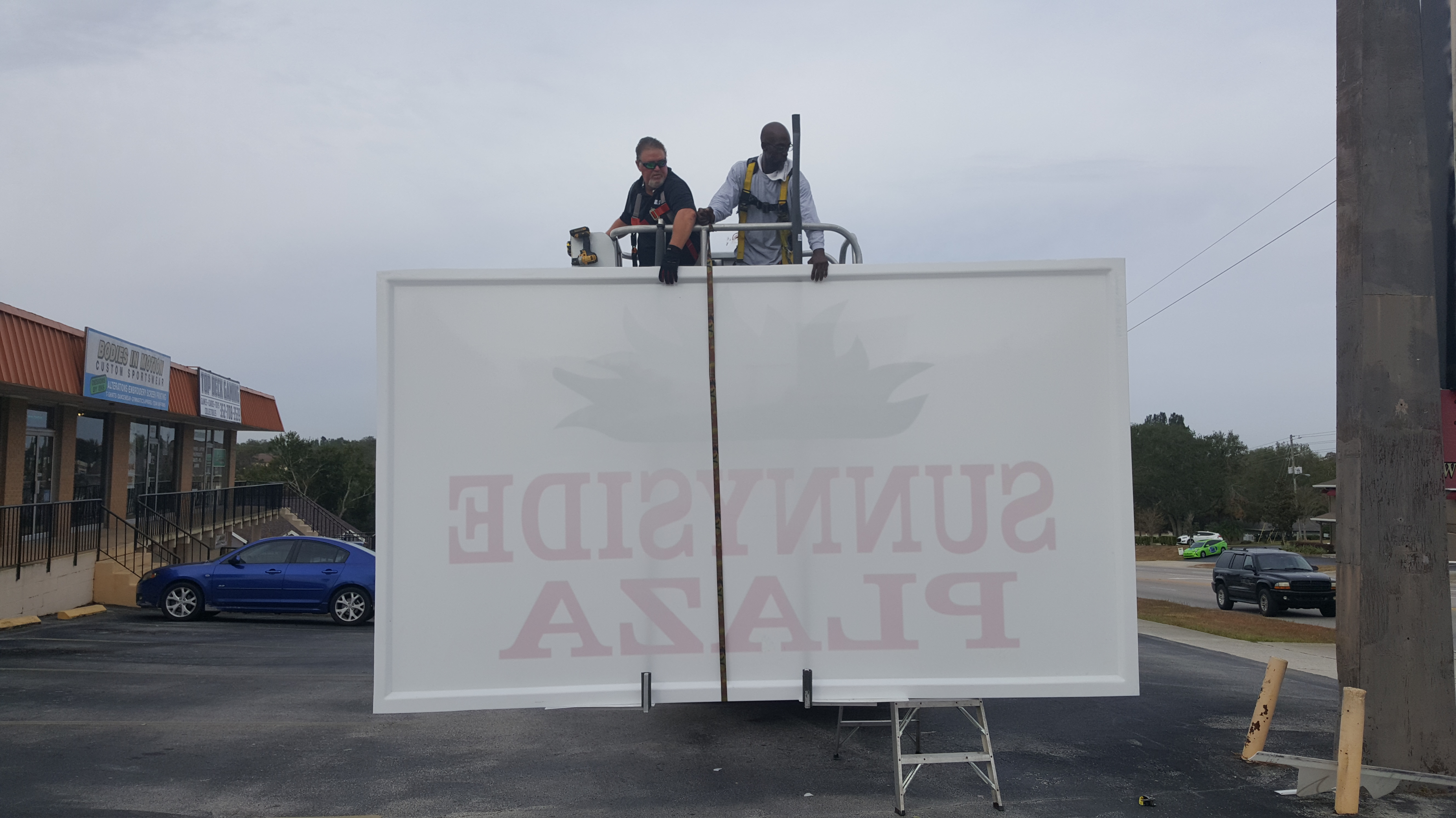

I have a track system on mine. I can install 5' x 10' faces without needing to hold them. They slide thru the track and into the sign. Custom made from scrap at the shop.

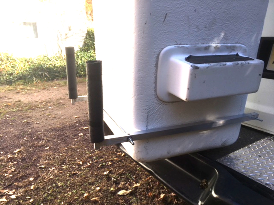

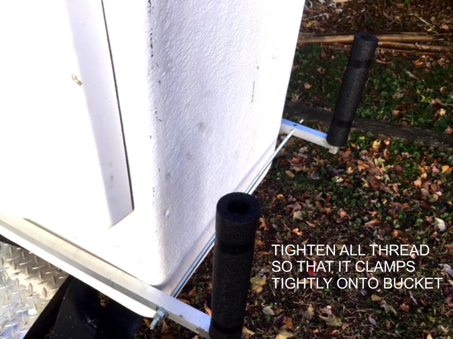

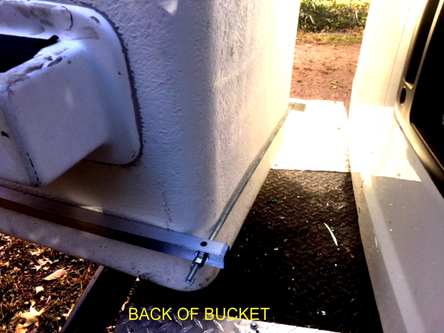

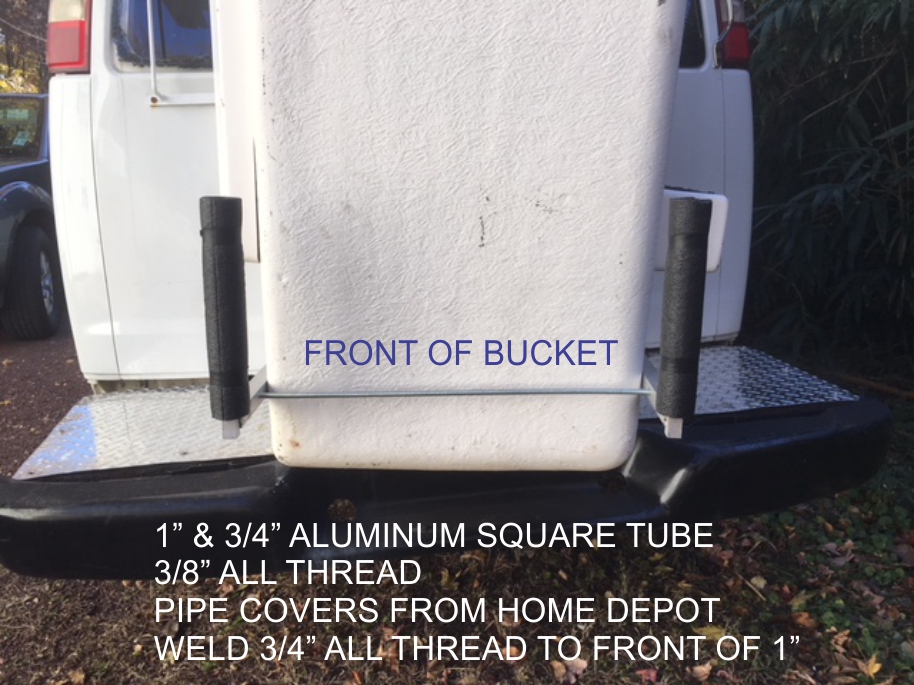

Here is what I built yeterday with 1" & 3/4" Aluminum square tube & 3/8" all thread
I did not want to drill into my bucket so I installed this onto the outside of the bucket & used the all thread to squeeze it tight to the bucket.
Should hold light signs & plex faces with no problem.
The uprights are 3/4" aluminum square tube welded to the front of the 1"
The pads on them are pipe covers from Home Depot.
I weigh 185 lbs and I stood on it with no problem.
Hope this helps.

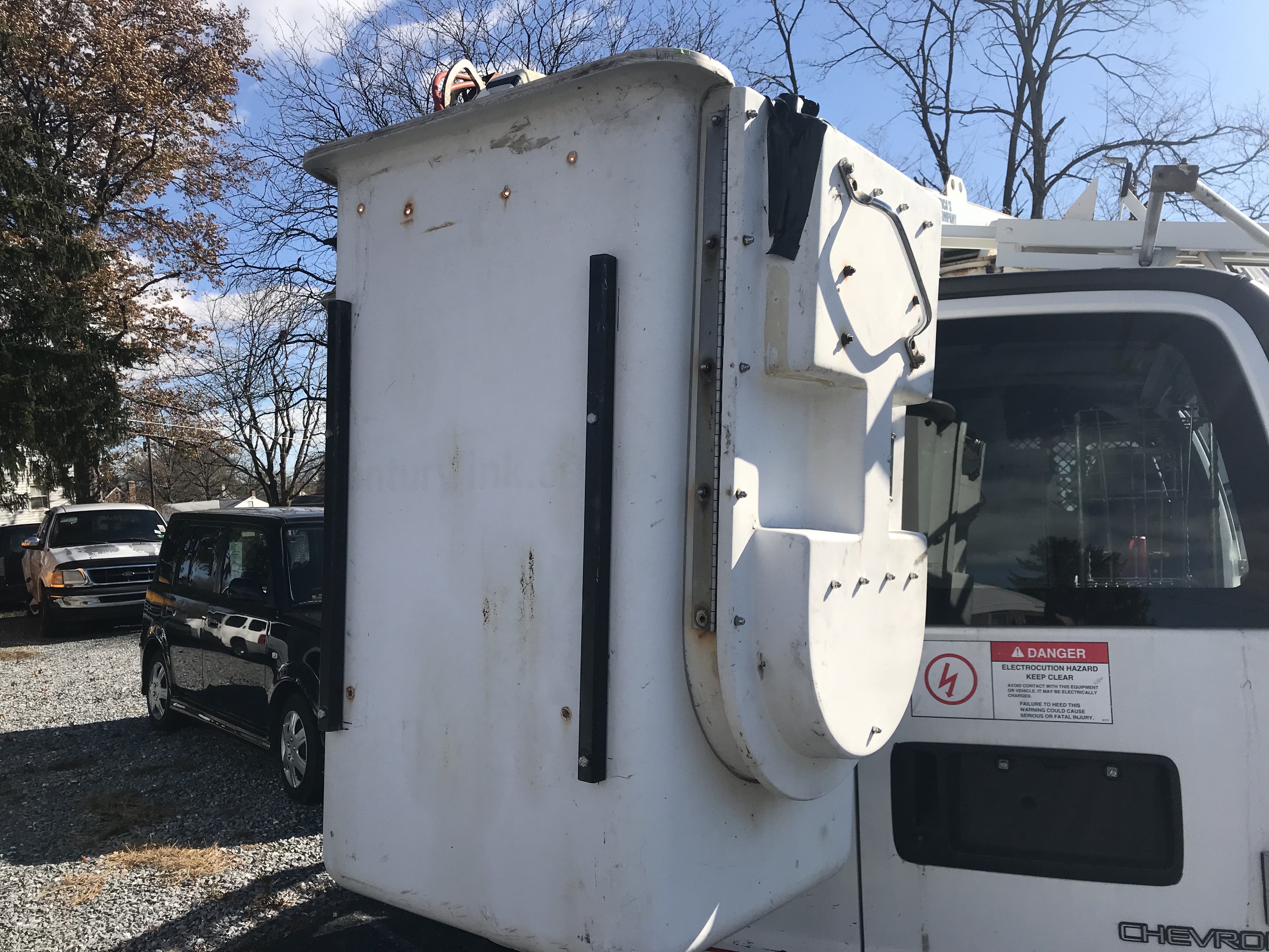

S shape 2" alum tube bracket with hooks at top and reversed hooks at bottom. Top hooks go over rail, bottom hooks hold sign. Rope for lateral support.

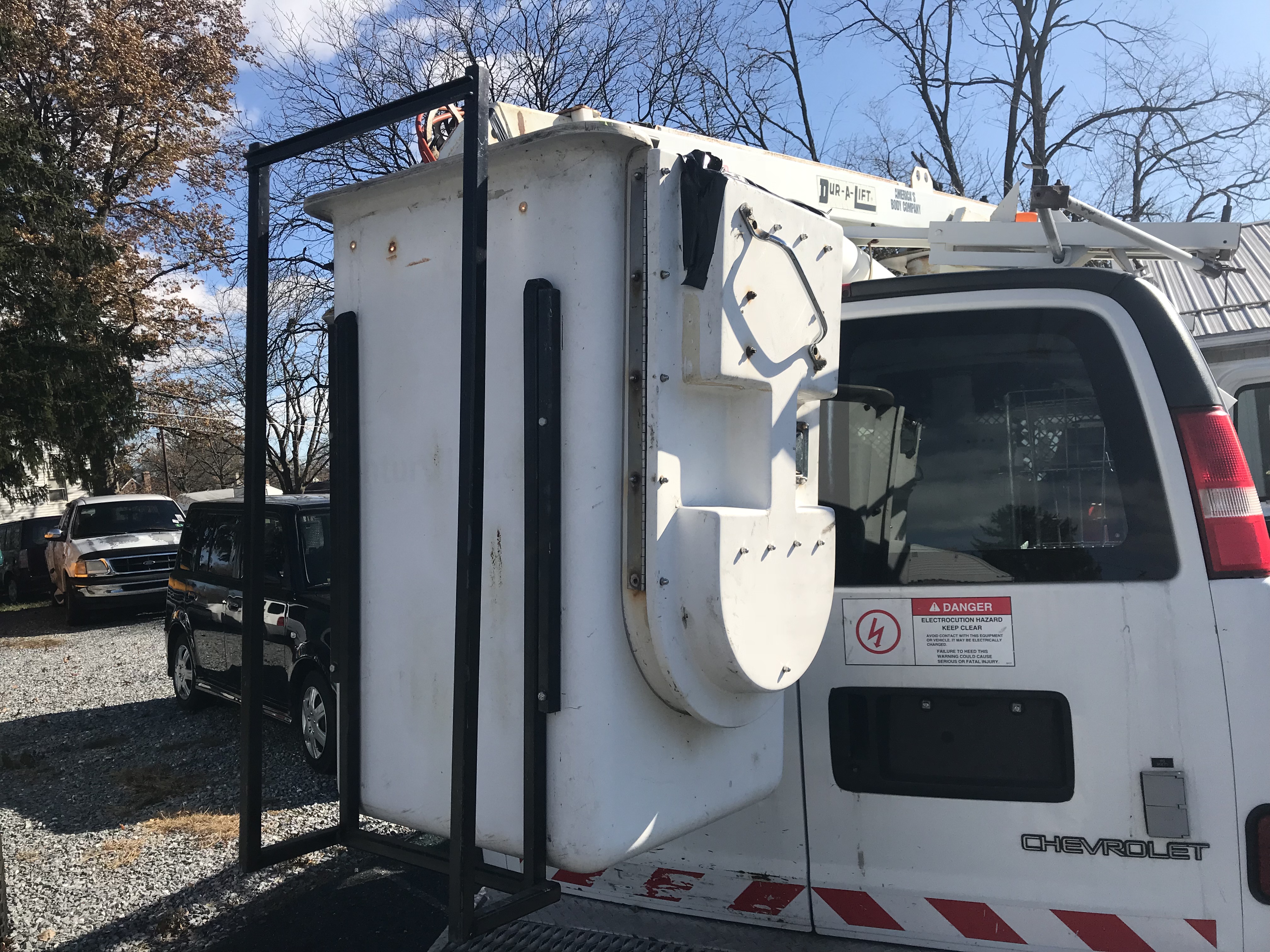

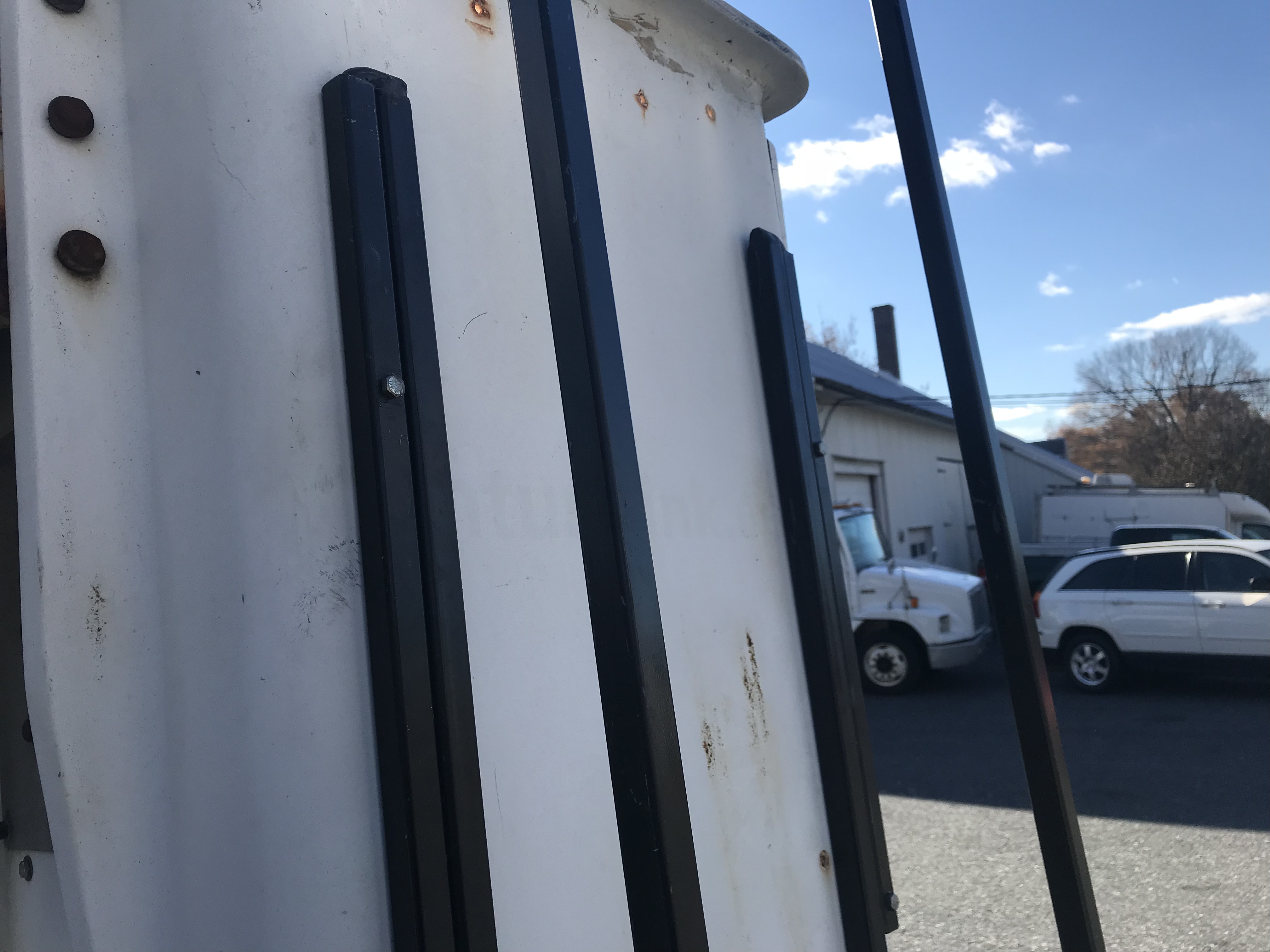

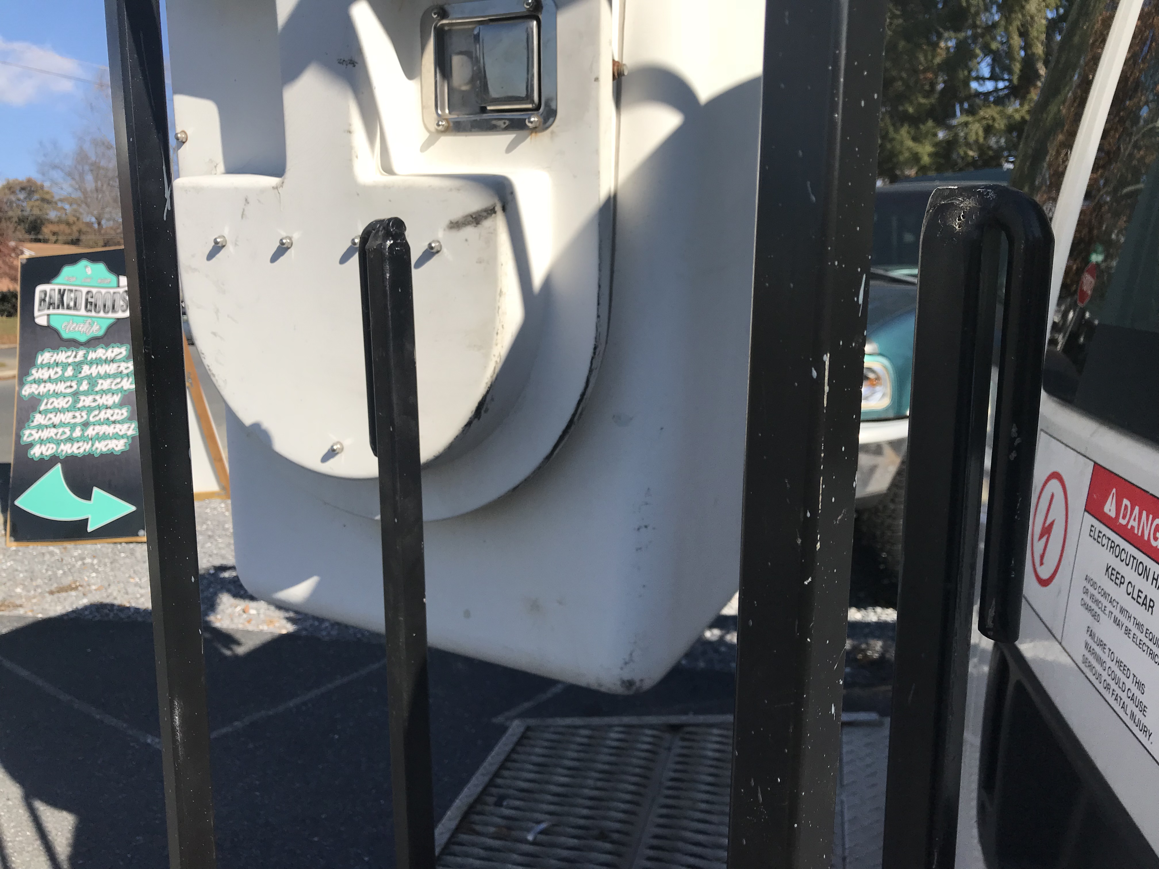

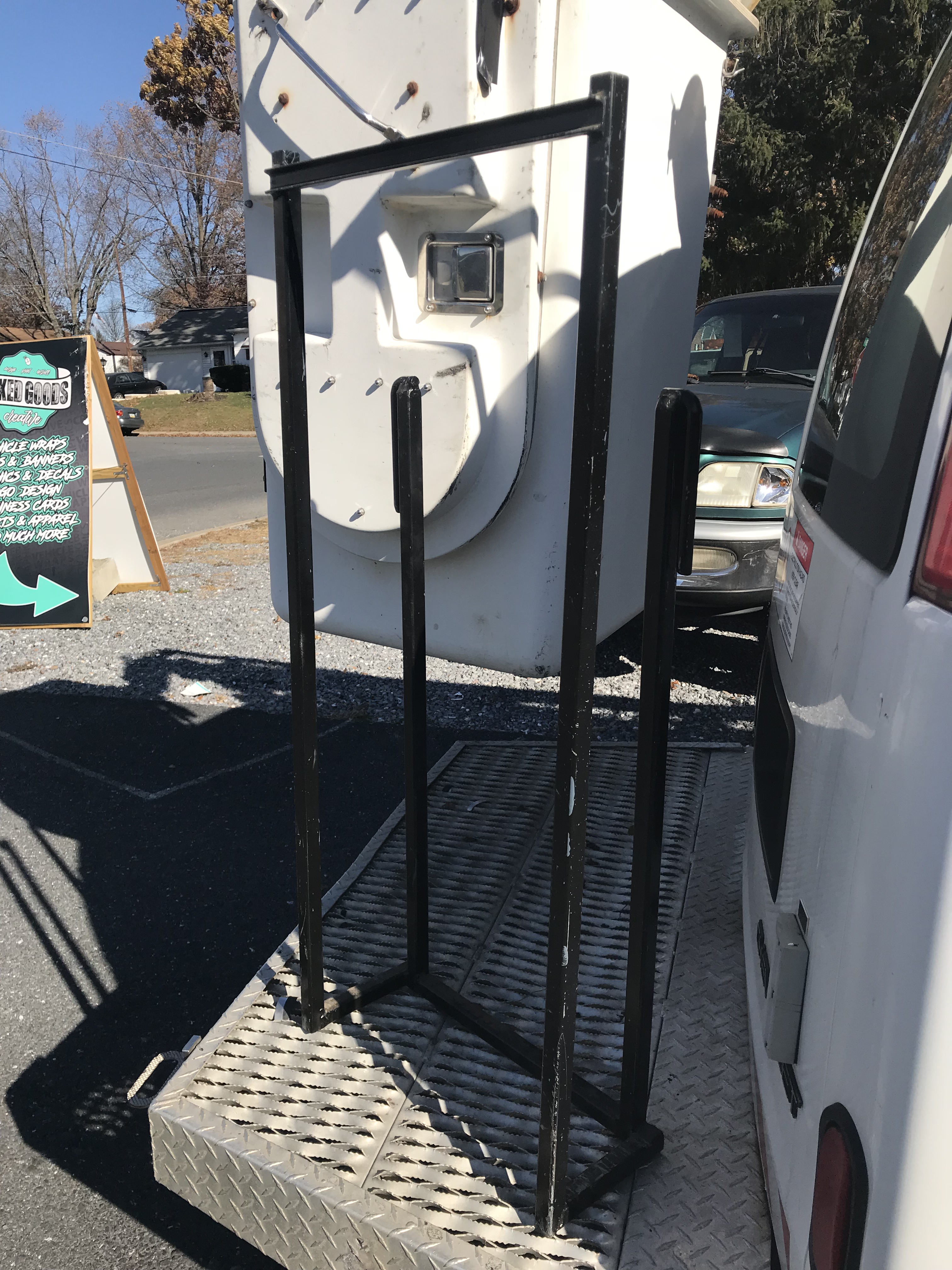

I was just putting my rack on my new bucket van this past week here before the holiday. All made from 1x1 box tubing and then some round bar for the J hooks to make it removable.
