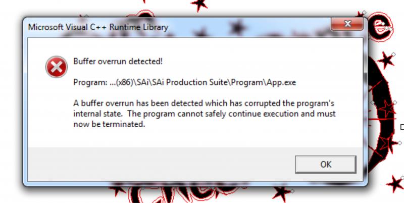

I get this error message (crash) at least once a day. It happens mostly when I am closing a document...Anybody experience this?

Other than happening once a day, have you noticed any additional situations that are similar when experiencing this issue? Other programs running in the background, large number of vectors, masks, or transparencies being used?
Being a very early release of 10, I would recommend updating to the latest stable version 10.5.3
Be sure to update to 10.5 first, reboot and then open Flexi and use the HELP>Check for Updates.
Or you can download the 10.5.x full installer and install into a different directory than the 10.0.2.
http://www.flexisign10.com/Flexi10ProductDownloads.aspx
