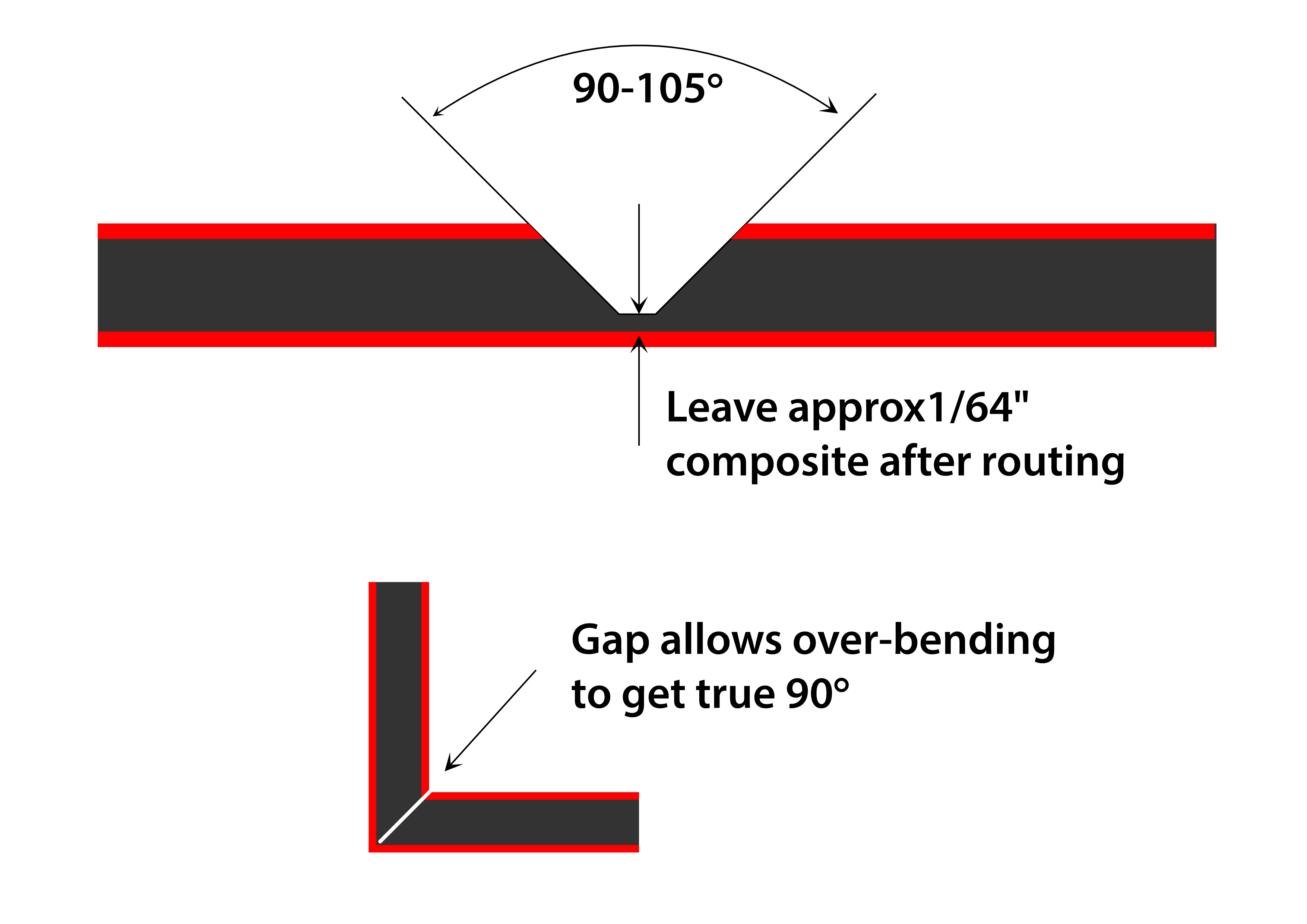

You can do it that way... Use a guide clamped to it to keep your groove straight when you route it, try to get it slightly over 90 degrees to account for spring-back when you bend it and still have a 90. Best to bend it with a brake, but you can probably get creative enough and bend it without one. I suggest using some scrap and practice first to get your groove depth right and see how it bends. Leave a little composite, don't cut all the way to, or into the back aluminum panel.
