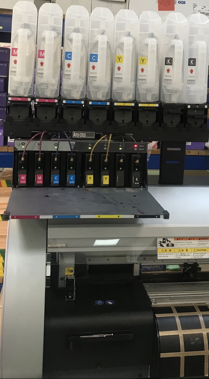

We had a sortve open system where we just emptied in the ink and bought it in litre bottles. Saved us a fortune but due to the ink being slightly exposed to the air (guys that supplied the ink and system said to leave the caps on but not tight) when we stopped using it as much (it’s a backup now) we got a lot of problems with the magenta - frequent drop outs.
after we complained the company switched it out for a “closed” system where the ink now comes in 2l vacuum bags, only problem we have now is their crappy chips die all the time so we need to keep a few spare. No drop outs whatsoever and the ink is 1/3 of the price of OEM. Looks like the attached.
