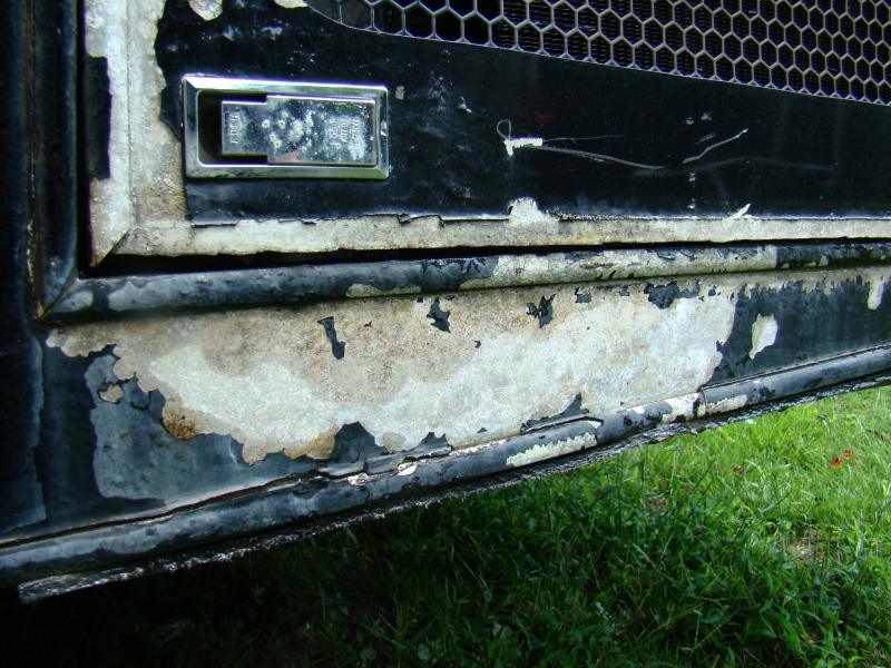

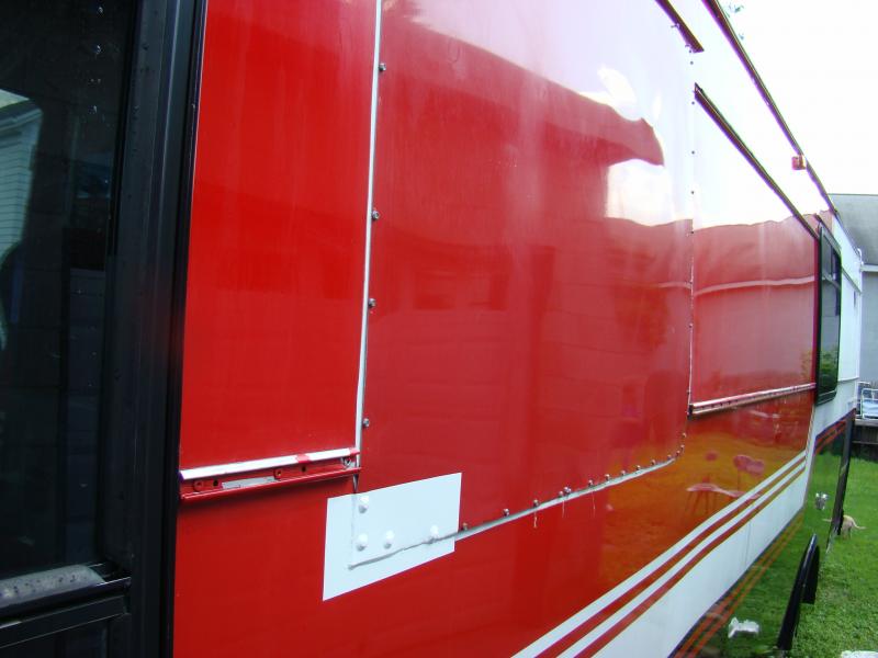

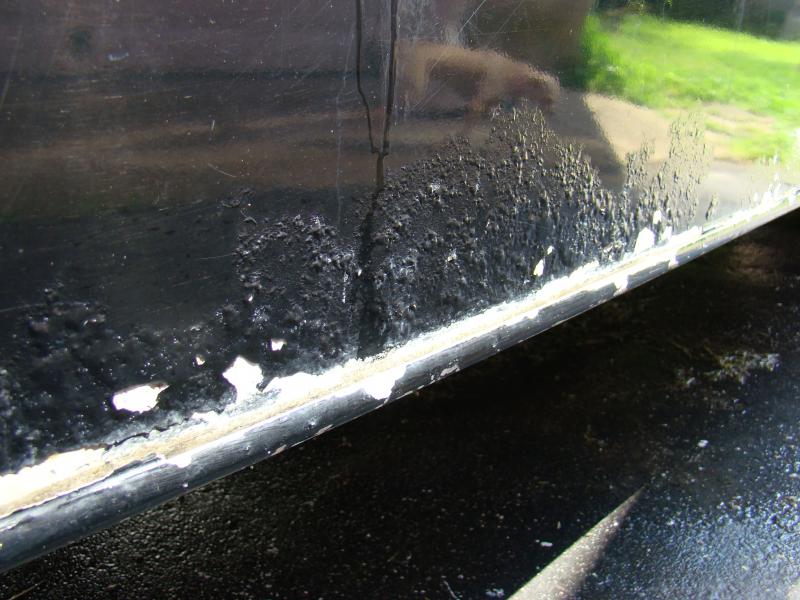

So I'm going to be using busmark type material to do a temporary wrap on this bus. One problem i think i'm going to have is that these rails on the sides are gonna screw me up when it comes to aligning panels. Should i just lay the vinyl over them instead of working the vinyl around the rail? the problem is i cannot heat conform it around the rail. Well i could, but it definitely wont stay because its calendared vinyl. So do i just let it a make a huge tent over it or what? also there is paint chipping all over the bottom of the bus and around the rails.

Anybody got ideas how to make this issue work with those rub rails?
I just emailed the customer and let him know there will be adhesion failure in chipped paint areas. and asked if i could remove the rails. (which means i have to go out and but rivets since the bus body panels are seamed in those spots also)

I think I'd just panel right over them - split down the middle of the rail and then trim it back to the upper and lower edge of those extrusions.
Just be careful to not scratch the paint.........

I thought about doing this also. but worried that it will in a area where there is text. Also some of the rails have white paint on them and some have red. They will stick out like crazy and kill the design. Anyways i just talked to teh customer and he pretty much said do whatever i need to do to the bus to make the wrap turn out better. So ill be removing the rails, scraping chipping paint, and spray painting. this should be fun. But i know i wont be flipping out trying to deal with the rails now.

sweet baby jesus. I would be sure to tell them you're not responsible if it fails in a few days. I'd sand it down to the aluminum and slap on another 300.

I wouldn't wrap around the bottom of the bar either, i'd cut it off in the groove.
All this is for the good of longevity, make the customer understand

As far as the adhesion, I would be sure to use 3M Primer 94 around all edges. If you have to make relief cuts, make sure to primer those areas before you start wrapping. Make sure that any place that you stretch and push film into is post heated to 200F and re-squeegee every seam and edge really well.
Make sure that you remove any chipping paint and advise the customer that you are not responsible if the wrap fails.
