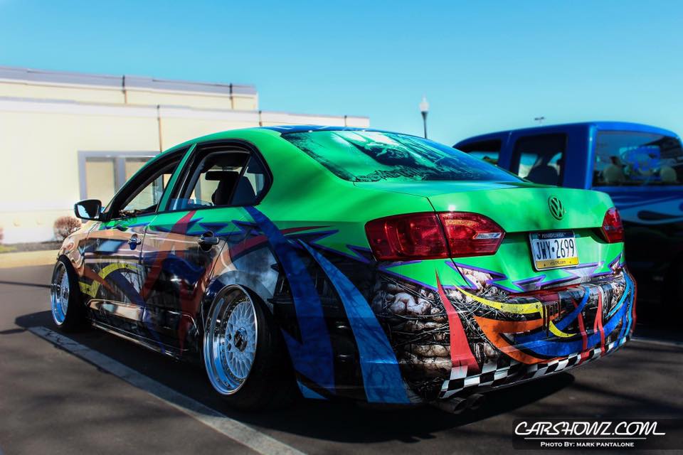

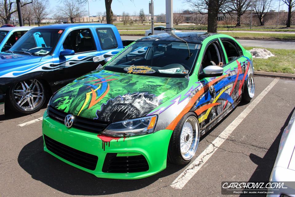

THIS ENTIRE CAR IS PRINTED USING LATEX ......................i have been printing since 1990 and have used all makes of printers and love the latex printers
Roland i will never use again!

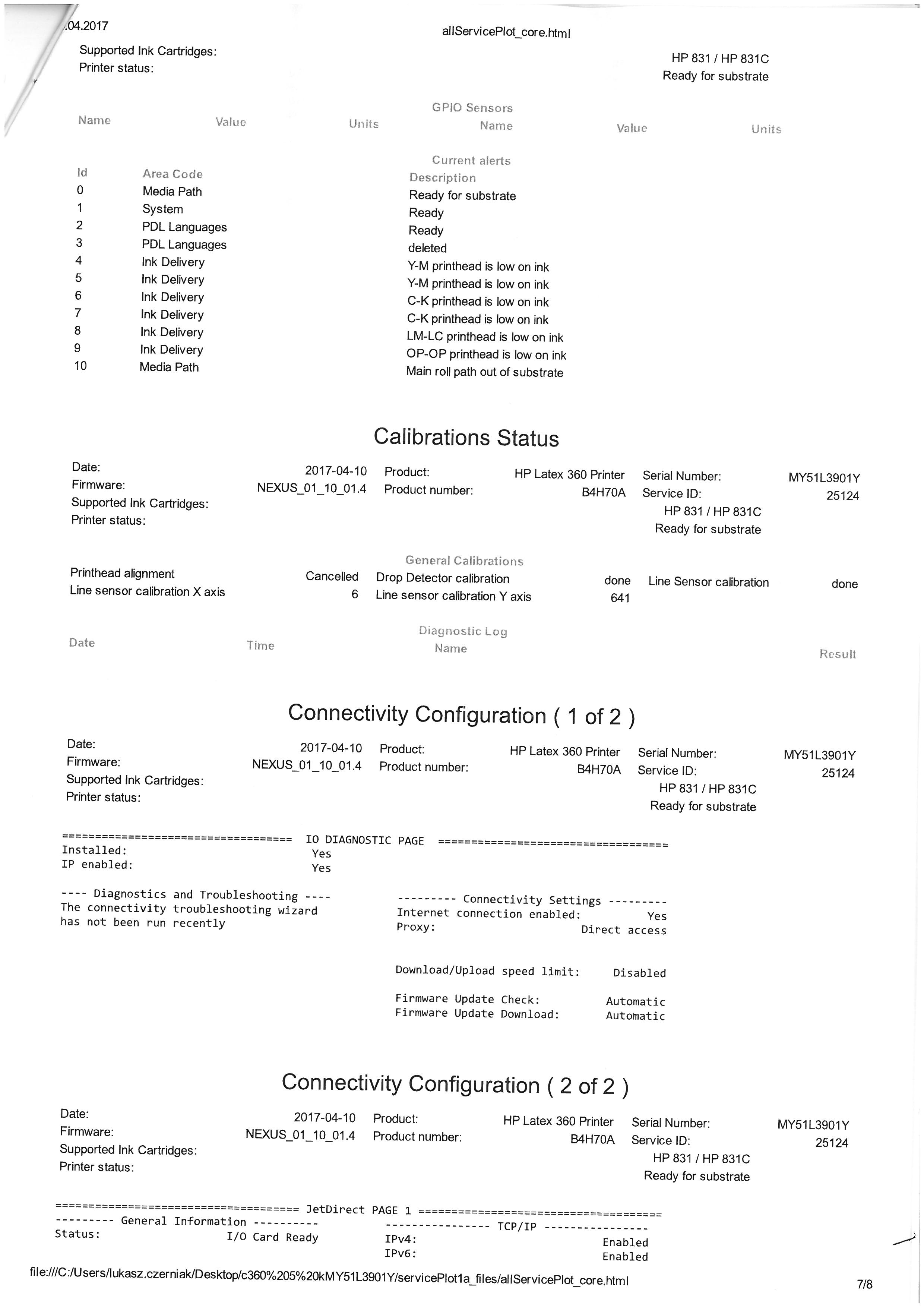

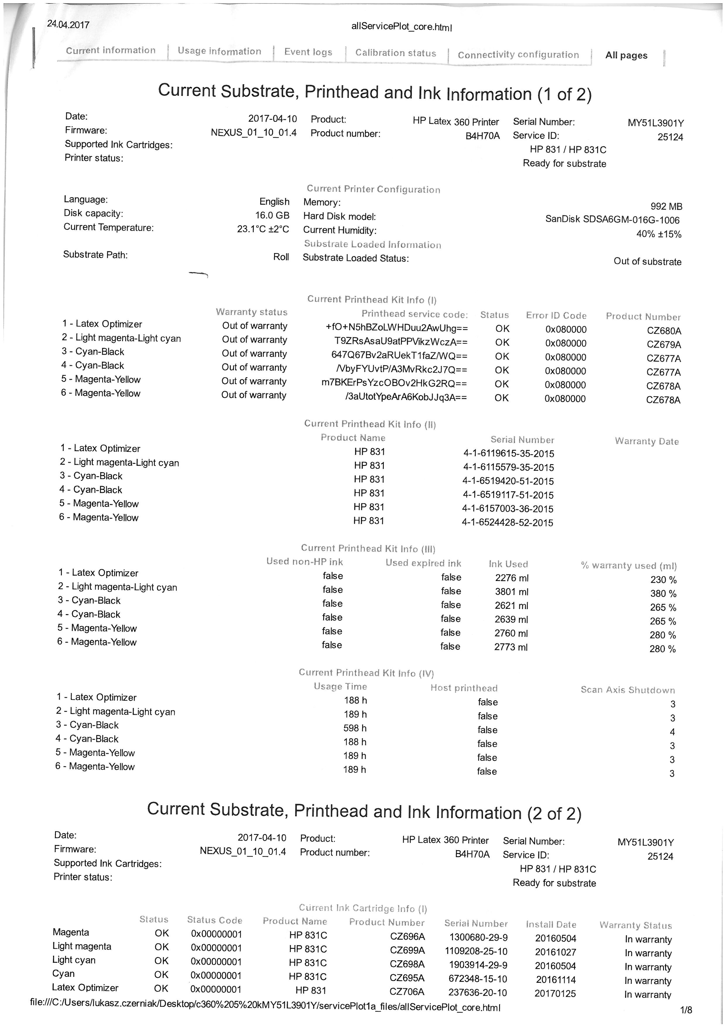

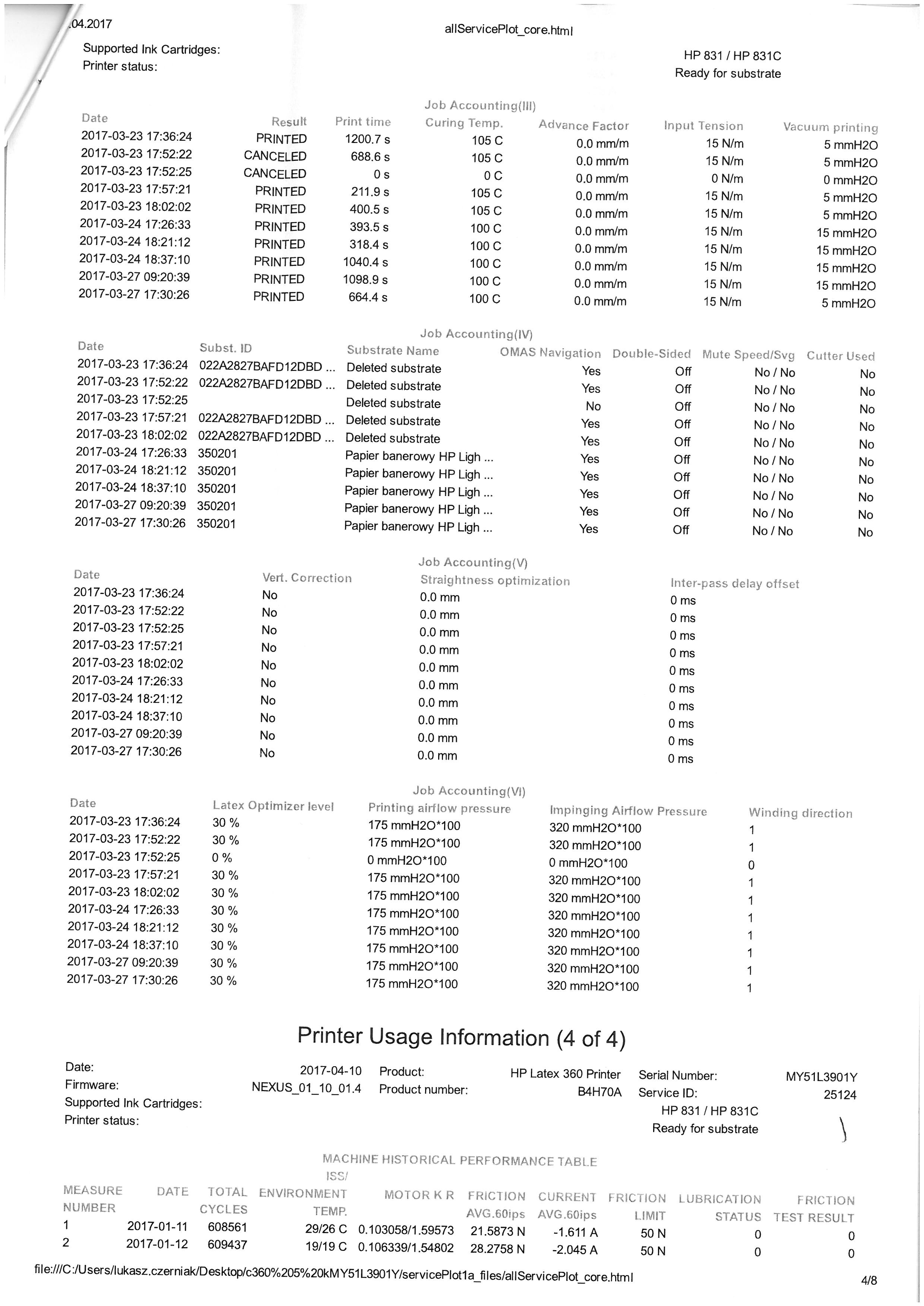

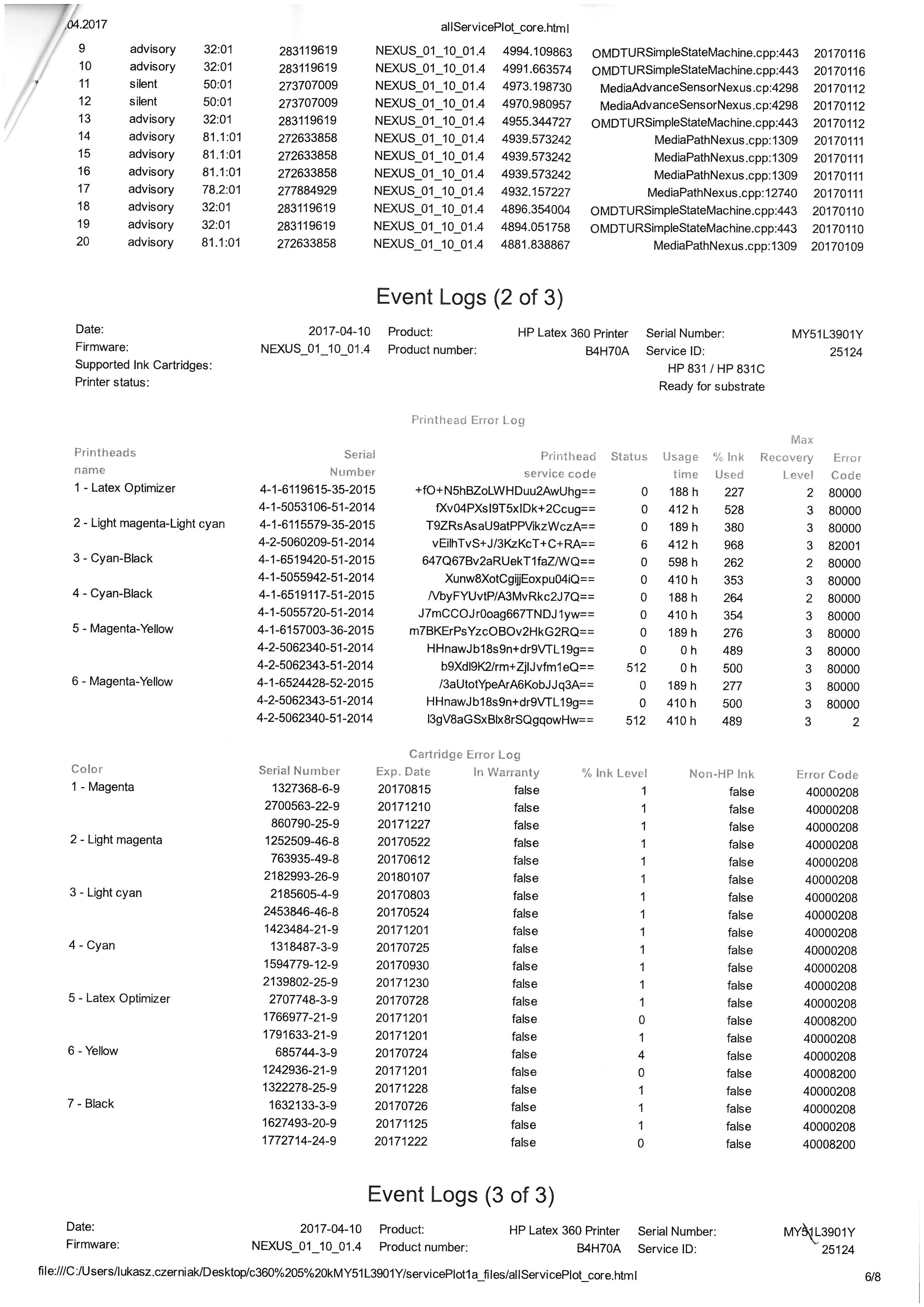

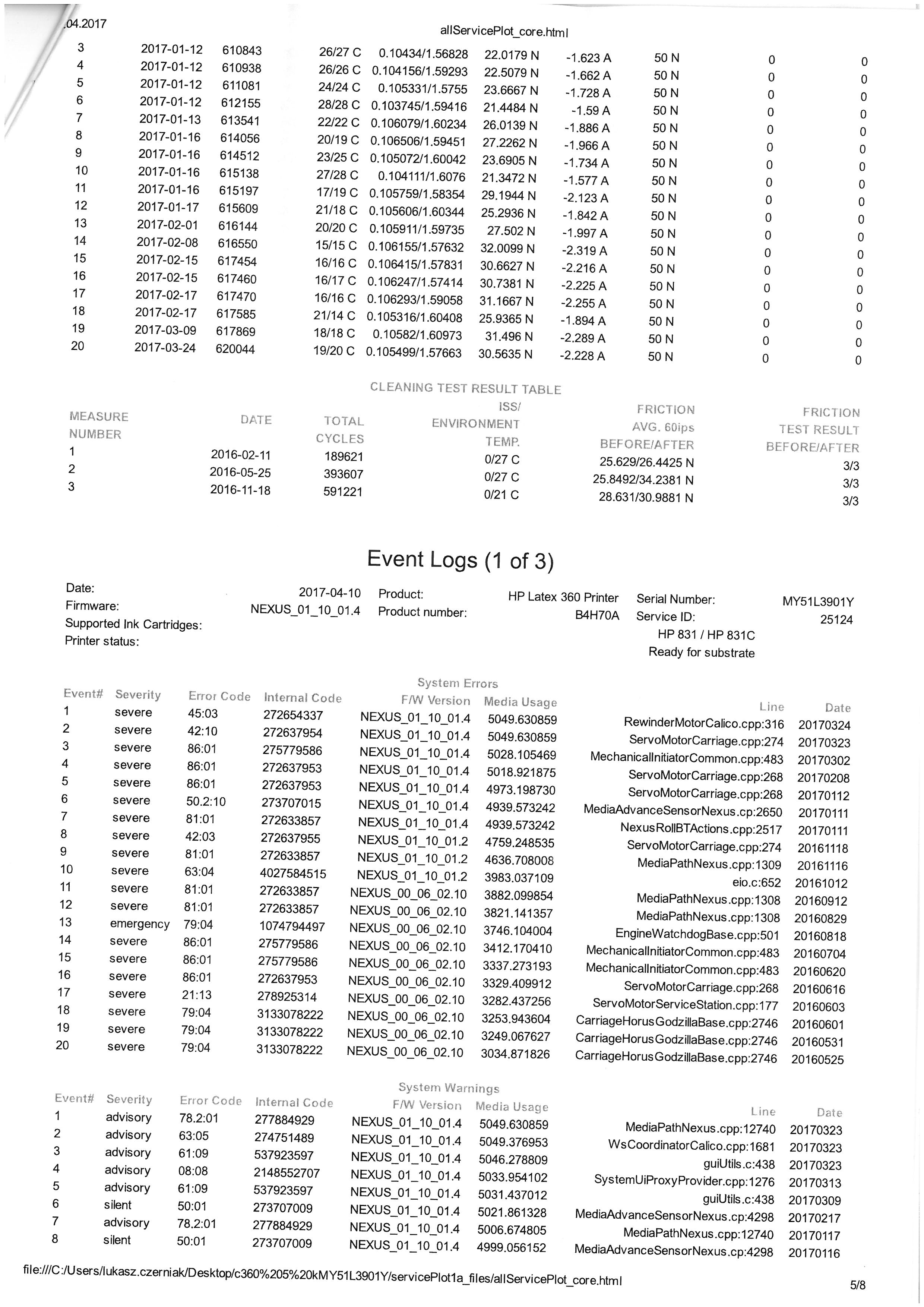

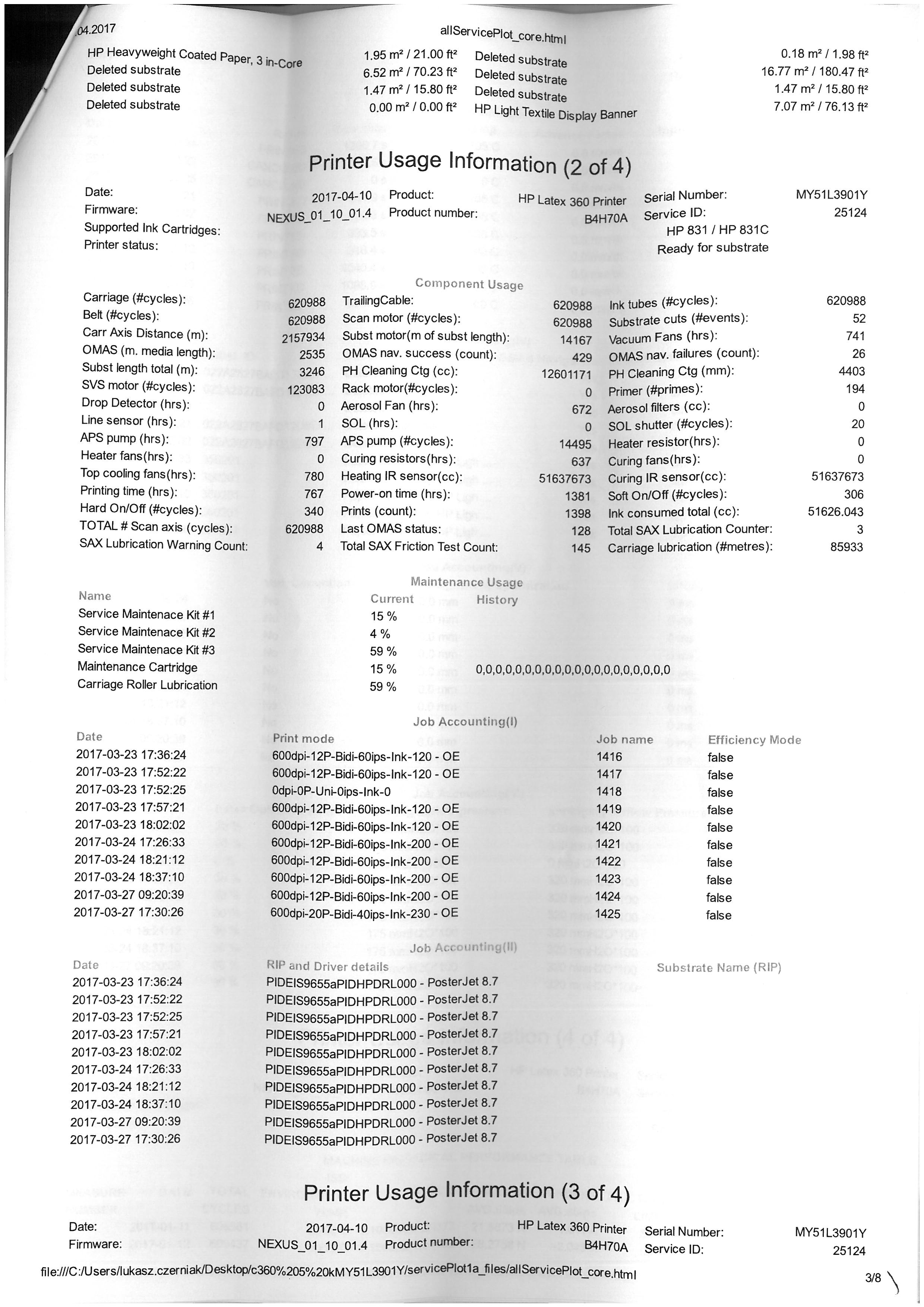

Thanks for the answers!
I have been testing the machine nearly whole monday, and it looks pretty solid, the exterior looks clean, everything seems to look fine, i know the pros and cons of latex vs solvent, i like the scratch resistance and fast print head replacement the most, i don't like the fact that you can' t put in small pieces of material. I have the service report attached so maybe someone could take a look and share some information especially from the error report section...?
S25C-417042515550.jpg S25C-417042515560.jpg S25C-417042515570.jpg S25C-417042515571.jpg S25C-417042515580.jpg S25C-417042515590.jpg

Looks great in the pics. I can only wonder how much better it would look if it were printed using solvent inks?????

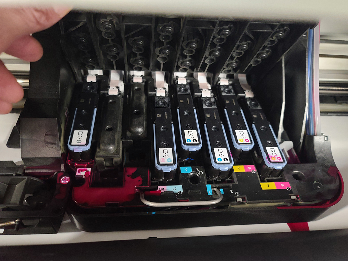

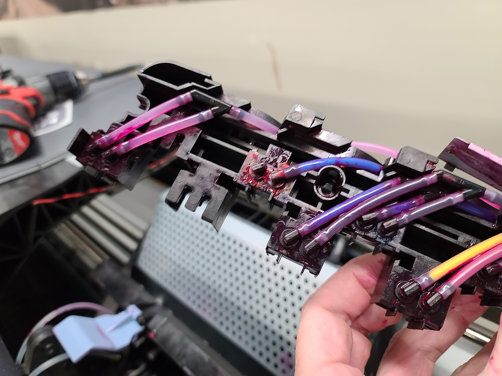

Don't, and if you do go latex buy new.
Here is the the joy my 6 year old well taken care 360 gave me this week. I have never had a large format printer just spill ink everywhere. Before I decided to drop $2K on a tech, I thought I'd take a closer look since I remembered how easy it was to swap out ink line kits in the old 5000 design jets; I found the problem and when I tried remove the ink line form it's connector, the damn connector broke.
Buy a machine you know will last a long time and won't have to worry about the manufacturer up and deciding they are done with it in 10 years.
Edit: these pictures don't even come close to showing the mess that was made.
