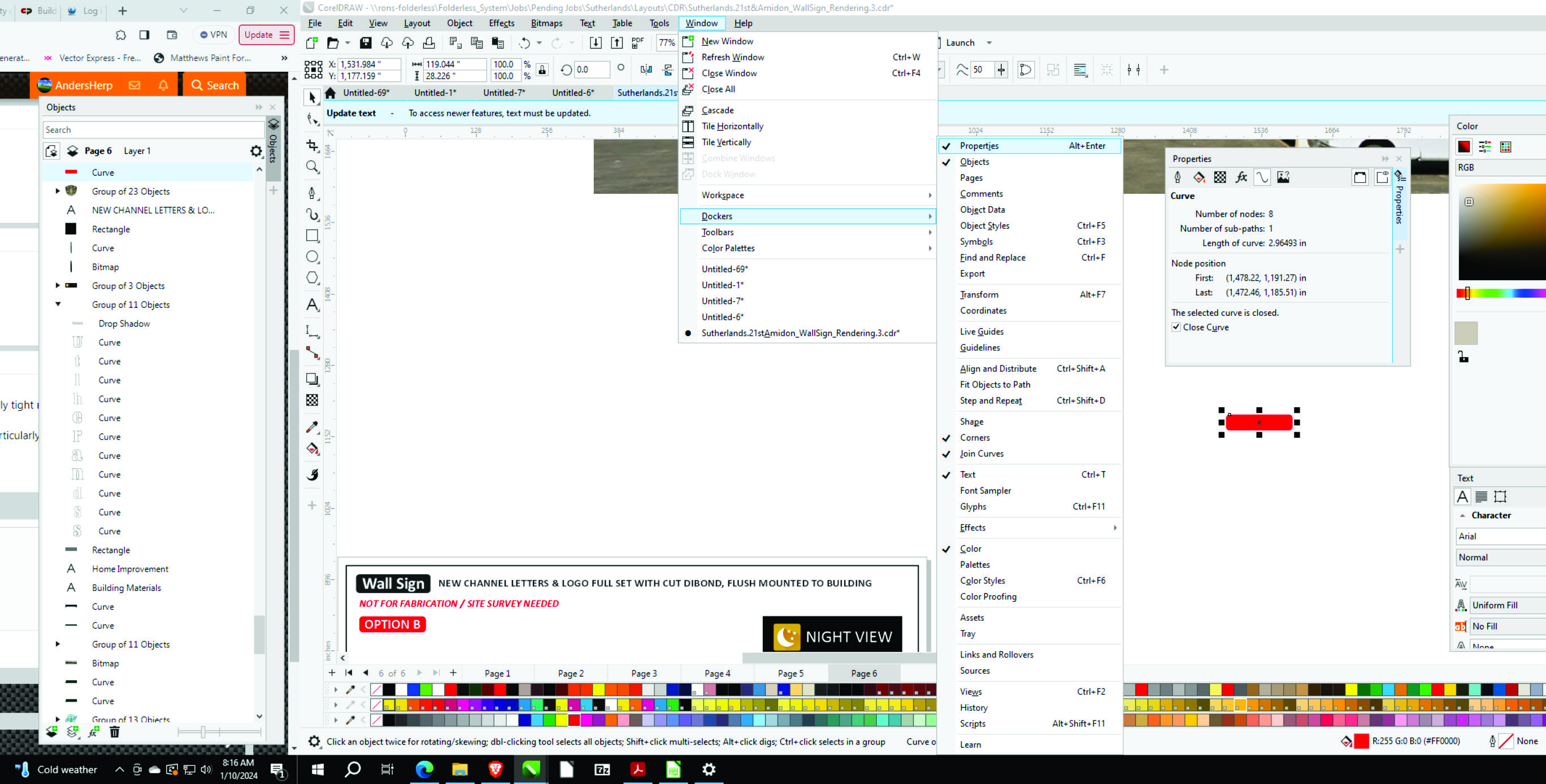

Yes there is, but you have to have the object converted to a curve. In the Properties docker, there is a tab at the top that looks like a squiggly line and is called "curve." If you have the object converted to a curve and selected when you go to this tab, it tells you the length of that curve. I attached a screenshot to illustrate. The red object below the docker was converted to a curve and selected.

Sorry, I was thinking distance of the perimeter of an object, say a channel letter. Hope this helps someone though.
