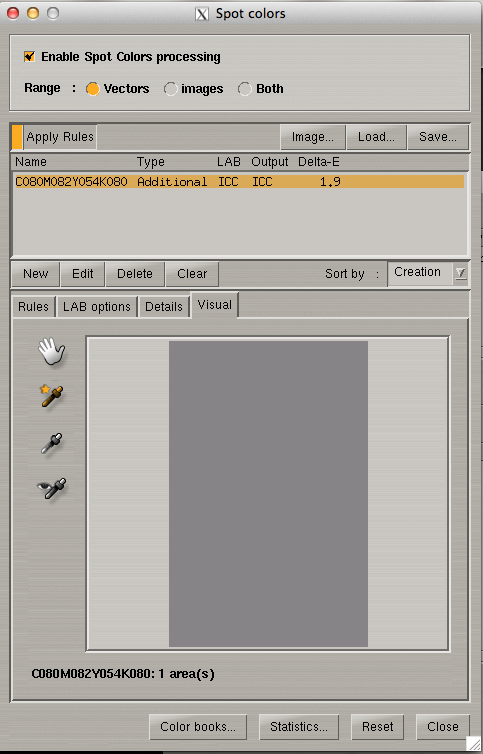

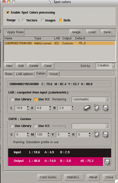

I think I am understanding you right about using the spot colors tab. I've attached screen shots of creating a spot based on an input color and then adjusting the value on the details tab for output.
When I do this and go to print those changes aren't reflected.
This is a raster image and although is a test is the same thing I am trying to replicate for another image. I'ts all raster based.
If this is correct how to do I save or process the file to use these changes?
I can do it in Onyx I'm lost in Caldera at the moment.

Andy_warp
It is possible. After you load your image, go to the last tab in the spot colors (visual) and use the eyedropper with the star.
Also you'll want to click on "images" instead of vector.
I still would never use this, but we print over 10 ft. wide and what can look like a small artifact can turn out to be inches large at output.

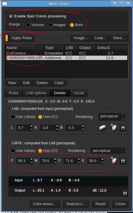

As per attachment..
make sure you have Vector, images(raster) or Both selected for the colour replacement. Cirecled in red.
Apply Rules applies the rules, the little yellow button on the left automatically updates the changes... circled in red.
As you can see here I have chosen C0M0Y0K100 from my image in the Visual TAB using the eye dropper.
The output is then shown down the bottom circled in red. Change these values to what you want the printer to print.
