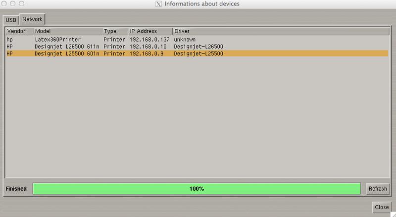

One thing I have noticed in the devices menu the driver isn't being recognised for the printer. Not sure if this is a problem but just an observation. Screen shot attached.
jasonx
It looks like a Caldera update was needed. Wasn't aware of the Caldera user net for the downloads.
Thanks for your help.
