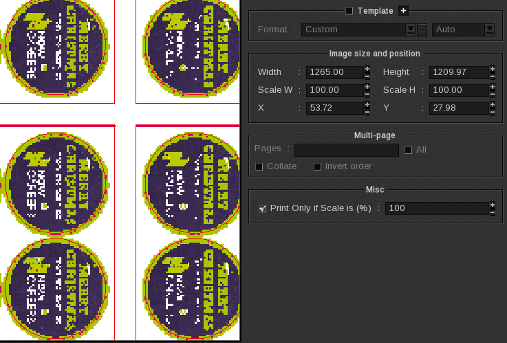

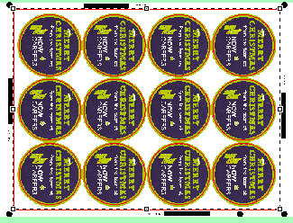

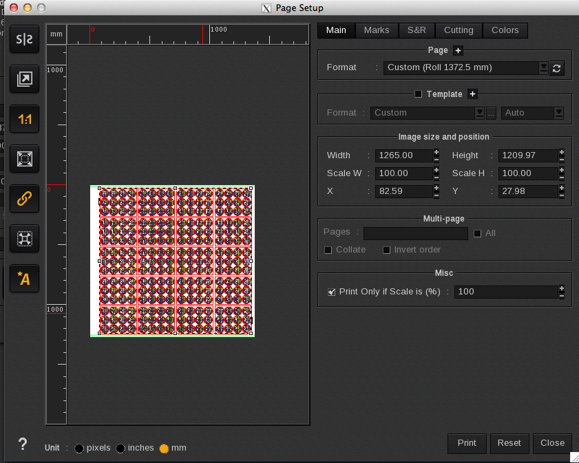

Hi guys,
Me again! How's everyone? Just a newbie question, anyone has encountered an issue about the Caldera shifting the cutlines when step and repeating? Please see attached image for reference, I thought it was just pixelated at first, but it's actually shifting the contours off. For some reason it's only when using Caldera or compose to step and repeat it, but when the file is raw, set up from Illustrator, I'm not having any trouble. So I believe it's the Caldera that's shifting the cut line and it makes it cut off.
TIA for answers!

Might want to try flattening the transparency (all lines except your cut line) in Illustrator. Some RIPS don't like them and shift vectors
