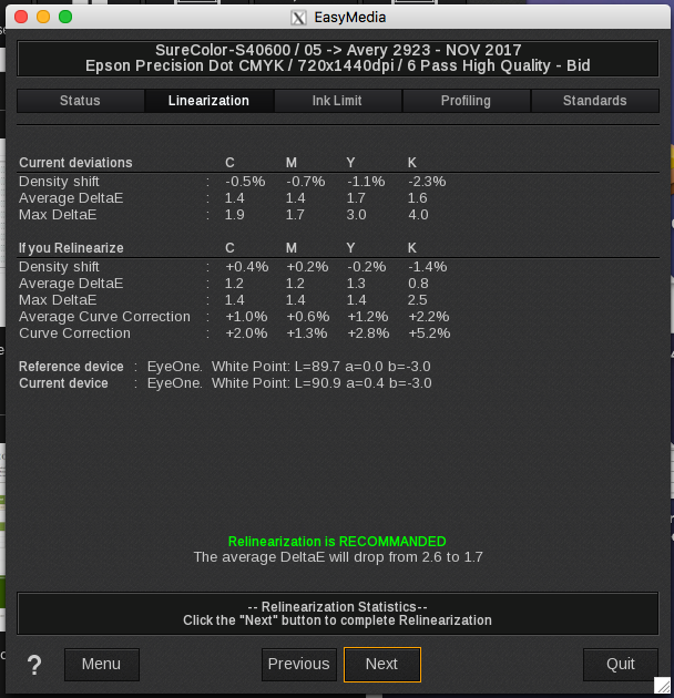

Hi all,
Have not done this, but wanted to check on my almost year-old custom profile.
Attached is the result.
I wasn't thinking and saved over my profile (should have copied), but I will redo it for another profile and print some test objects to see.
Question is.. do you re-linearize? And if you do, how often?
