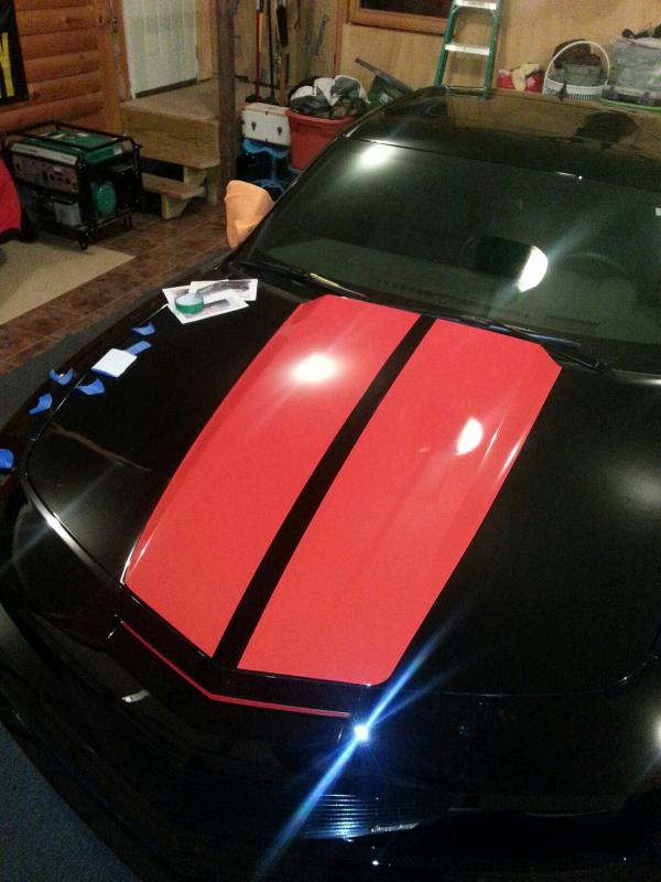

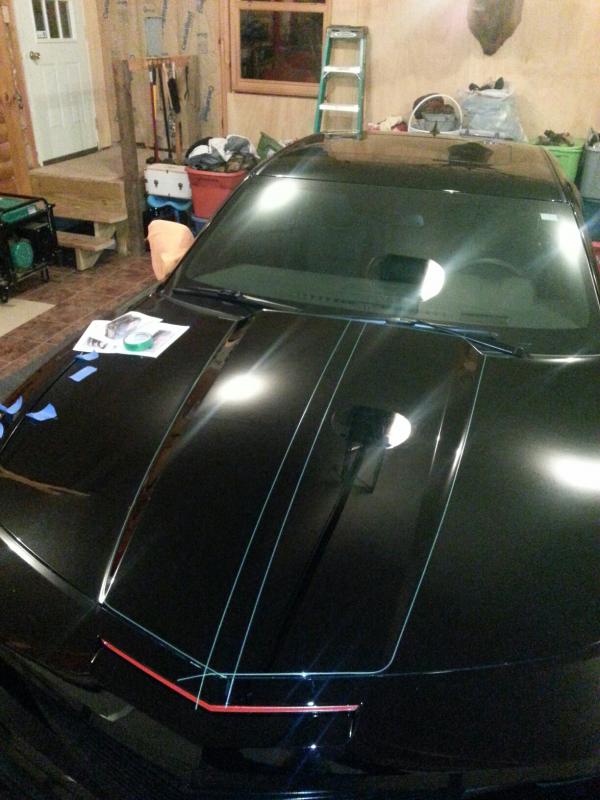

OK, Finally got around to getting this done. I used the knifeless tape with the 3M 1080 Hot Rod Red as seen in the pictures.
The tape worked pretty good for my first time using it. I did notice that the faster you pull it the cleaner the cut. I'm glad that the customer decided not to put the 1/4" pinstripe around the rally stripes. But he liked it and was happy, for now...
