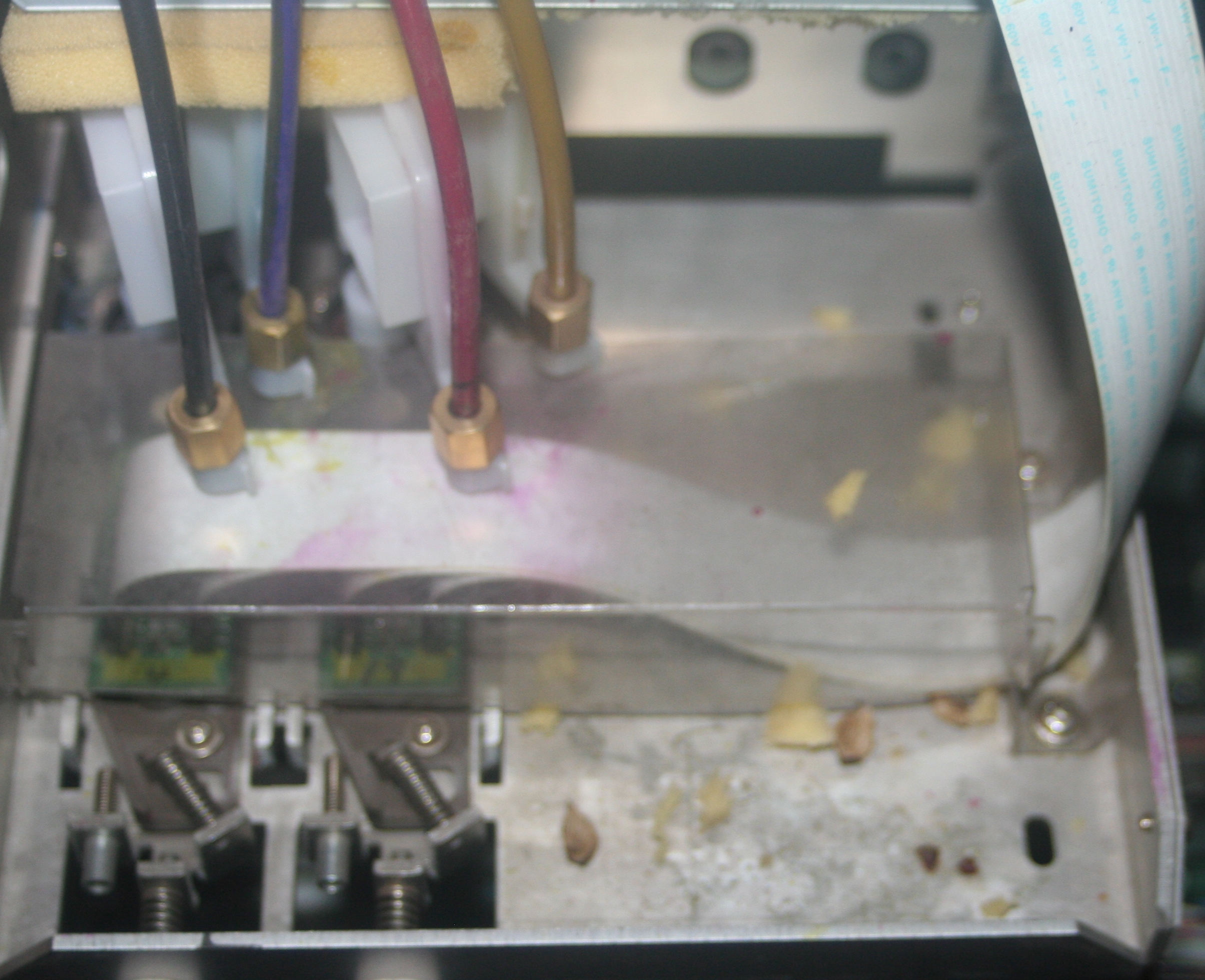

Can anyone guess what is wrong with this printer.... ( this is a weird one )
damonCA21
Have been working on an SP40i which was not working and giving all sorts of errors. The yellow stuff is foam and should go all the way across the part behind the pipes. It also shouldnt have seeds in it
Checked some other parts so far and found the wires to the wiper position sensor and head position sensor gnawed through. Maybe I should get a job for rentokill
