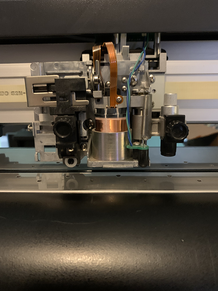

I am new to the professional cutter world and need someone that can help me figure out what is going on. As all of us if we are not producing orders we are not making money. I am at that point right now 4 orders and I can not get them out until I can fix this issue I am having.
So I purchased a used VinylExpress Q60 which from what I have learned is a Graphtec FC7000, the guy I got it from used it to cut wraps and window tint, so he was not able to help me with print and cut. Not much online about this cutter or at least anything that can help. I was able to find the setting to turn on the Registration mark scanning feature and when I print my file from Flexi 21 and place it on the cutter move the head near the registration mark and hit ok to scan, the head moves off the page an starts to look, it moves a little bit towards the paper and continues to look but then gives me a scan mark error. I have called so called experts and non of them can help me why I am not sure the previous owner never used that feature and the reason it was not turned on so I do not think it could be a bad sensor but it could be. I live in the Orlando area and am not able to locate a service center or anyone that can help with this type of issue. I am not able to upload a video that shows what it is doing. I have reset the cutter just to make sure no origin settings could have been causing it. I am sorry for going on and on, but without the video I am trying to give you a picture of what is happing. If you can help and believe me I sure can use it and do appreciate any input to help me resolve it. If you would like to chat over the phone, just PM me and I will pass on my number, if that is allowed here on the forum.

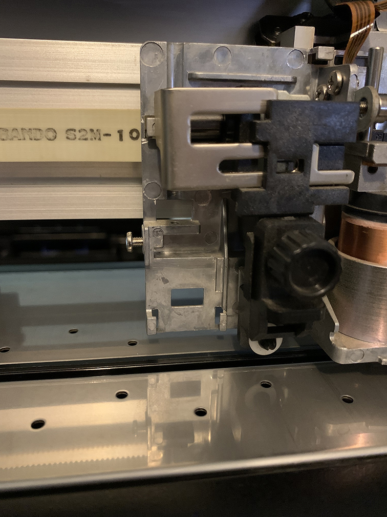

So I guess I figured it out. I do not have a sensor, now the problem is I can not find the parts for it 772126720 auto registration mark sensor assembly. If anyone knows anyone or lace that might be able to help me that would be a blessing.

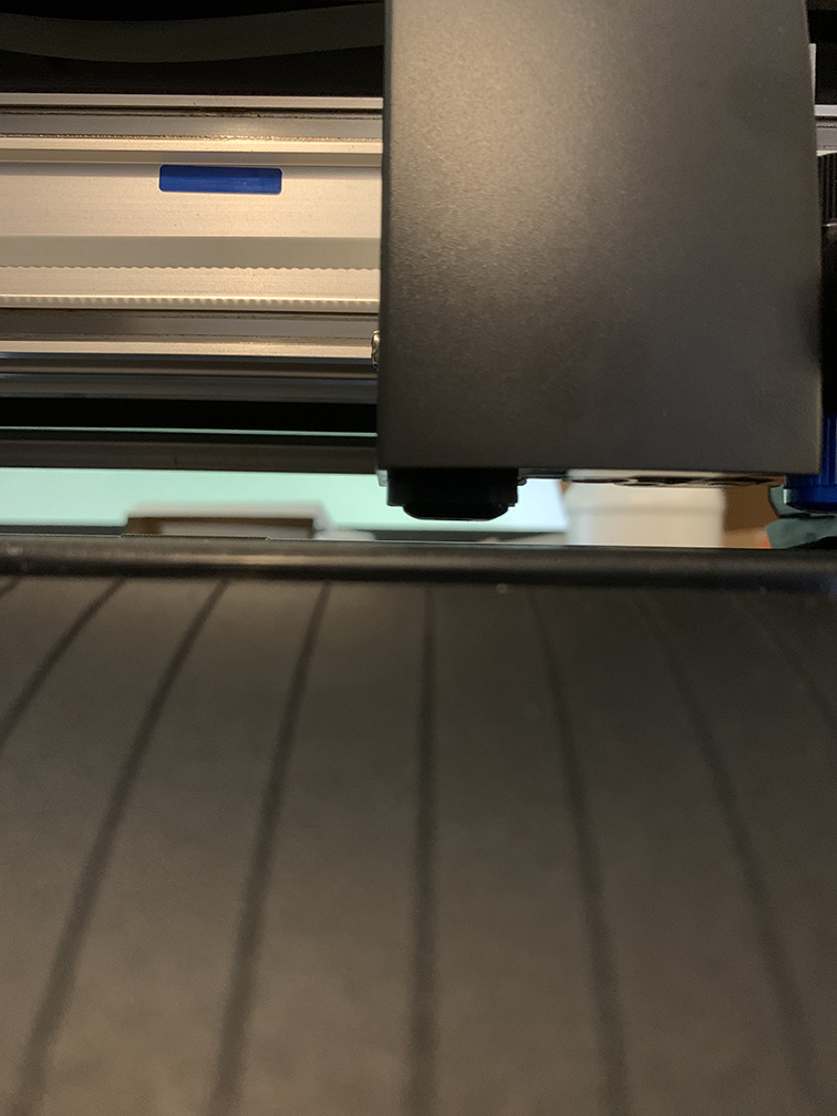

Mine does have the ARMS carriage but it does not have a sensor, I found that out after removing the cover. As you can see in photos 8369 & 8370 the sensor is missing. I have a CE-6000+ that I had to get because I do not have or can not find a sensor, you can see the dome on the left side, that is what you should see on your cutter if you have an ARMS system installed. So if you have an old cutter sitting around and it has a sensor and would like to sell the sensor off of it hit me up.
