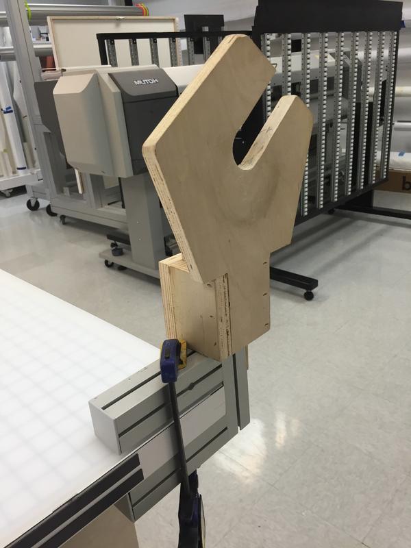

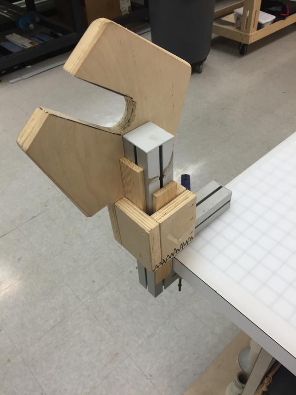

Here's what we've rigged up. Works great and can be removed when not needed. Good Luck!

I've got a similar setup to Bluemoons. Bob's outline is about right. You just need a pipe that fits inside the media roll, and is longer than the media roll is wide, that pipe operates like an axle. Then some way to keep it elevated. It is essentially the equivalent of have someone stand at the end of bench and hold the axle. Makes a massive difference, I routinely pull out 4 metre's of mask when I'm donig cut vinyl. I could probably do more, but my bench is only 4 metres long.

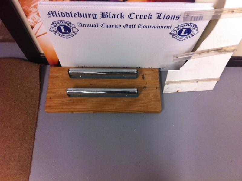

I think u-line, home depot and lowes have them as well. Just happened to grab a few at HF one day while burning their 20% off coupon.
mark-s

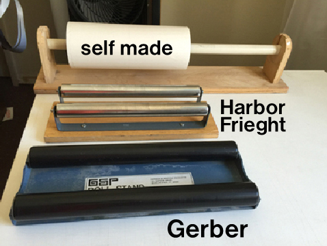

Gerber roll holder, swapmeet find $5.00
Harbor Freight don`t remember cost I think around $10.00 for both.
Home made one a little bit of time
