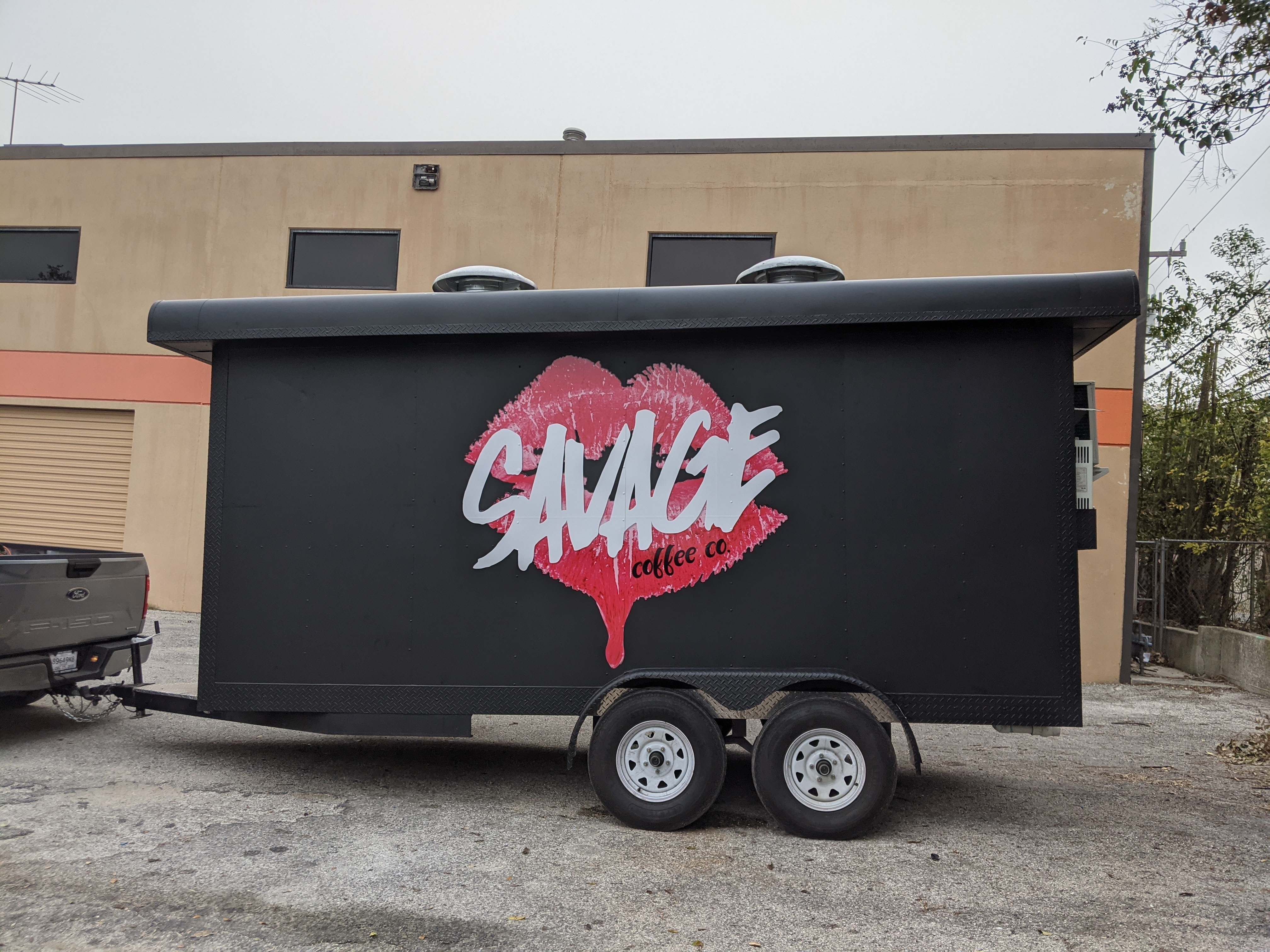

Here is a 3M 2080 matte black wrap on this trailer. I used Arlon 4500GLX w/ 3270 gloss laminate for the printed logo.
I did this in 2020 and the wrap and graphics are still holding up. Savage trailer.jpg
