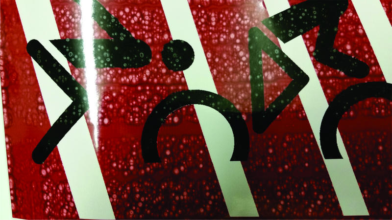

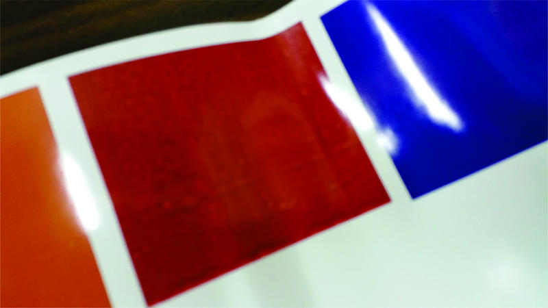

After I have clean the print head many times and then washed them I still get these results. I have even cleaned the flushing box sponge (see attached files) Can anyone figure out what is going on?
Sometimes the spots follow the roller patterns.
J Hill Designs
either laying down too much ink (profile related), wrong media (solvent vs waterbased), or contaminated media
those are my first thoughts.
