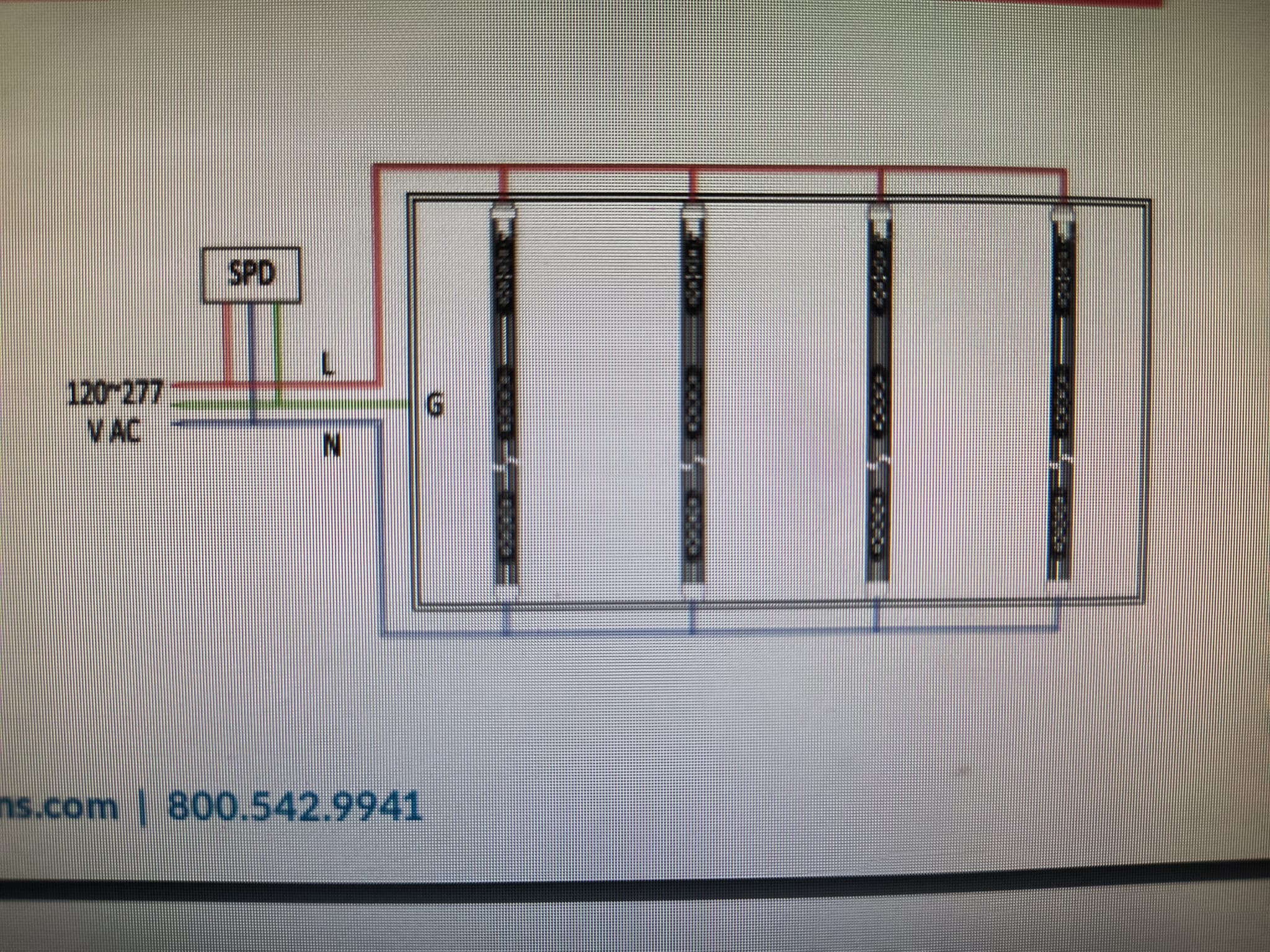

This is the wiring diagram for the LED surge protector from Grimco's website. Someone tell me how that wiring this thing in parallel like this is protecting or even doing anything to the circuit?

It's like a pressure relief valve on water, you don't have to plumb it in and out of the blow off. I don't know how it works exactly but it's supposed to absorb or "blow off" current spikes hence the wiring diagram.

It would have to be some property of electronics that I'm not aware of. Way over my head. I watched their YOuTube video and the guy wires it the same.

The surge protector shunts power coming in on "line" to ground when it gets over voltage. There are also resistors. Why worry about it though? Don't you get paid to replace power supplies when it goes bad?

Seriously, to save wire. They aren't truly shown as wired in parallel, they are run off a line/tap connection. In this instance, you could pseudo daisy chain power, and it would be the same. Here I'd run a 12 ga wire(line) the length of the components and connect with scotchloks (tap) off that run.
To be in parallel, they'd all connect at one point, in a giant wire nut.

And I'm an idiot, this isn't going to save the power supply, this will save the modules with capacitors that will keep the modules going at 12v when there is a dip, or shut them off when it runs out of juice and same when it gets a spike. Surely there is a pair of connections for each though, as a surge will still hit the other components before this has a chance to shut them down without being in line, and grimco is too lazy to draw it correctly for a bit of filler info art.
I thought this was asking about the modules/sticks wiring, not the surge protector.

if the voltage between the 2 legs of the device exceeds the protrct threshold, it shorts, dropping the voltage to within the safe range
this is normally done with mov's (metal oxide varistor) or simply a zener diode. anything above the stated voltage makes the device momentarily short (normally destroying the protect but sparing your equipment
if you just exceed the max voltage by just a little, the device continues to protect, however, it often self destructs, so protection can be a one time event & the device needs to be replaced

I am not entirely sure what gremlin lives in the SPD box, but with all 3 wires, the protector gremlin can dump voltage to neutral or even ground, if need be, to cover a spike in voltage --- think like the voltage regulator on al older car, it was attached to the firewall so it could dump extra voltage to the chassis and keep line voltage steady.
