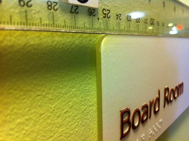

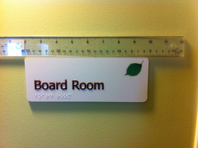

I have a customer who wants some braille ADA signs made.(this is Canada so US rules probably don't apply) I have only seen the attached photos of these things. They look vac formed to me.. then stuck on a piece of acrylic. I can vac form. I can also cut acrylic with my laser. I assume it will cut 1/16th braille dot holes but have not tried it yet.
Most of the signs they want arr 2 or 3 each of a type but some they need 12 each. 70 signs in total are required. I'm interested in the potential of making/selling this sort of sign more so than just securing this small order.
Am I way off on how these are made? The raised lettering would be a pain to make for such a small number of signs unless these things sell for fairly good money. Can anyone give me some advice on what these things sell for and how they were made?

There are a few ways to make them. The two I know of are using an engraver/router or photopolymer. Youtube/Google search will show many videos on how they're made.
they look like the were printed. UV printer with layers to build up. I have several customers that can do this desktop UV printers. I have done it on my Demo Mutoh 426UF
From the picture, this UV printer are more like it, if you look Closer. The letters are "Rounder" or "Domed" shape, versus Photopolymer, which is flat at the top surface of the letters, but with beveled edges.
TXFB.INS
those are done with a UV flatbed printer, the domed/rounded lettering and the color gap at the base of the letters.
