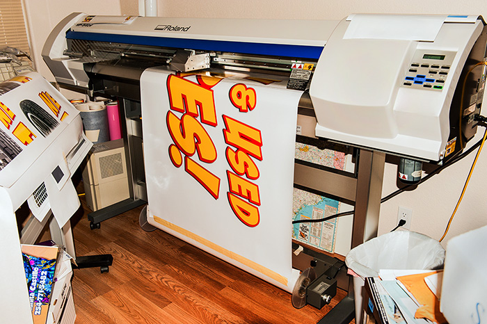

I have a SP-540V with after market take-up system purchased off ebay and installed it on the lower cross bar to give the ink a little bit more time to dry before being rolled on the take-up spool, and I have never had any problems without using any aux heater.
:smile:
