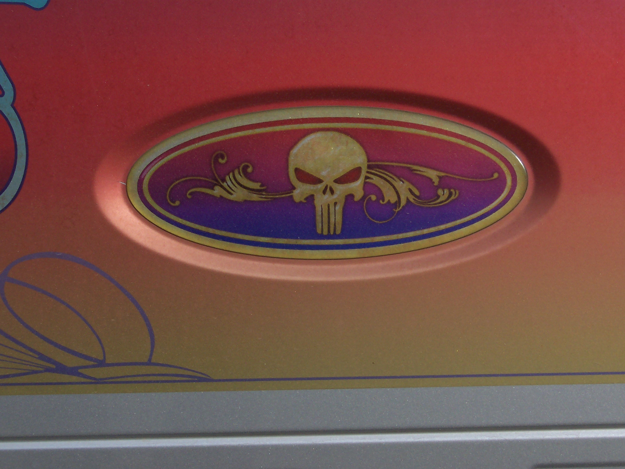

Or remove the Ford badge, make a new one and dome it. That's what I did on the tailgate of my F250. The dome treatment doesn't attain the same height as the Ford badge but nothing to compare who's going to know?
