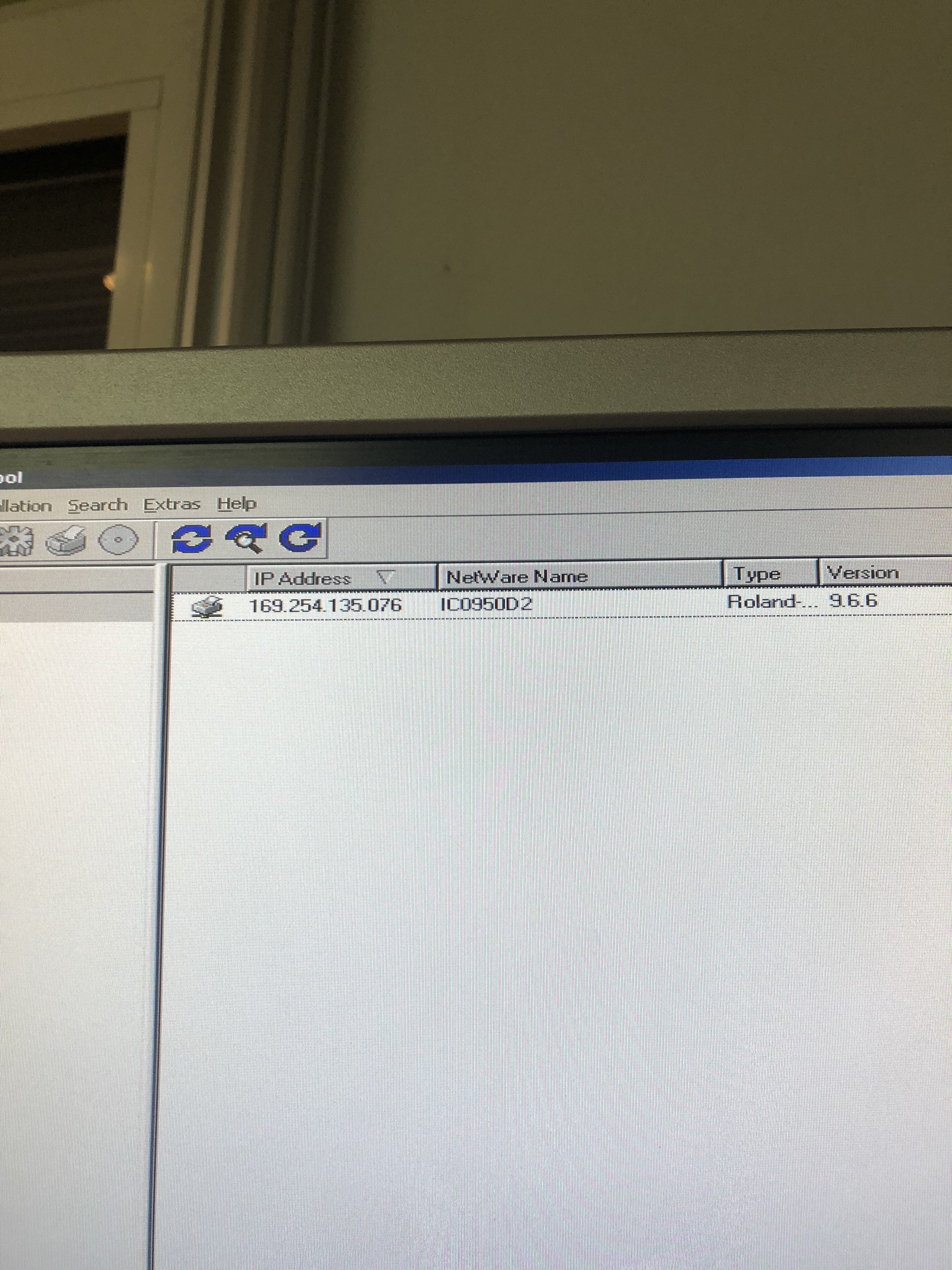

I have a Roland SP540V that has been working fine with a windows XP computer. When I start the VersaWorks it asks me to insert the IP address. I have been reading your converations here but still cannot do it.

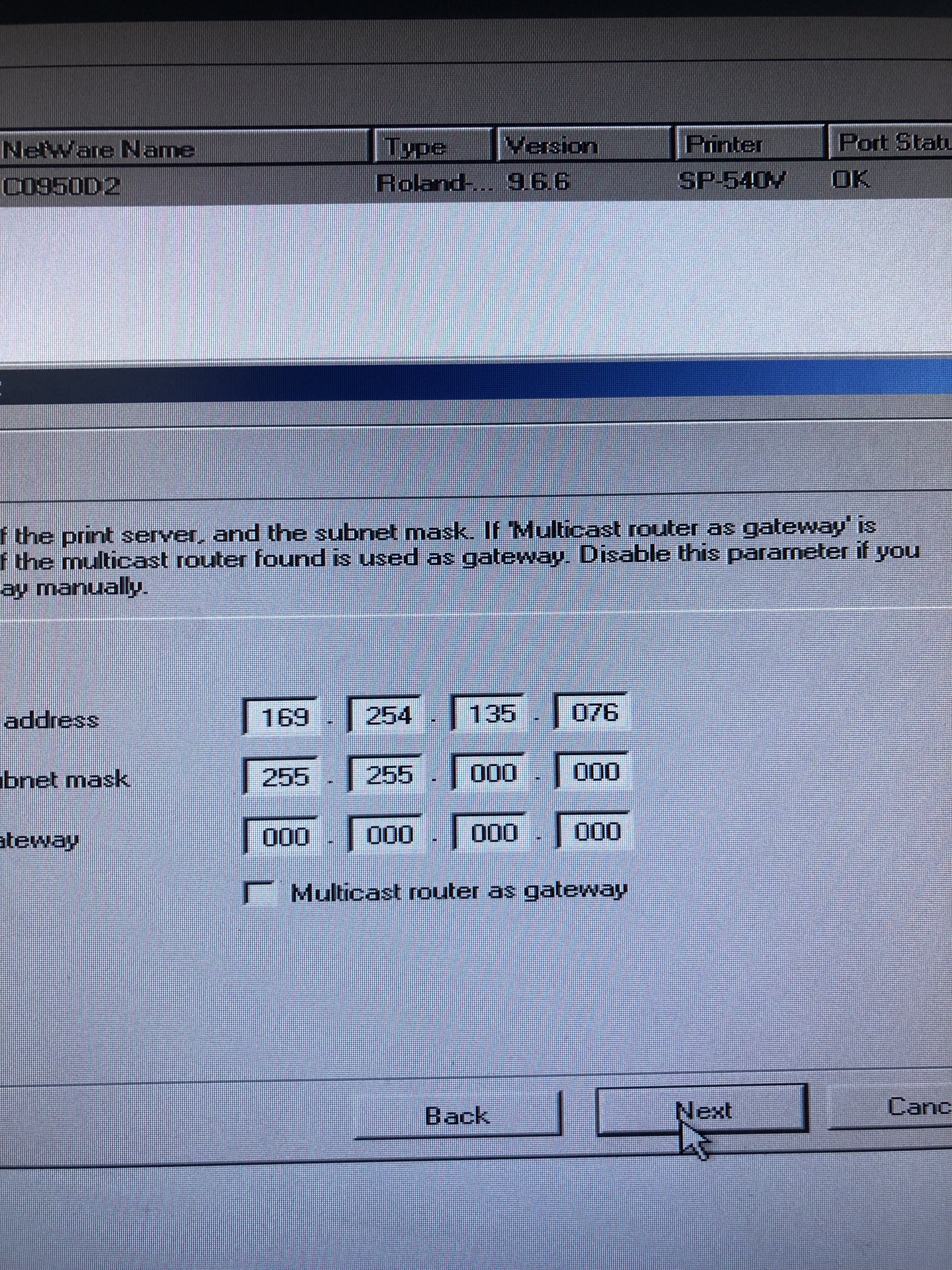

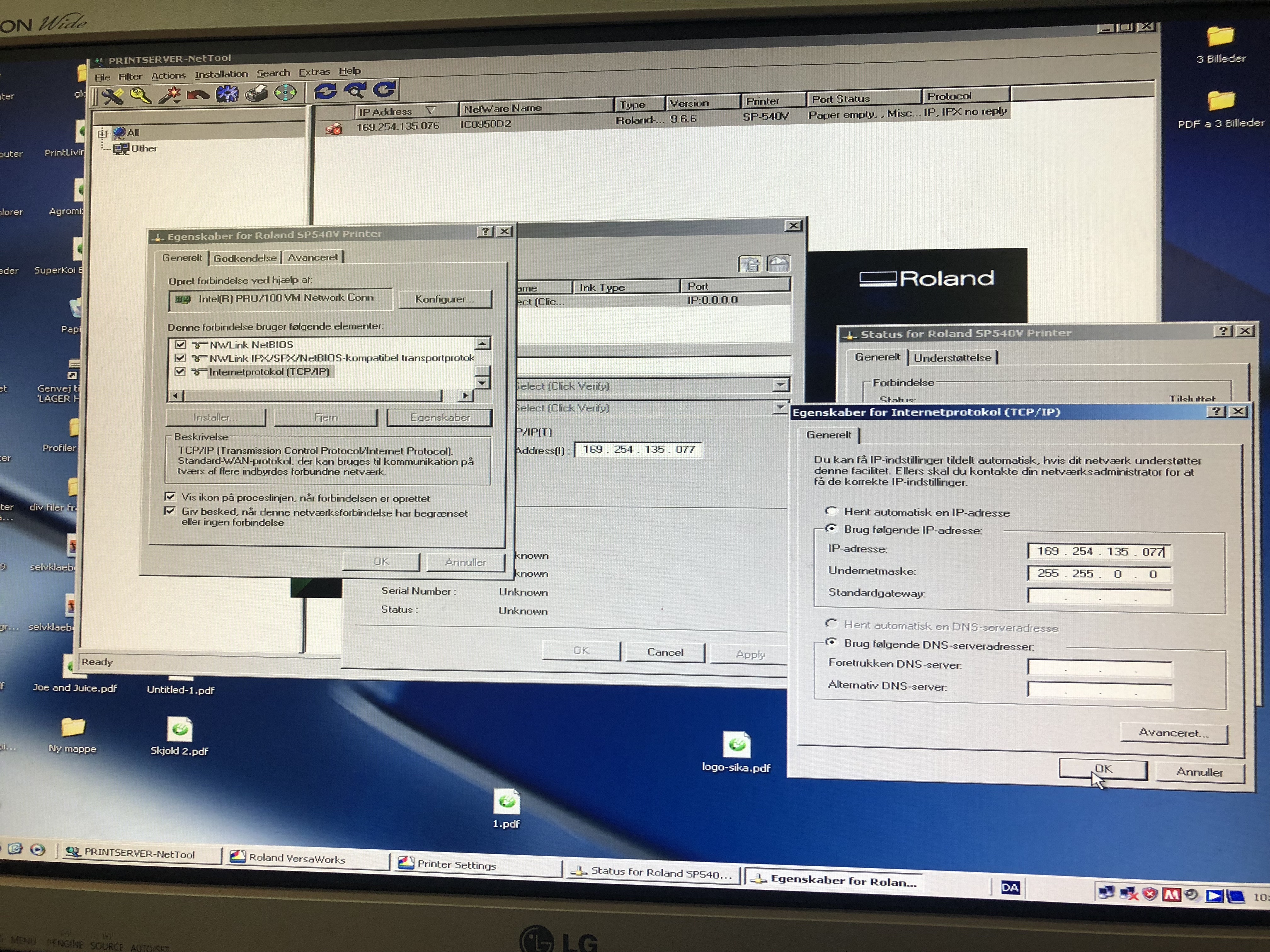

I set the IP to 169.254.135.077, Mask: 255.255.0.0 all good so far
I Open the Printserver tool and hardly obtain the ip address of the printer 169.254.135.076

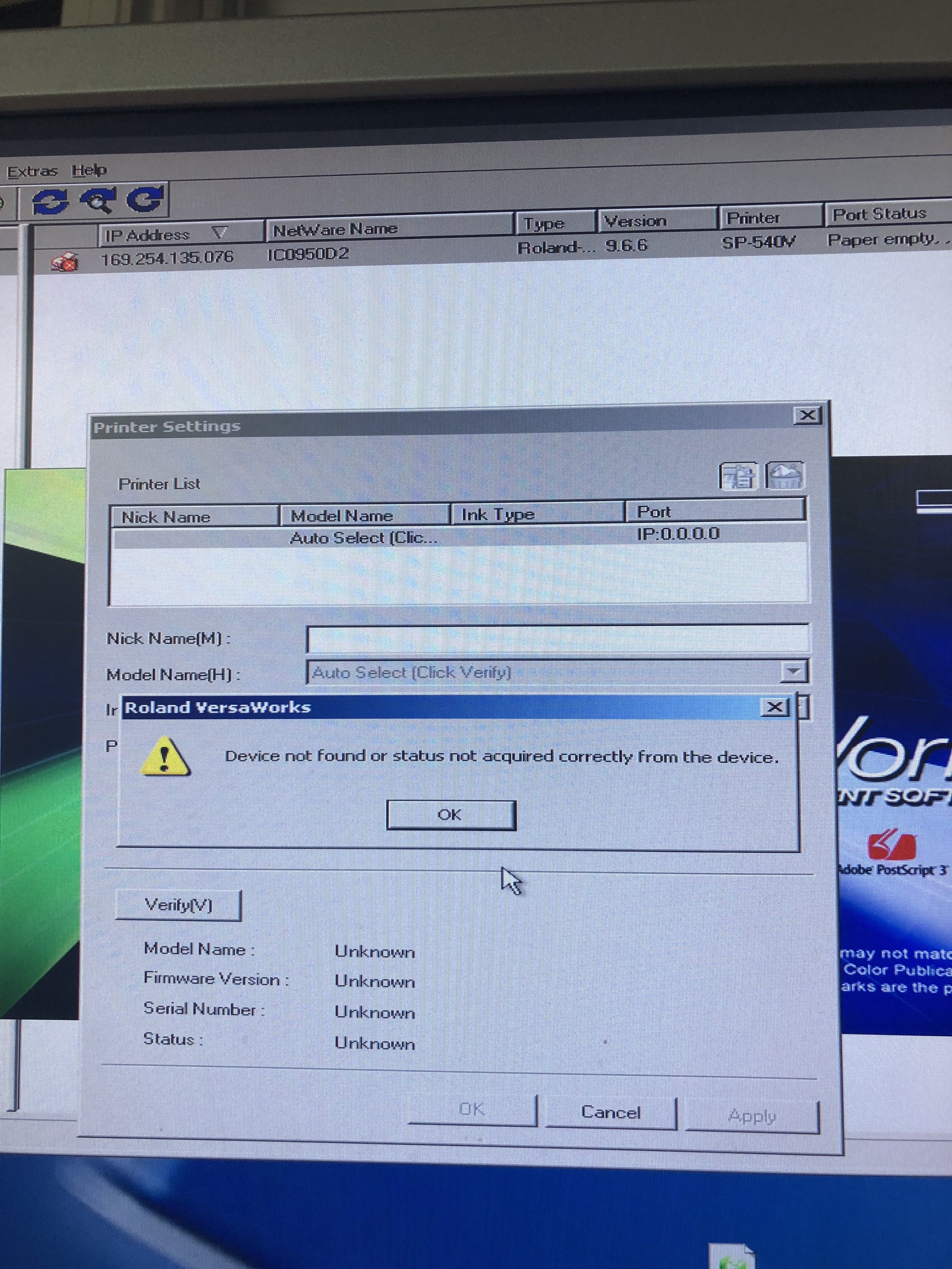

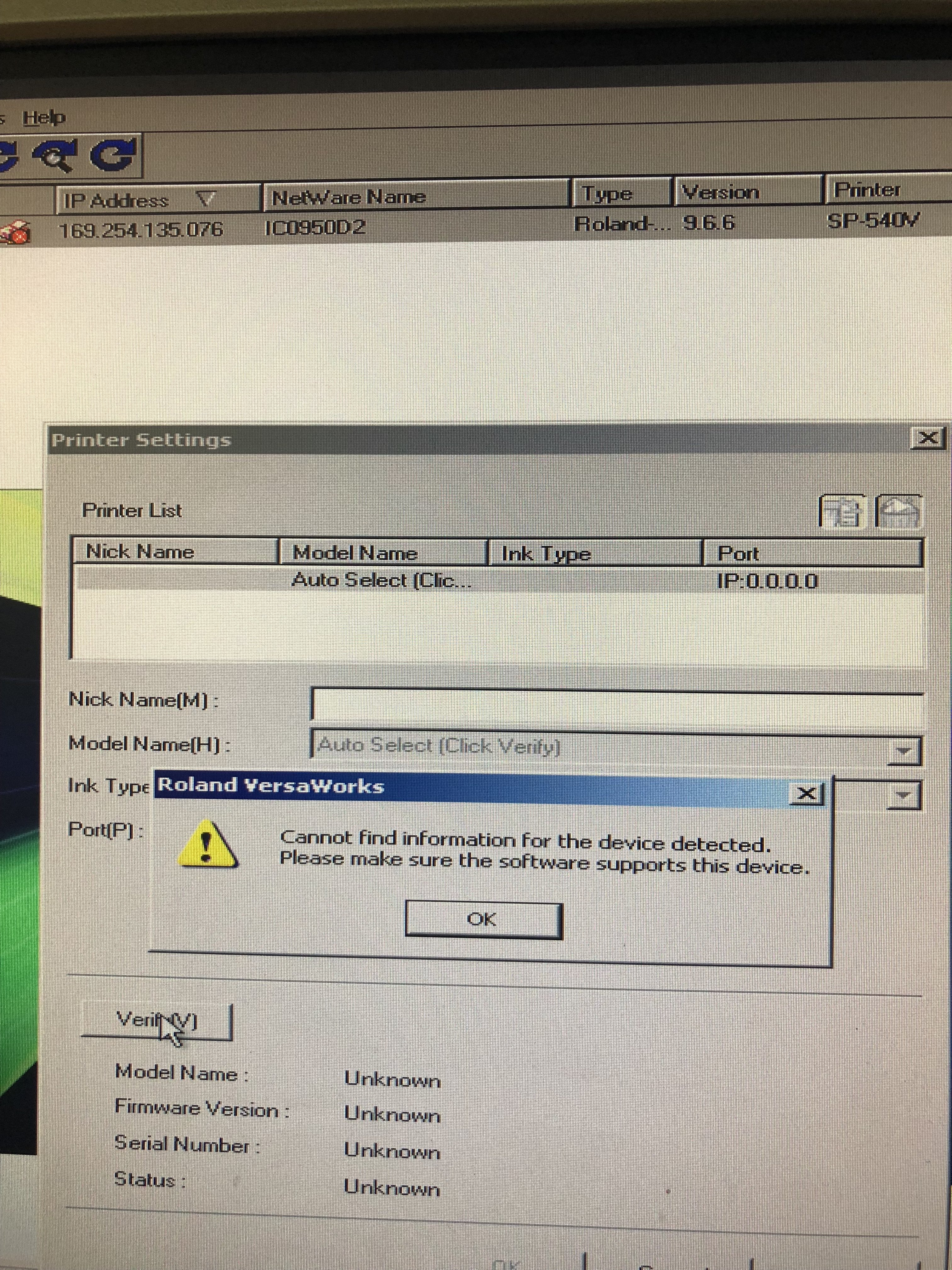

When I open the VersaWorks and prompts to put in the IP ad
dress no matter what I put in (either of the one above) it say "Device not found or status not acquired correctly from the Device".
What am I doing wrong?

I think this would be a Class C IP address, see below:
IP address classes
Class 1st Octet Decimal Range Default Subnet Mask
A 1 – 126* 255.0.0.0
B 128 – 191 255.255.0.0
C 192 – 223 255.255.255.0
D 224 – 239 Reserved for Multicasting
Maybe try changing the subnet mask to 255.255.255.0

I had a tech friend that helped me when I was having troubles. I dont know the exact details but I know that I had a Dynamic IP that kept changing. We switched it to a Static IP and I have not had problems since.
*knock on wood.
What I have done in the past is to use a private network with a router to set up a connection with only the printer and my print computer. This was when I did not have time to deal with issues and just used this as a temp fix to get the job done.
