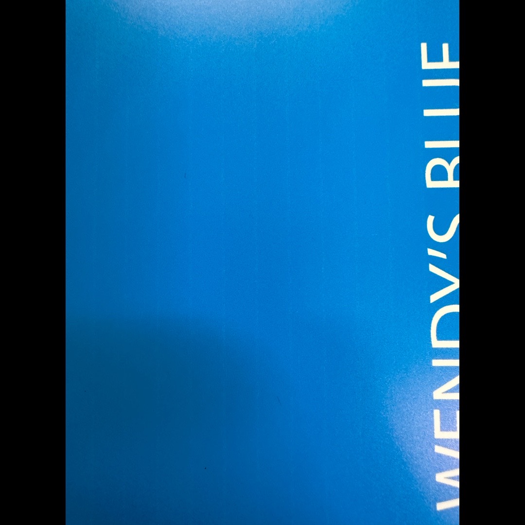

So here are some pictures of the banding. I use canon Ink IJC357. When I run on production the banding spreads apart and actually looks a little better. For some reason this picture makes the banding issue to be not so bad. It looks worse in person.

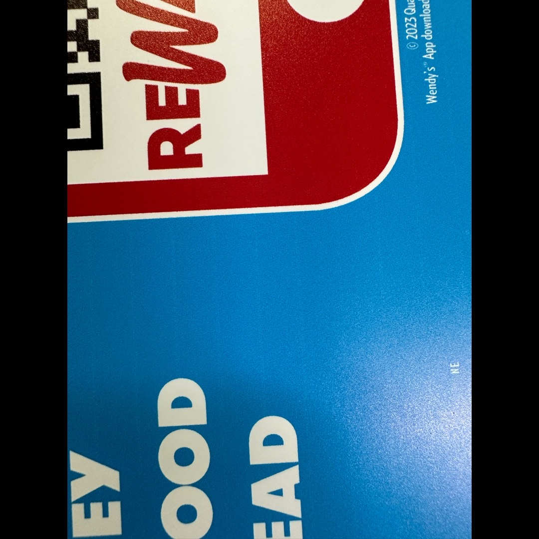

Production.

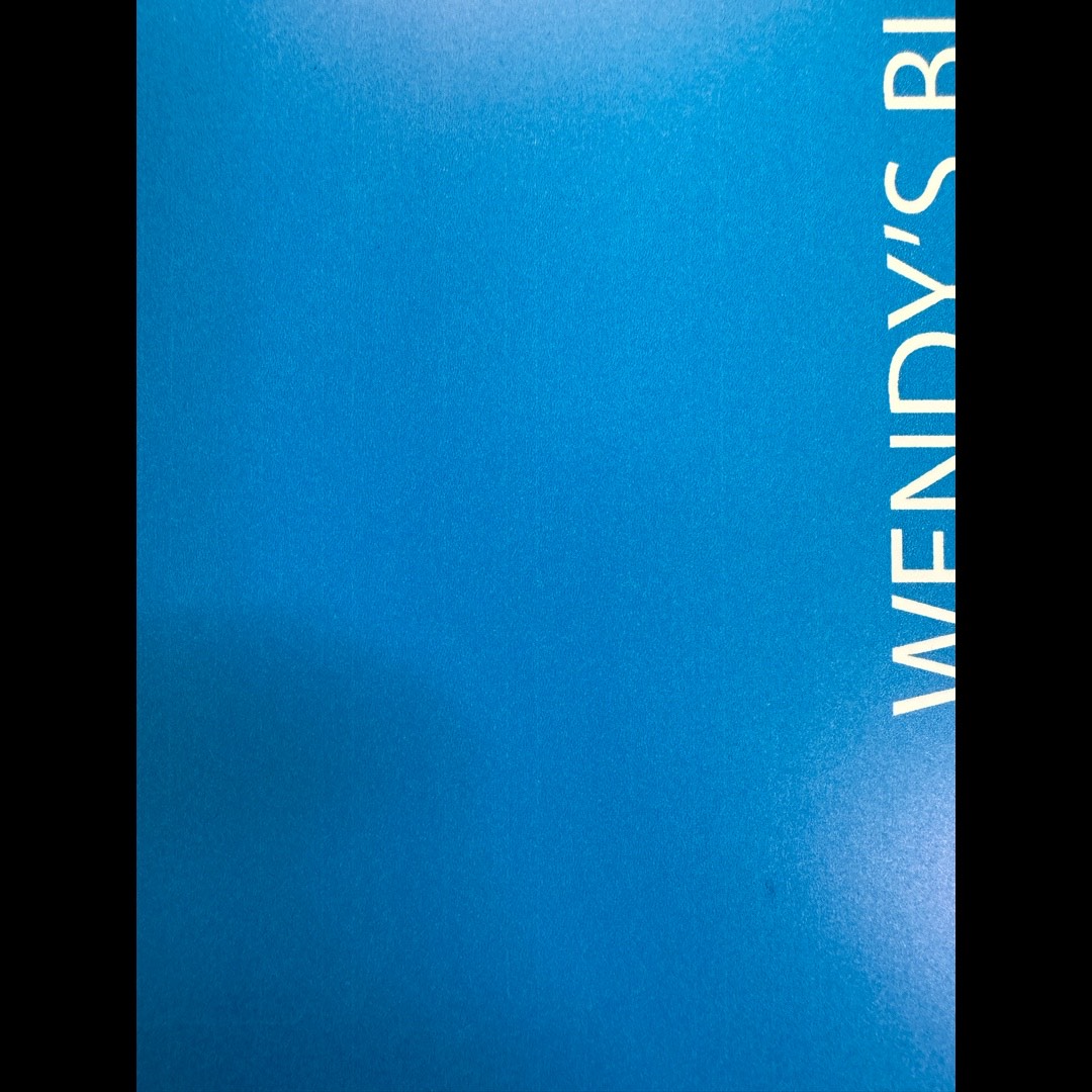

This is the actual cyan color that we're trying to print. This is Quality.
This is the same sample as the top picture but in Quality instead of Production.
ToTo
Professional Support
For sure u have nozzle out on cyan.
And an issue with surface tension or statics.
Wipe surface with IPA and switch ionizer on.
What kind of substrate?
Depending on color you should try to print unidirectional cause magenta on cyan has a different result then cyan on magenta.

Thanks ToTo, to get the job done I actually ran it in matte, that took care of the banding but took a lot longer to run. You are right there is one small line thats out on the cyan head but its only on one so the tech said its still too good to replace it with a new head. It was like that way when we bought it and its been 2 years and hasnt gotten any worse. The tech gave us a new ink head for it thats still sitting here waiting to go in once we need one. Ill try those other things you mentioned though next time I have an issue like this. FYI, the substrate was .040 styrene.
