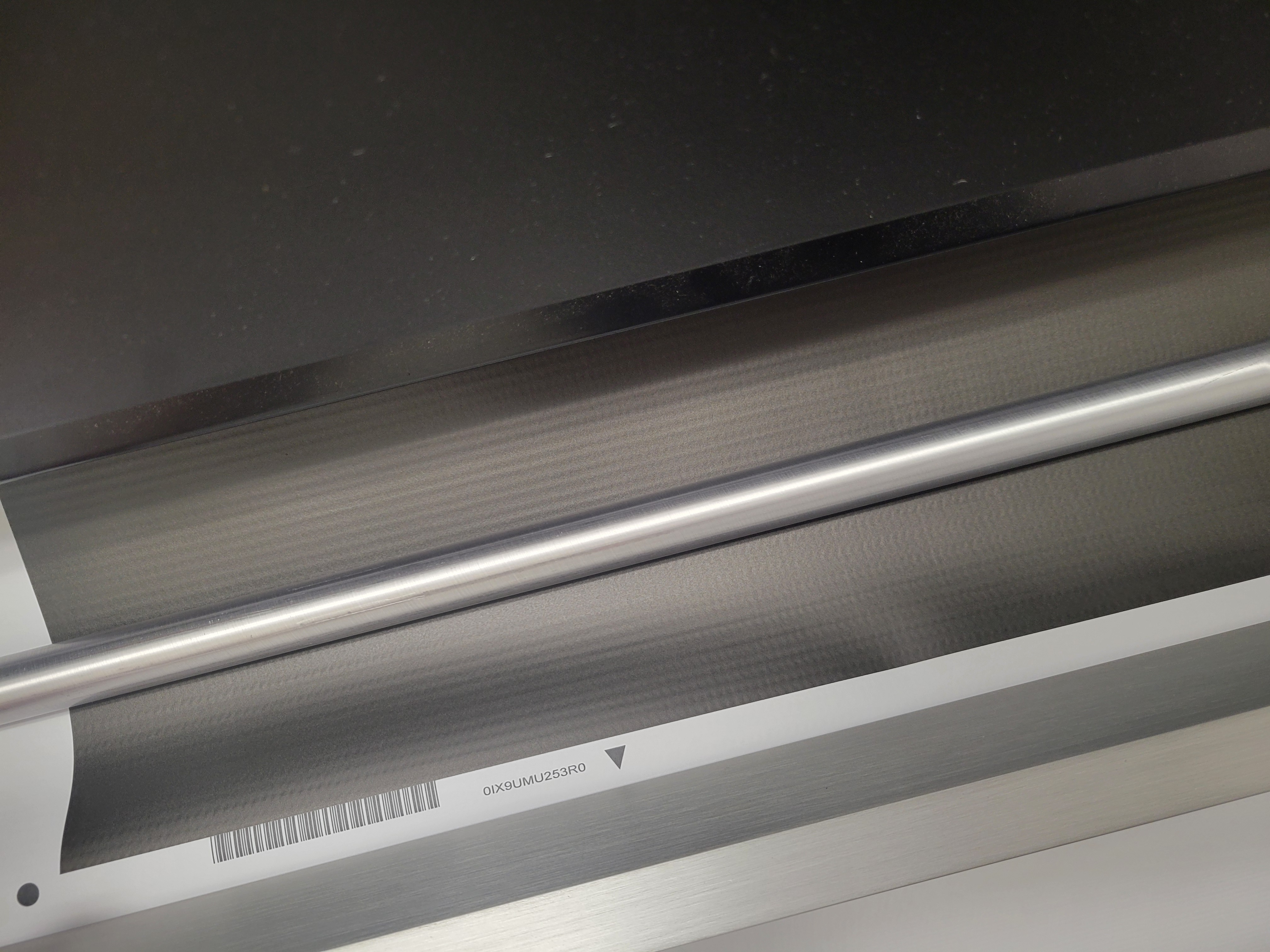

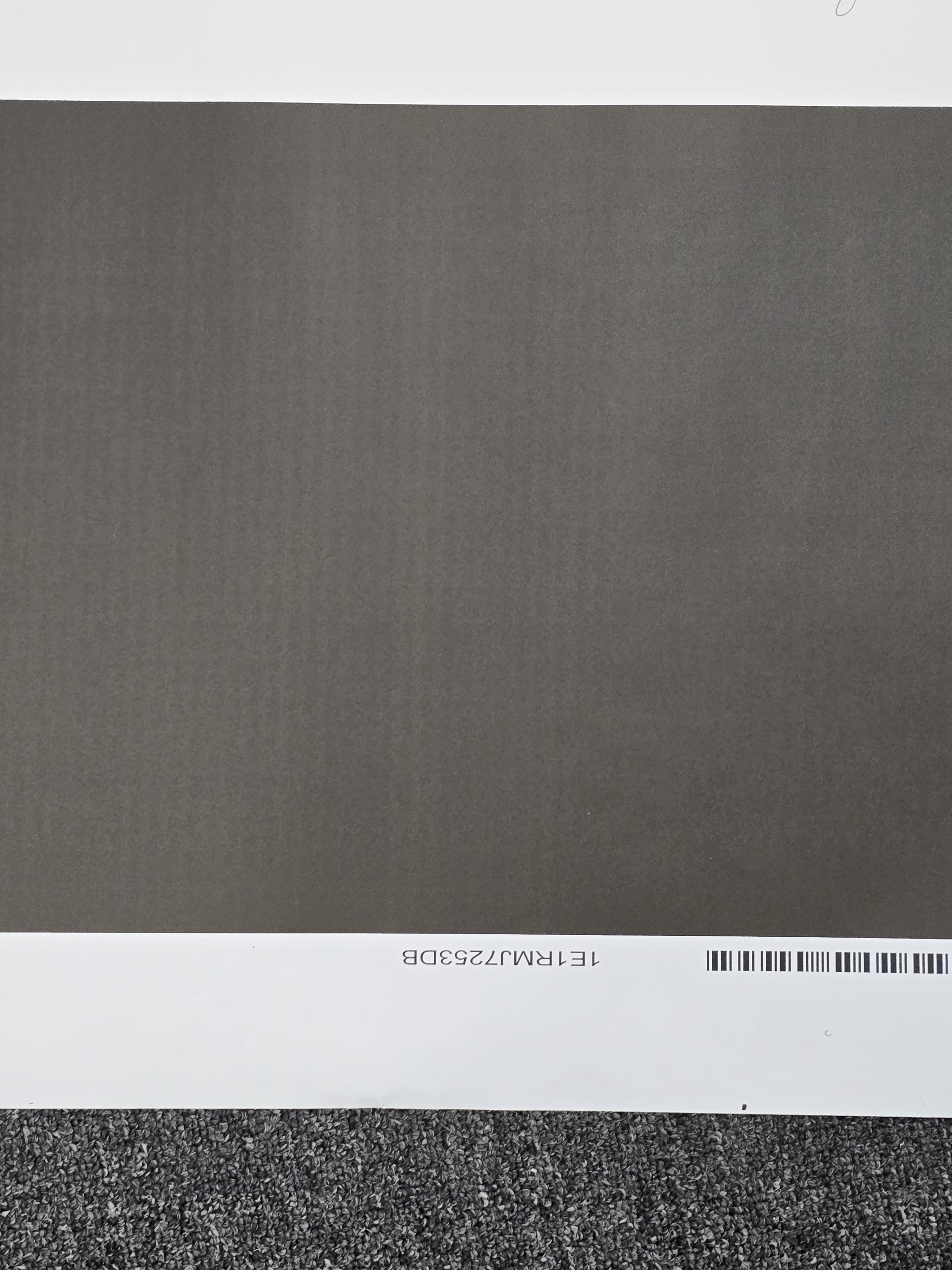

Wondering if anyone else has dealt with Canon and come up with a solution for this problem.
Essentially we're getting vertical banding on almost all coated or uncoated medias, and it becomes more apparently on heavy dark colors. Lighter colors you don't really notice.
We've tried so many different things
- Crank up vacuum, lower vacuum - no change.
- Tried 5 or 6 different media types - no change
- Tried various quality settings - no change.
We have been in touch with our local dealer who told us they have seen this problem but only when customers are printing on a coated 1105 media . They said it was related to the wheels going through the media and sort of "denting" the coating. But we've switched to a mixture of 3 other uncoated medias and still getting the problem. I have ordered a set of replacement wheels from Canon which are apparently a month away in order to test, but I have my doubts. The banding we're seeing is very right - 3/15 - 1/4" apart the entire way through the print zone where the wheels are spaced much much further apart. So I can't see it being the wheels.
Has anyone else dealt with this issue before with Canon directly or a dealer? We want to bring printing vehicle wraps on our Canon, but where we hit big large dark color swaps I can tell will be an issue.

victor bogdanov
Do you only see that in matte mode?
Have you tried different "strategies"
What material is that in the picture? I've seen stuff like on on certain materials and I think it has something to do with the material surface
victor bogdanov
Run the material though the printer the other way, rotated 90 degrees to see if the pattern direction changes to rule out material. You can splice in a rotated section of material onto the roll to test

In this particular case we've done 99% of our testing in matte mode, as this job is for a customer who requires a matte finish for wall wraps etc. But I believe when we were testing this on 1105 we ran it in gloss mode. But that was several months ago, I'll run a test again to see if I can see the problem in gloss mode. If by chance its only apparent in matte mode, what would that indicate the issue is?
For the material, being the issue, do you think its something to do with all the various medias showing that banding in their construction process? Your thinking here if we rotate 90 degrees that it would indicate its 100% its a media issue ?
thetsp
So we ran a test and it is much harder to see in gloss mode. Just due to the glare and the fact the color appears much darker in gloss mode the vertical banding is less apparent.
Although when it was coming off the printer it did look to be a bit more obvious. But after curing and looking at it in comparison I'm finding it a lot harder to see. What would that typically indicate?
Grizzly
It’s all about your print!
I have a 1650 and an M and haven't see vertical banding like this that wasn't related to material, but considering you've tried that many medias definitely the printer.
If it's happening more apparent on matte mode, it probably has something to with the encoder or the machine isn't level.
I've seen this more on my flatbeds especially with gray tones and was told it was do to vibrations in the machine.
Throwing it out there cause I'm not sure what else to tell you, but have you changed the lubricator pads recently?
Does changing the speed adjust the location of the lines?
Happy to run a test on my 1650 if you want to send me a file.

victor bogdanov
IF you could print this file that would be awesome in at least showing canon its not the media. In terms of vertical banding its more a gradiented banding as opposed to a hard banding that you would see on horizontal banding. So in terms of seeing that dark light, woudl that not indicate something with surface not being perfectly even going through the print zone (so something to do with vacuum or like you said the media?)
I just printed this file on banner I had loaded and its printing perfect, this was matte speed. Have you tried printing in faster modes is the problem still there in matte speed or matte quality?
I don't have any other suggestions, I've only see the problem you have due to materials

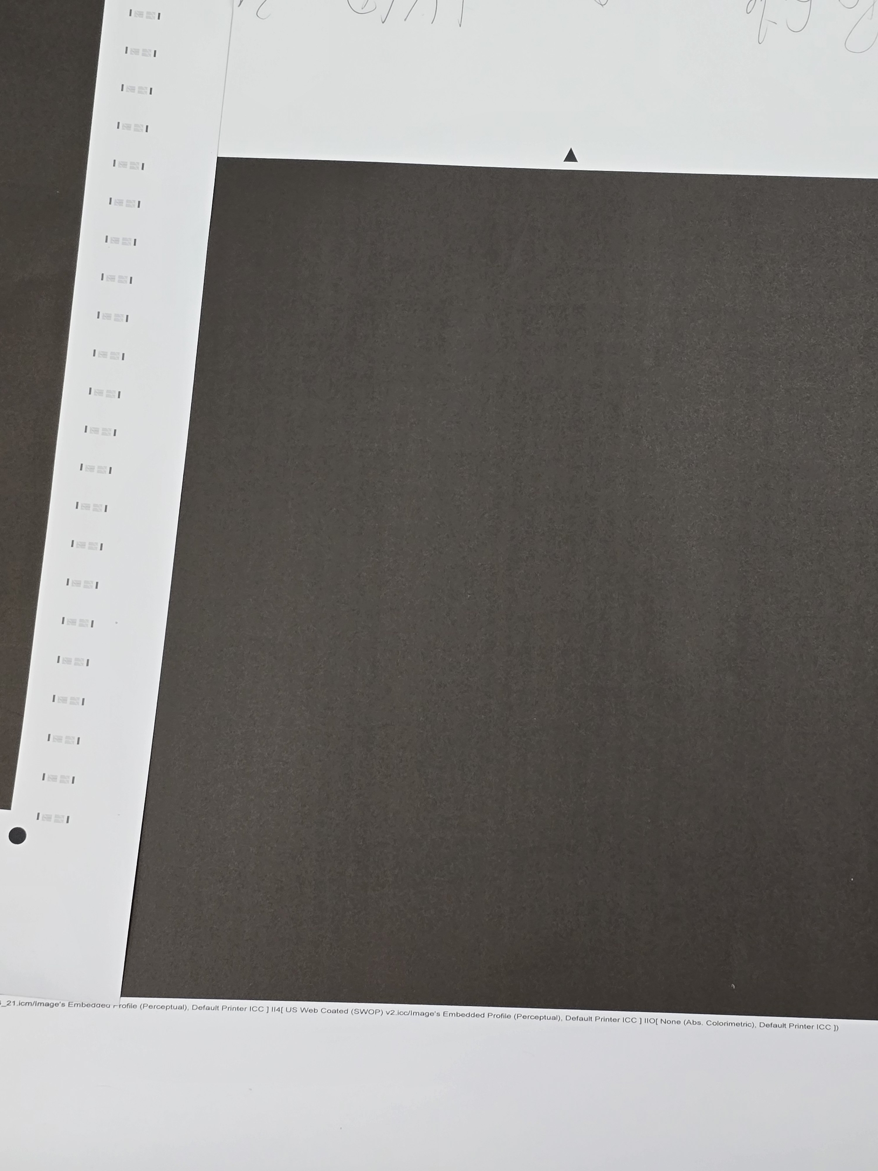

I know its been a while, but curious if anyone else might have an answer here. We've been running this printer for a long time and we print a lot of differnet medidas and big volume. This issue is prevalent on anything that I print in matte mode, its just some colors really show it and others you can't really pick up on it (but if you look very very very closely you can see it).
In gloss mode it prints absolutely flawless across every single media, no issues at all.
But no matter what media I print on , in matte mode you will see this to a degree.
We've played with nearly every single profile setting, swinging them widely each way in some cases to see if we could get a shift or eliminate it, but to no avail.
My gut tells me this has to be a mechanical defect or problem with the shutter and the way it cures the ink in matte mode.Does anyone have a contact at Canon that could help us with this? I've tried to solve the provlem through our local supplier / rep who sold us the printer (who apparently escilates it to someone in Canon Canada). but we've never received any answers, nothing to try or solve and just been sort of told "thats the way it is". No one will even come here to actually look at the printer.
I've attached a picture of the issue in 100% cyan, which is actually probably the worst color.
