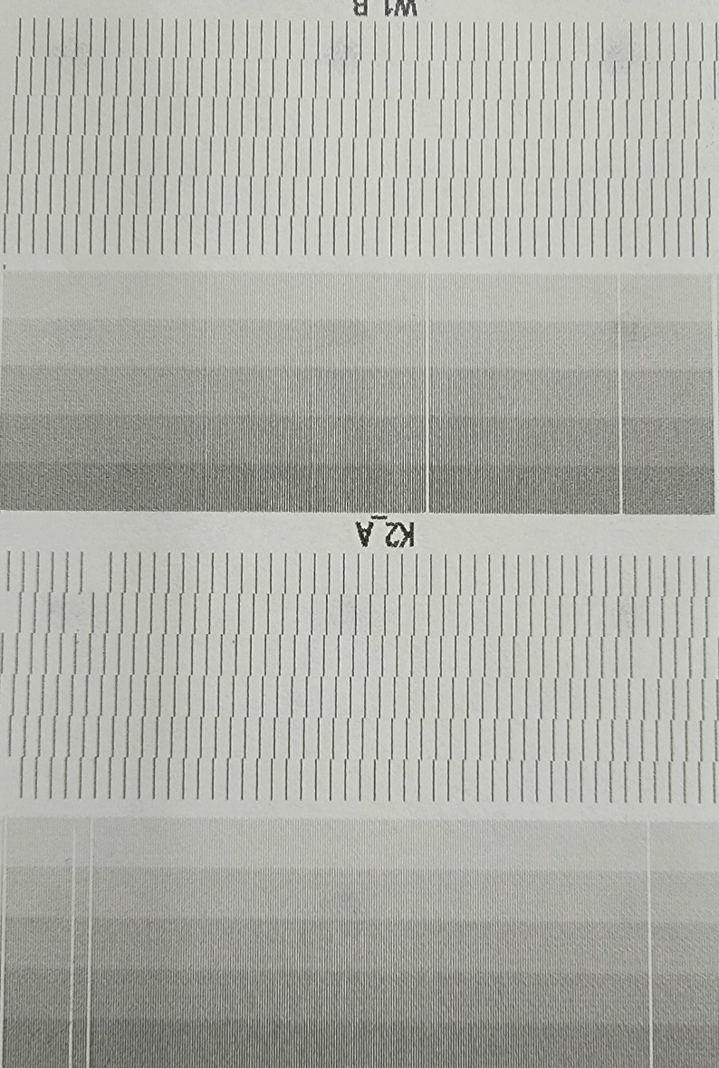

I can't for the life of me get the black printhead nozzle's clean. I've always had an issue with at least one but now it a few.
I have tried to soak it by placing a swob and holding it under with the flush, and isopropyl alcohol and vacuumed the heck out of it with no progress!
I would like to take it out and soak it but there's no instructions on how to? Surely don't want to pay a tech $500.00 to come do it.
Any help would be much apricated!
Thx!!

sometime nozzles are missing not because they’re clogged but because they are electrically dead and make sure when you soak your printhead your ink temperature is cold if not you can cause more damage.
Pauly
Printrade.com.au
They look pretty warn out to me.
The middle looks very scratchy compared to the outside
