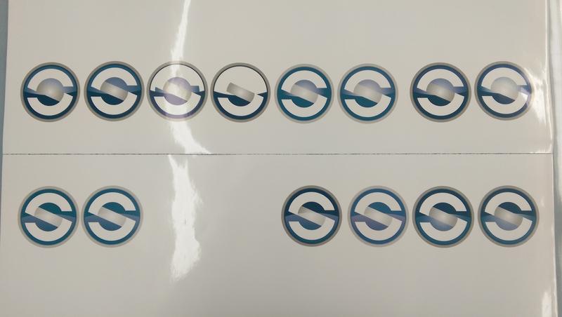

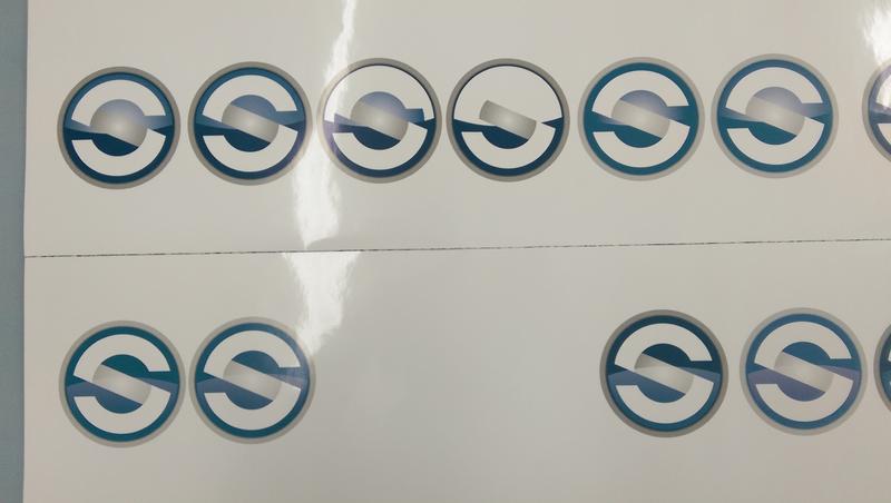

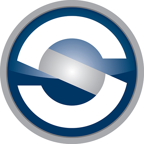

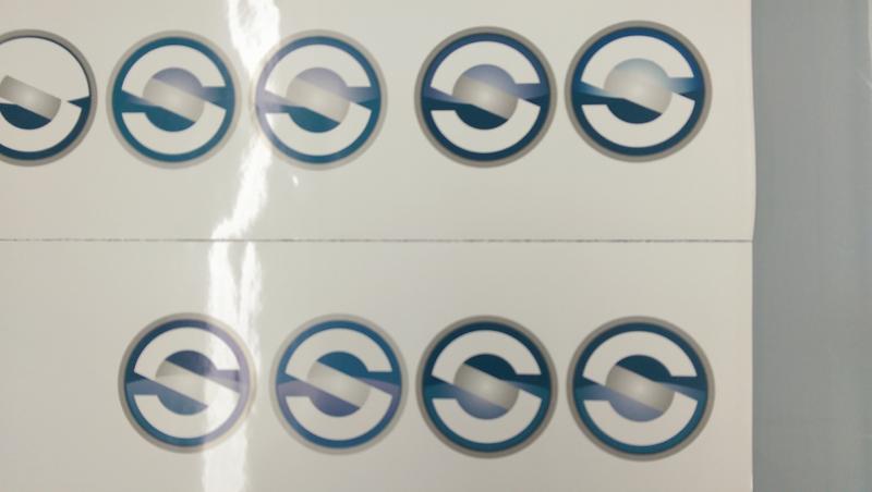

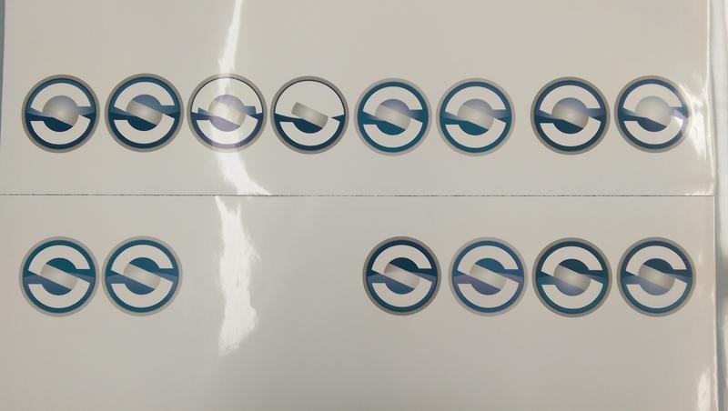

We have been having an issue for quite some time now trying to print our logo out on our Roland VersaWorks 640 printer. We are trying to get the "sunrise" in the image to from white fade into nothing like how it looks on the JPG in Illy, but every time we print it as a pure vector it only fades to some odd green color instead of our dark blue, even when we move the transition point way below the end of the transition.
We have tried printing it as a EPS, PDF, and TIFF (which only turns the entire logo a weird green). We have also tried to make the sunrise transition from white to transparent as well as to fade to the dark blue.
We are printing all in Roland color chart colors so we can see the colors in VersaWorks, and we have tried printing once in pure CMYK.
:banghead:
I understand this may be solved quite easily in Photoshop, but we'd like to keep it vector if we can for quality and re-sizing purposes.
Does anyone know how we can get the "sunrise" to transition to nothing properly? Let me know if you need more info.
