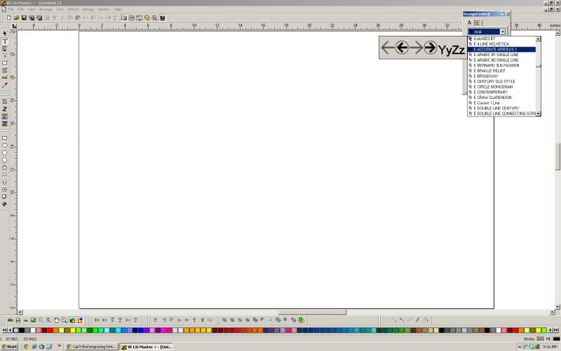

Have old XP PC that we used for years, finally got a new PC with Windows 8.1, copied the fonts folder over from the XP computer, everything installed great. On the old PC there are engraving fonts that I installed, can't remember from where. I cannot for the life of me find them on the HDD of the XP machine to move over. In Flexi they have a different icon next to the font name. The icon is FF. Searched HDD for the font name, or anything close to it and nothing ever returns on the search.
Any clues??

Yeah done that to no avail, only 3 types of files in that folder. None of them are the golden engraving fonts. :(

There is a /Fonts folder under /Program/Modules in the flexi (lxi) folder but there's nothing in there but .dll files.
bross666
[h=2]I went to Flexi and picked one of those FF fonts, and then did a search for it, and nothing showed up, just like for you. Then I did a search for just font, and then went thru every folder until until I found it. The one I picked was "E Almond 1" it was located in, C:\Program Files\SAi\SAi Production Suite\FSFonts. Hope this helps[/h]
